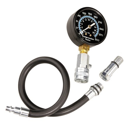

  21. Man some pics of this will help a lot-
    What kind of compression tester are you using ?
    Mine as a oring fitting that seals on the same plug sealing surface. Off of this fitting is a hose with a male air hose fitting. To the male air hose fitting you attach the gauge which has a regular female air fitting or to the male fitting an air hose.
    If you have ZERO compression in a cylinder a leak down test won't help you. You do a leak down test to determine (gets tricky here so be careful) the amount of leak down. With no cylinder pressure being built there's no leak down. This test will show you a rate and percentage of pressure lost over time. You loose zero pressure in zero seconds of the zero pressure you built.
    I may not be understanding your post, if that's the case please forgive me...
    Earlier 3,5,7 have zero compression, retest shows zero. You then backed off the rockers and now have no air escaping? You need to hear it but how can you hear it if there's air ******* out of a rag around an air hose.
    Really can't see how the test is valid
    but and this is a big **** so take this for what it's worth (not much)
    If all you did was loosen the rocker adjustment and now it has no air escaping then what would you say the original problem was?

  25. Shaner's74
    Joined: Dec 19, 2011
    Posts: 76
    Shaner's74
    I was going to use the leak down tester to add air to the cylinders in a controlled (sealed) manner to see what happens. If the pressure holds the valves were most likely not adjusted right hanging open letting compression out. I can also check the coolent for bubbles and the crankcase again.

  28. Shaner's74
    Posts: 76
    Shaner's74
    My plan was to use the fittings to add air to the cylinder to see where it goes. The valves are closed so if air comes out of the exhaust or intake there is a valve hanging open for any number of reasons. If it comes out the dipstick tube it's rings, hole in piston or cracked block. If air bubbles in the radiator it's a blown head gasket. This isn't likely since there's no coolant in the cylinders or oil.
    Washed out cylinders? I squirted oil in each but was unable to regain compression. I had that happen before on a different engine but it was only one cylinder.
    Three cylinders with valves adjusted wrong all in a row? If that were the case it wouldn't have run before?
    The tester I have is like yours but it doesn't have a fitting to connect to the air hose.
