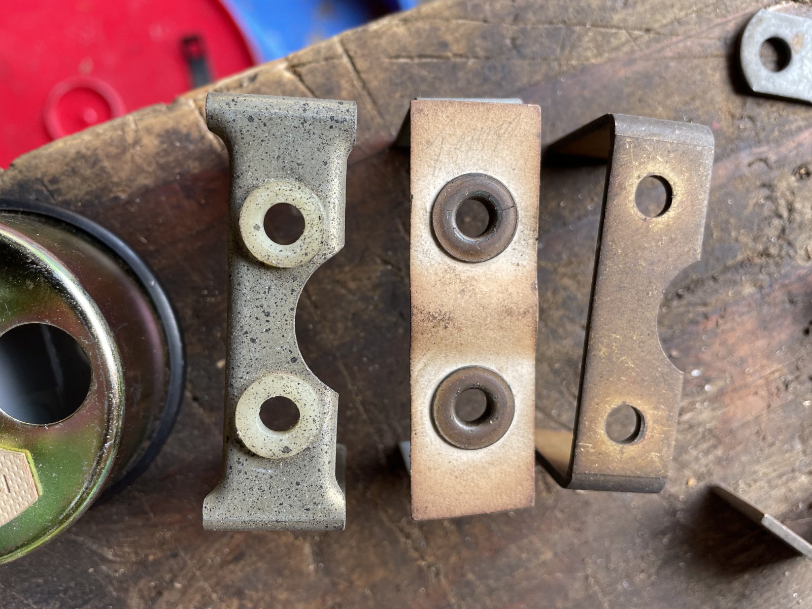

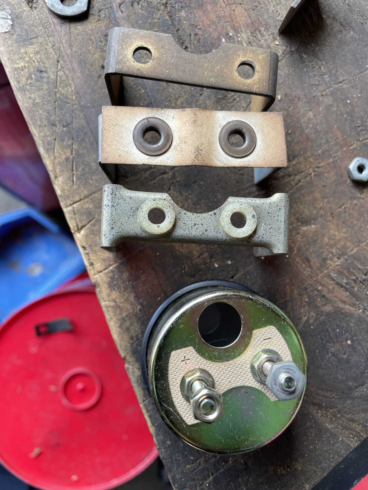

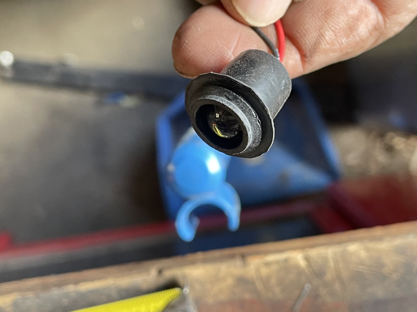

  25. jerryt
    Joined: Apr 26, 2022
    Posts: 94
    jerryt
    hi I’m Jerry. I posted the question about amp gauge. Here is pictures of my gauge. It’s a summit racing 21/16 gauge.
  26. Moriarity
    Joined: Apr 11, 2001
    Posts: 39,144
    Moriarity
    SUPER MODERATOR
    he wanted you to send him a PM
