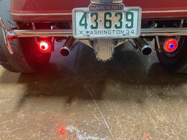

    Over the weekend I had a buddy behind the roadster and he said he could not see my taillights or brake lights in the day time. That is no bueno. I had LED super brites in there but they are "only" 275 lumens. The new ones are 600 lumens. I sourced them on Amazon and got them in 24 hours (I don't know how they do that with free shipping).
    They look stupid but fit my 37 ford housings. It's the funky one on the right, normal 1157 mounting post in back. The one on the left is the super brite LED I removed.
    They make a difference. This is running light comparison, new bulb on the left in the picture. They are sold as motor cycle lights and came with HD replacement lenses. They are wicked bright.
    And brake lights/signals. That hurts even in the picture, you should see them in person. You can get a tan.

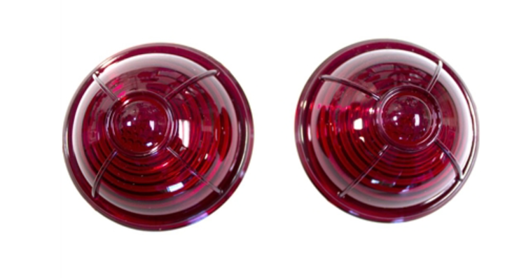

    This is what I want, they are Zephyr style lenses for 37 ford housings. Limeworks is out of stock. I need a pair. Gl***, red, no blue dots. Anyone holding?
    I found some for sale in the UK but their website said they do not ship to the US. Perhaps a UK member will help a guy out? Other suggestions? You know, power of the HAMB kinda thing.

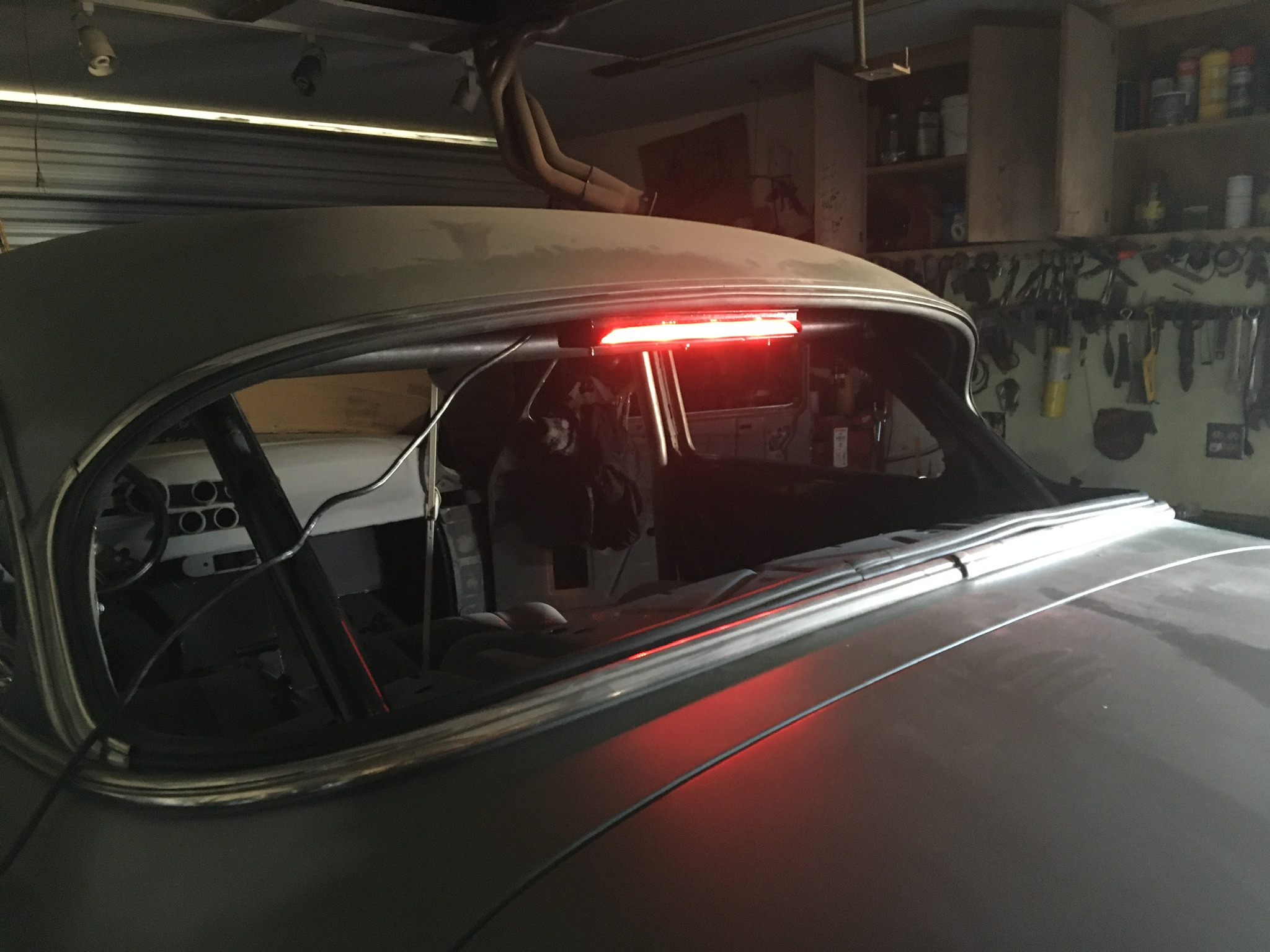

  22. This thread is why I have a 3rd brake light on the 48. Many don't look down to see if there's anything period. :)

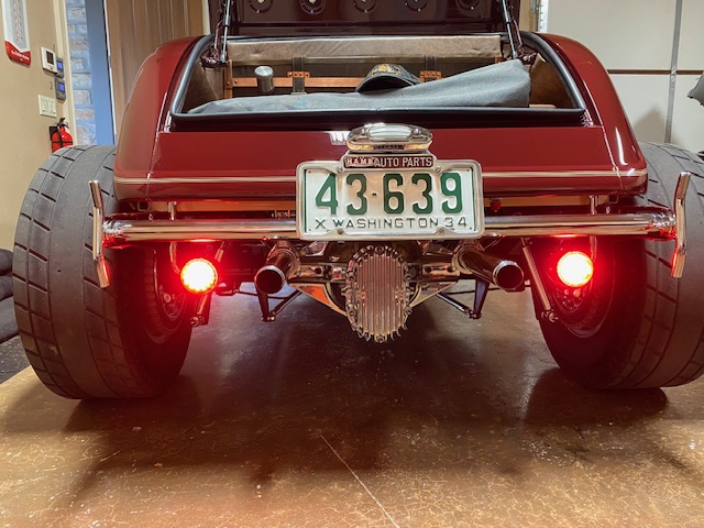

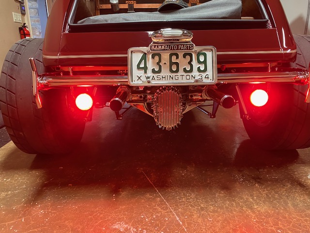

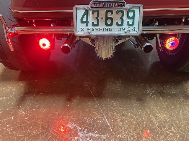

    I found a set of those domed lenses and they do diffuse the LED light pattern from those hideous bulbs. The pictures are hard to make out as the camera has issues with the brightness from the LED's (not a bad thing, that's why I bought them).
    This is running lights;
    This is brakes.
    That is the equivalent of four 1157's and more than double the highest LED bulbs I had found. In person, they hurt my eyes. Need a welding helmet to look directly into them. That is with the garage lights on to simulate daylight conditions. It is raining so I will take outdoor pictures later in the week as the weather improves. Huge improvement and you cannot make out the LED's at all through the lenses. Emergency flashers and turn signals, though not traditional, still work fine with the CANBUS software loaded LED's as advertised.
