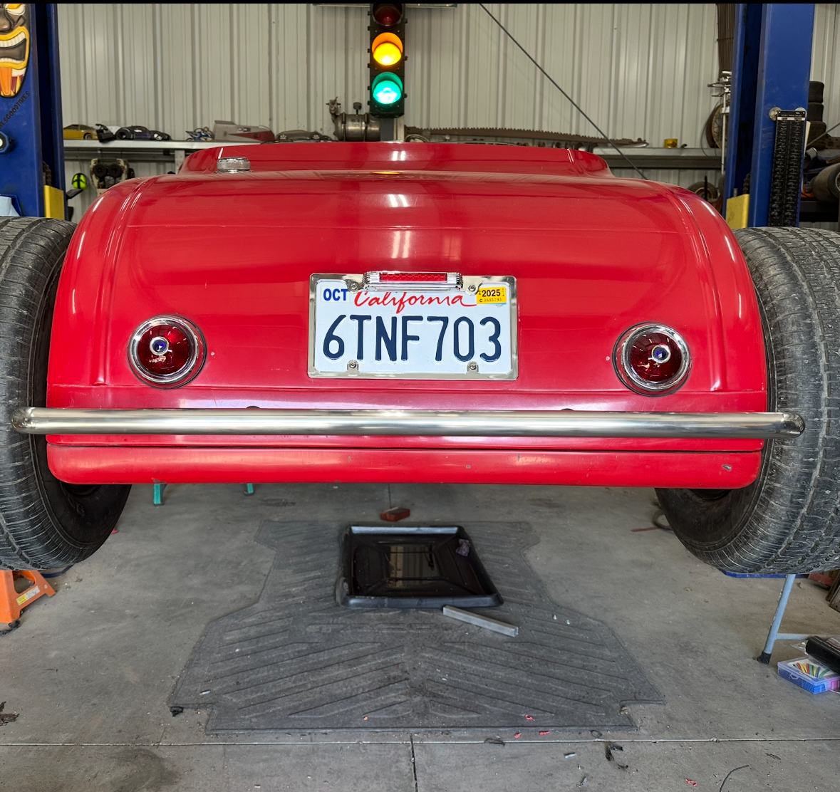

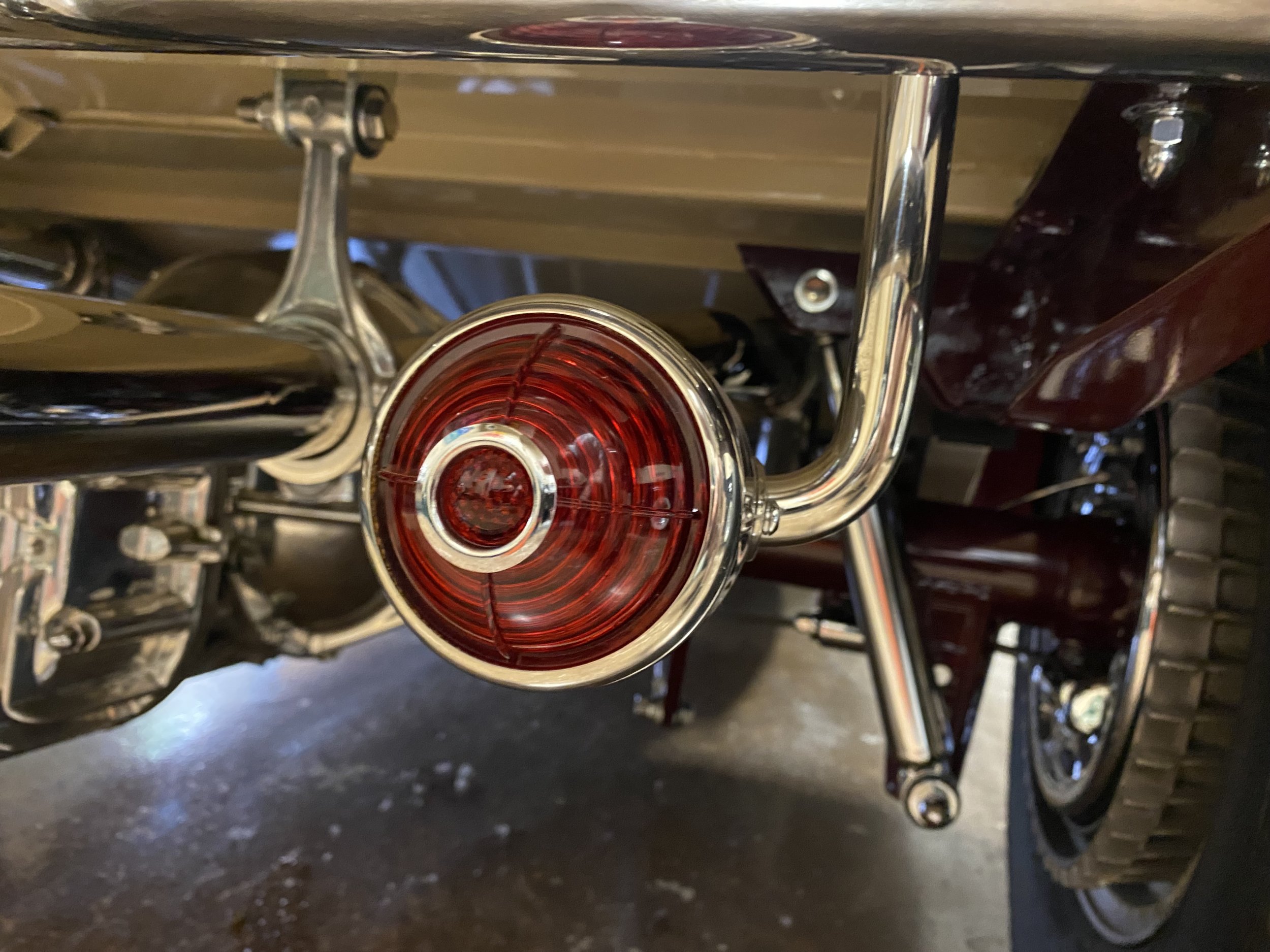

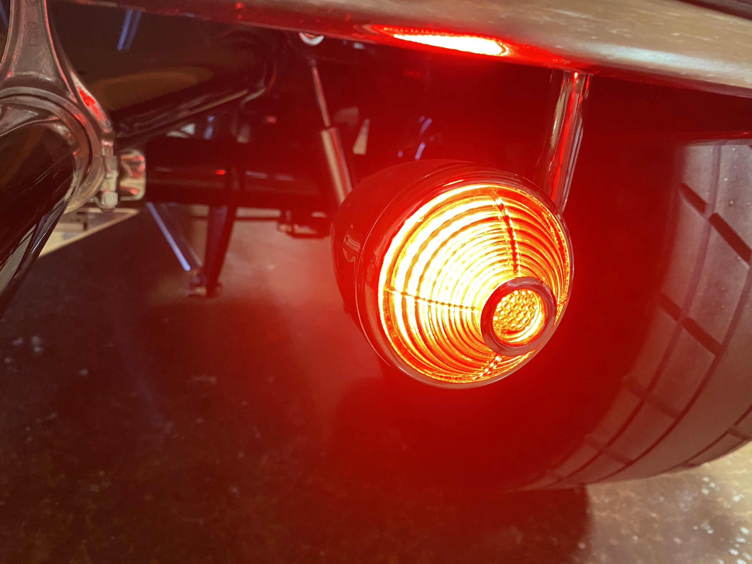

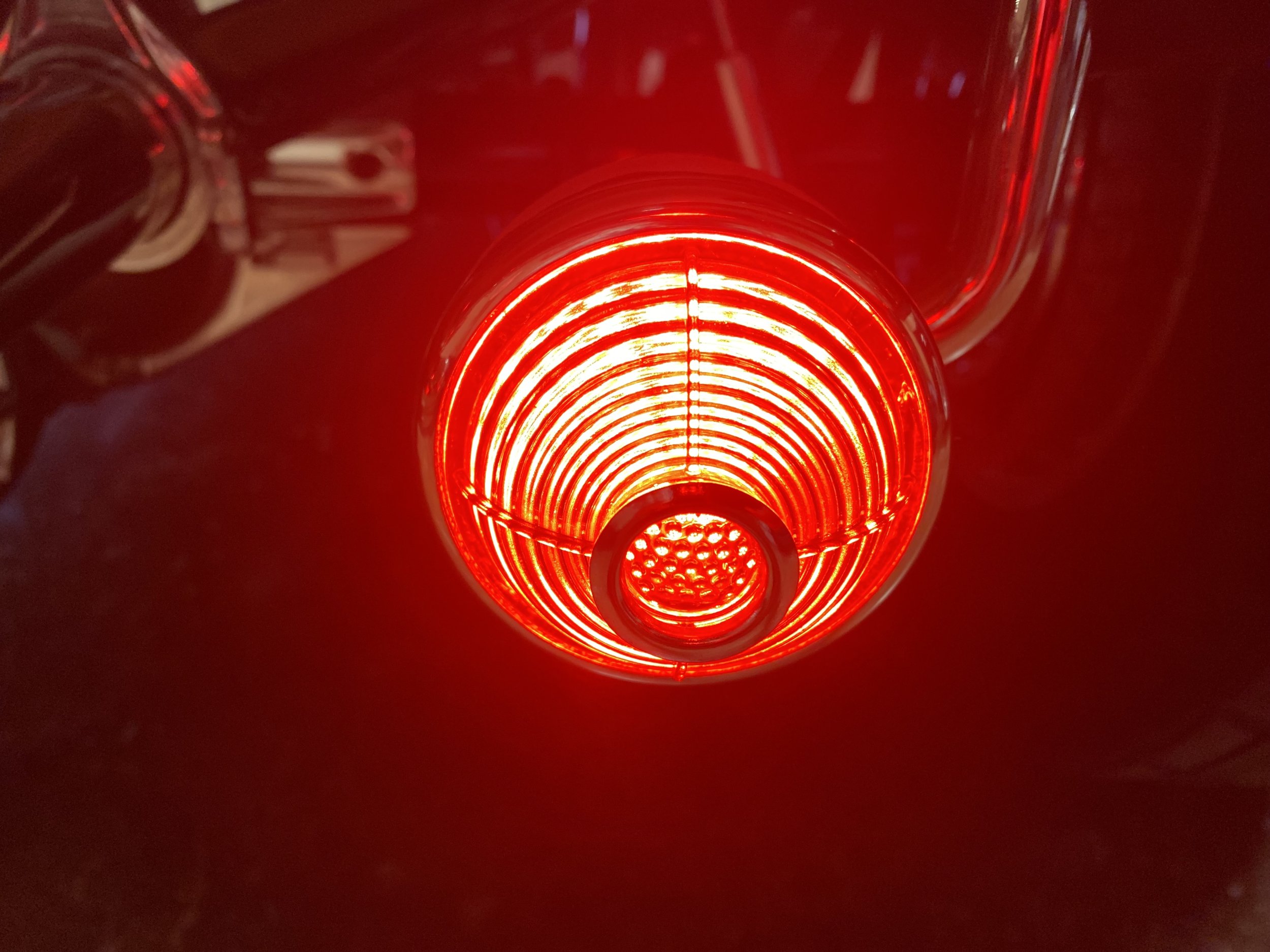

    I used the ring from the blue dots to add an accent to the lenses. They are plastic and though the shape is awesome they looked a little cheap to me. I also sprayed the inside of the lenses with transparent red taillight paint by VHT.
    IMG_7333.jpeg Now they have an appearance more to my liking and look even more “Ford” like.
    it is hard to take good pictures with the lights on but you cannot make out the LEDs thanks to the beveled in the lenses.
    I wanted bright, I got that and then some.
    Tradition may say 6volt bulb but then again tradition would also be one brake light and arm signals. I’m good with this.

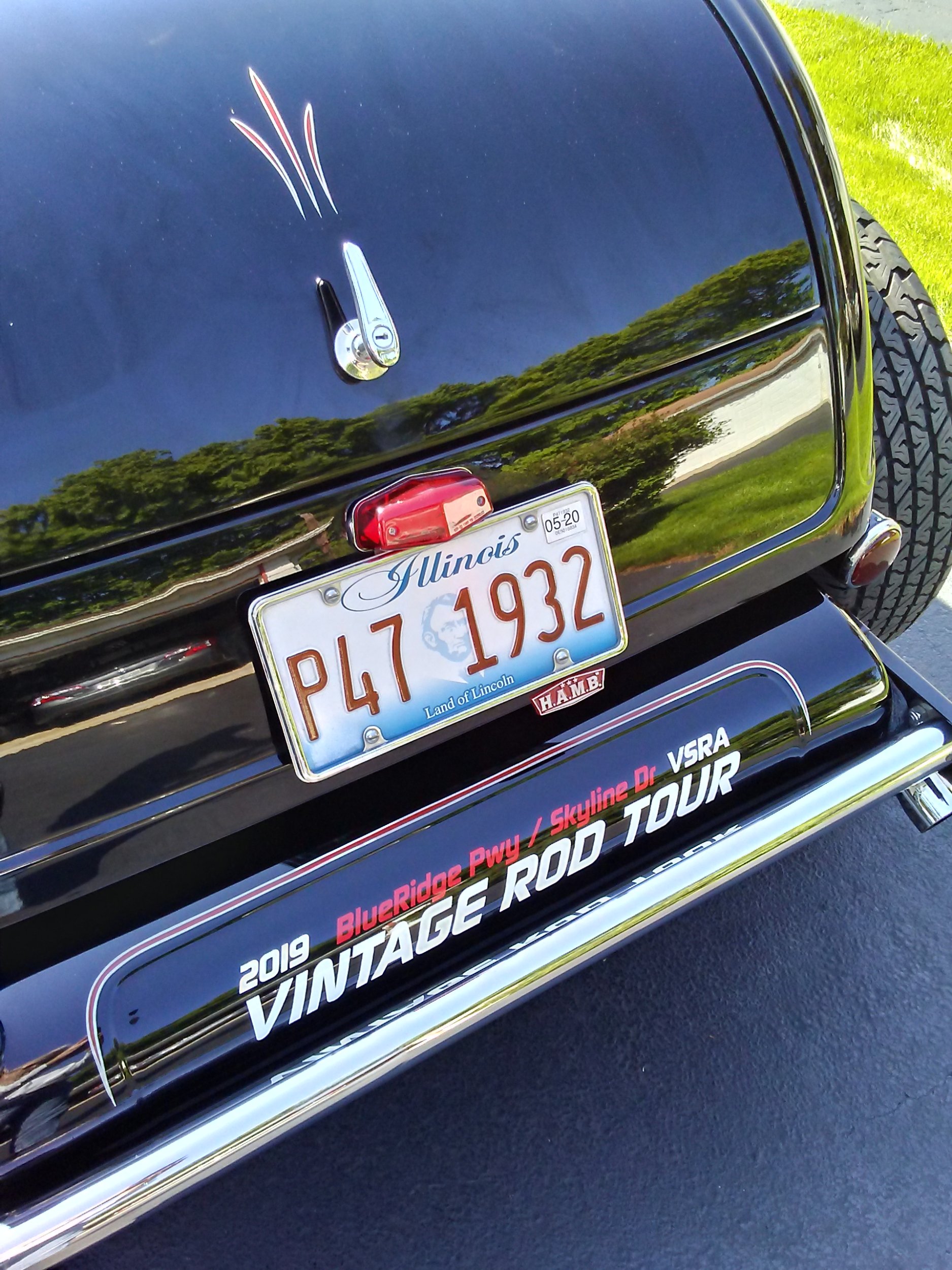

    For third brake light I removed the chrome license light and used a reproduction vintage motorcycle taillight.

    That is a good look.

  7. You can darken up the lense by painting them with the dye that is used for "stained gl***" artwork. The dye is thin, lays out flat, and you can vary the darkness by how many coats you apply. It will 'tone down' the chintzy platinic look. Lasts a long time.... my '46 Chev plastic lense have held up great for 20+ years.
    porkshop and Bandit Billy like this.
  8. Bandit Billy
    Joined: Sep 16, 2014
    Posts: 16,390
    Bandit Billy
    You get it. That pinkish, plastic look is nasty. Dark red is the look of gl*** lenses. Good tip

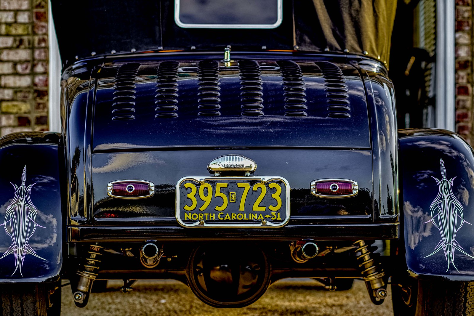

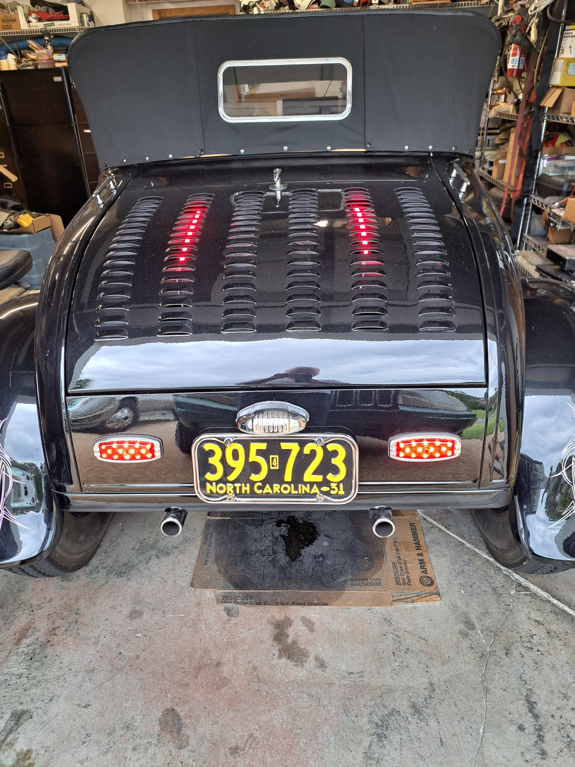

    Billy I have LEDs in the 48 Chevy lights on my roadster. I was worried about not being seen as well. Because my trunk lid is louvered I ran 2 LED strips inside the trunk lid in line with a row of louvers on each side. Now with everything hooked up my tail lights pulse and the LED strips pulse as well. If you run into the *** end of me now you have to be ******** blind! You can barely see them in the first pic. :D

    Oh I like that!

    Clever idea!
