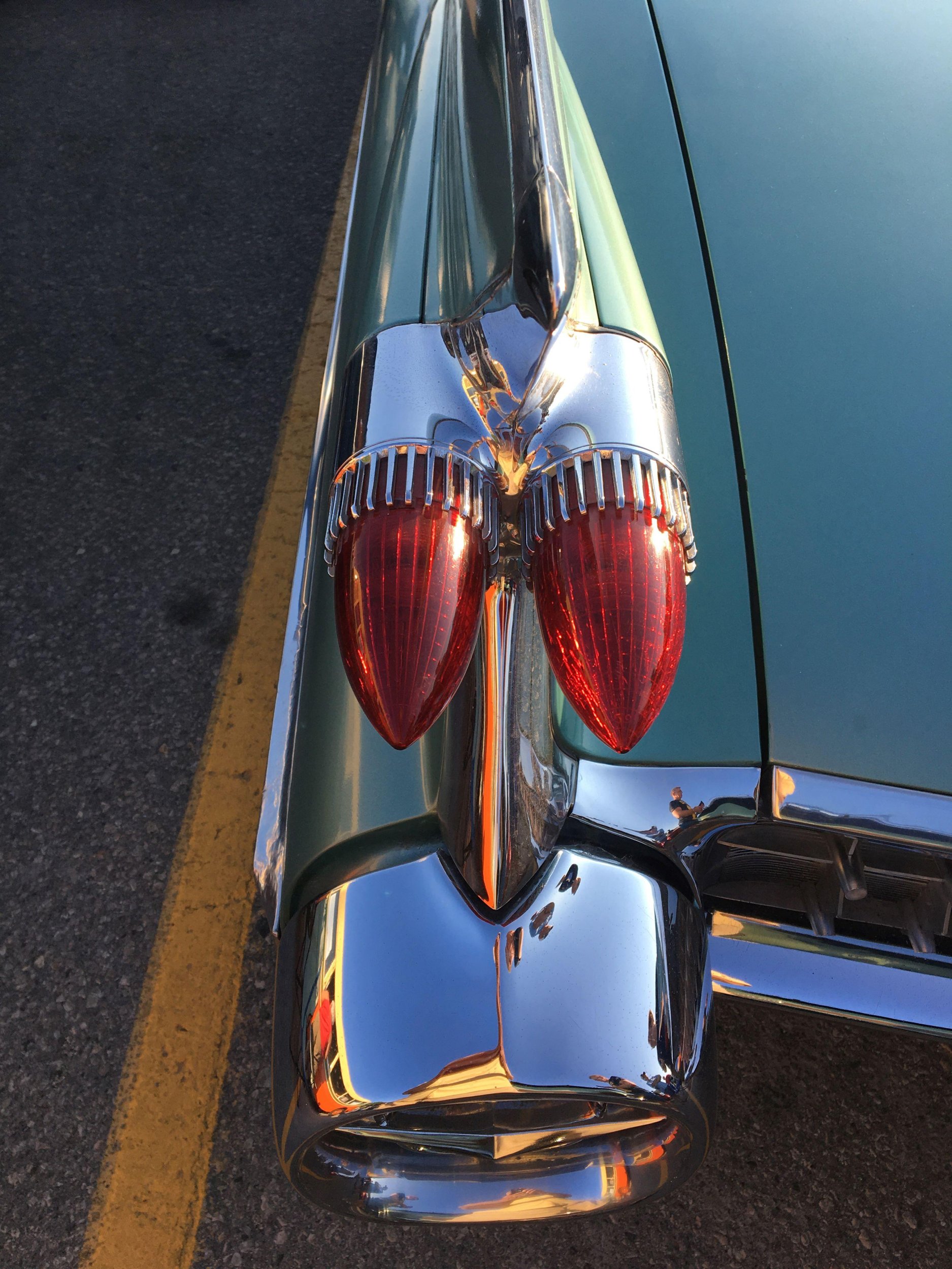

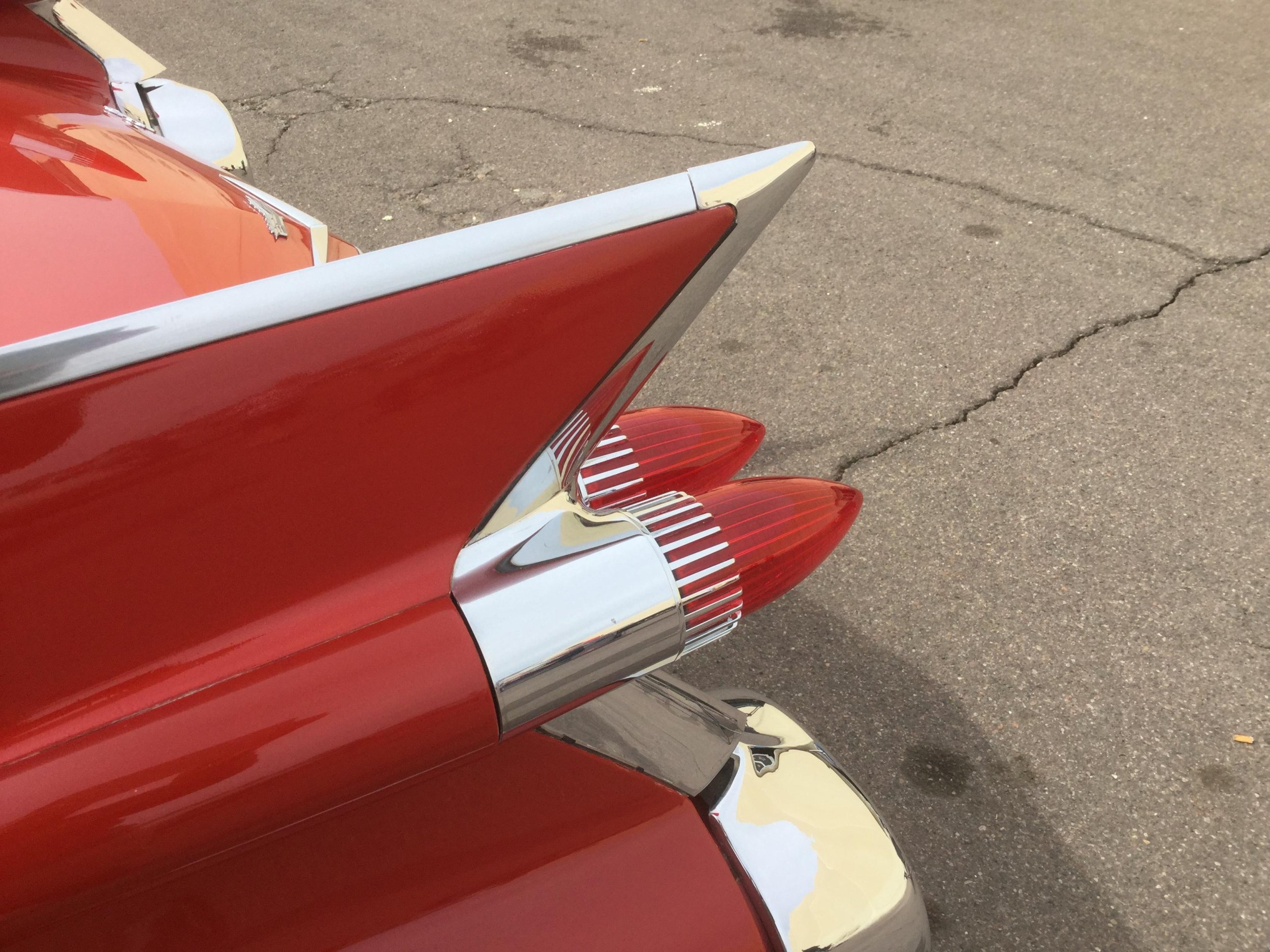

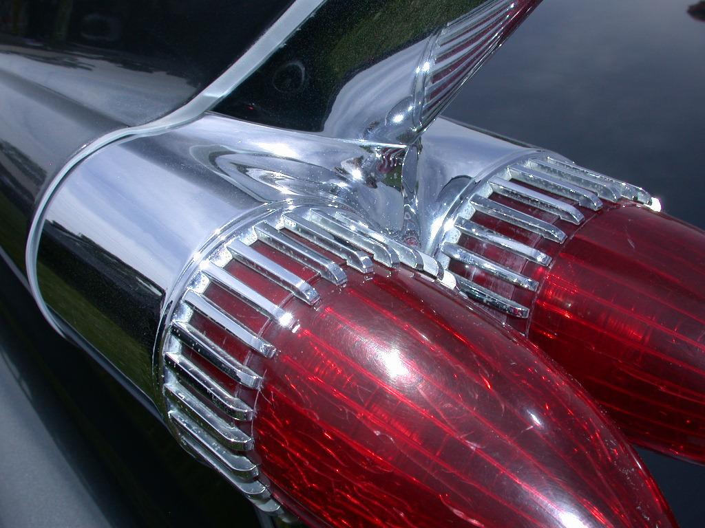

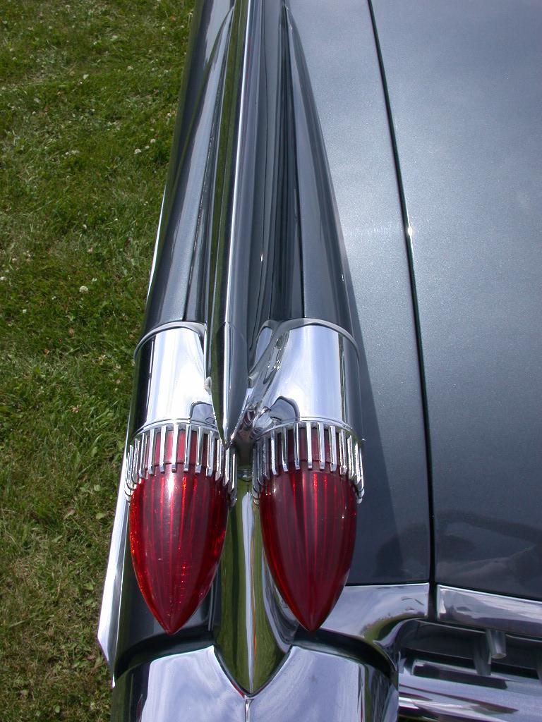

    How's about a pair of these?????.......:D;) DSCN7965.JPG.7ef5167b9b134c1f7450c9404d367515.jpeg IMG_6947.jpeg.f294e34c30c60c8cfe007be6dc552100.jpeg 59Caddybullets.jpg.89fc621e4cd7a93c8ae1a91e21b5c0d1.jpg DSCN7967.JPG.643393e6bc0c3ba73153a0445688798a.jpeg

    I was kidding....:rolleyes:

    They remind me of ****ies from the 50's. Dangerous, pointy, illuminating.

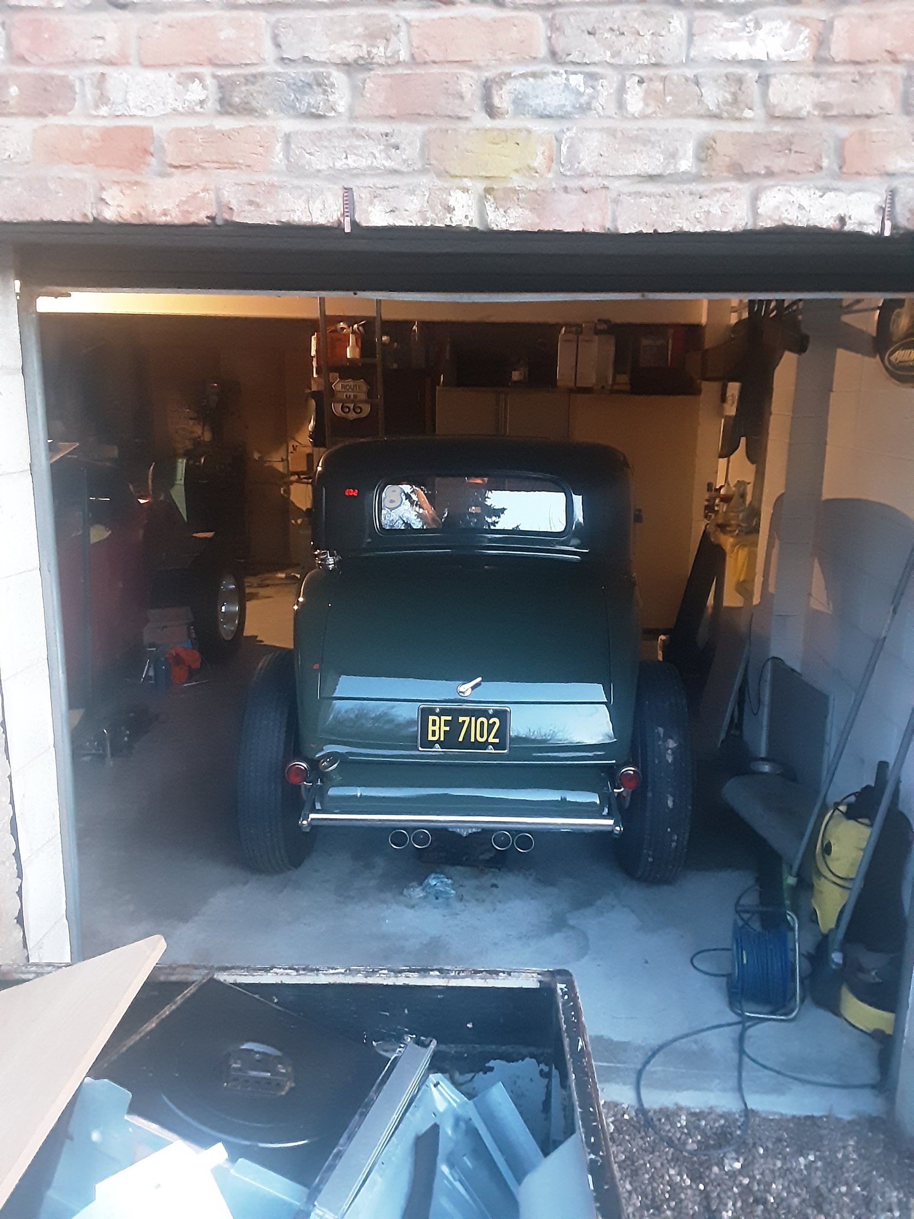

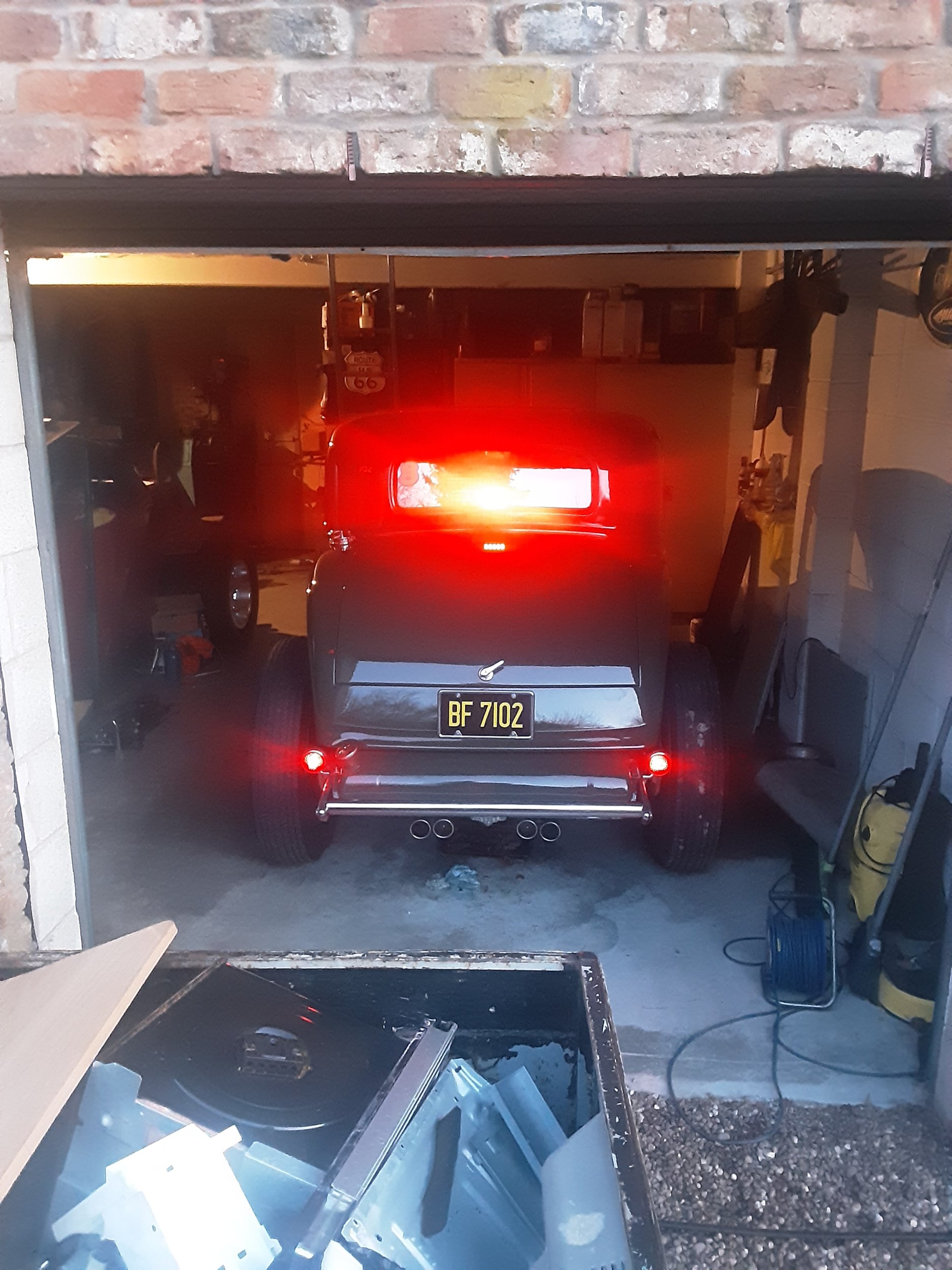

    I went through this a couple of months ago, before I saw this thread. My 32 coupe has 37 tail lights and had the 1157 led replacements but they were far from bright. I've never seen the big, flat leds BB has used, looked for them now but seems they're not available in the UK right now. Irrespective, I bought the United Pacific units and whilst they areng the greatest from an appearance perspective, they're very bright.
    Whilst these were on their way from Summit ( no UK stockists) I experi enter with F1, that's motor racing series, not Ford trucks, rectangular multiple led units. They have brake and tail light, but the tail light mode is just high power on, like a brake light, not dimmed. The brake light flashes for a few seconds before going solid. I made an aluminium housing and have mounted it with GoPro type mountings until I can make a better mount, but still rather experimental for now! I made it all quickly removable with a stereo jackplug for the wiring. I bought a red unit initially and it worked brilliantly but looked rather hideous when not illuminated, so I purchased a black tinted unit which is very stealthy and works well but not quite as bright, but bright enough.
    Here's a pic of the brake light with the poorer lens in the 37 housings. I'll have to take some more pics of the housing etc to post.
    Still a work in progress but I'm feeling a lot happier. On the couple of drive outs I've done I can now tell my flashers are seen by the actions of other drivers, eg when changing lanes on freeways.

    @Happydaze , have you painted the inside of the taillight bucket with gloss white? It really helps brighten the light.

    Yeah, that's bright! Well done!
