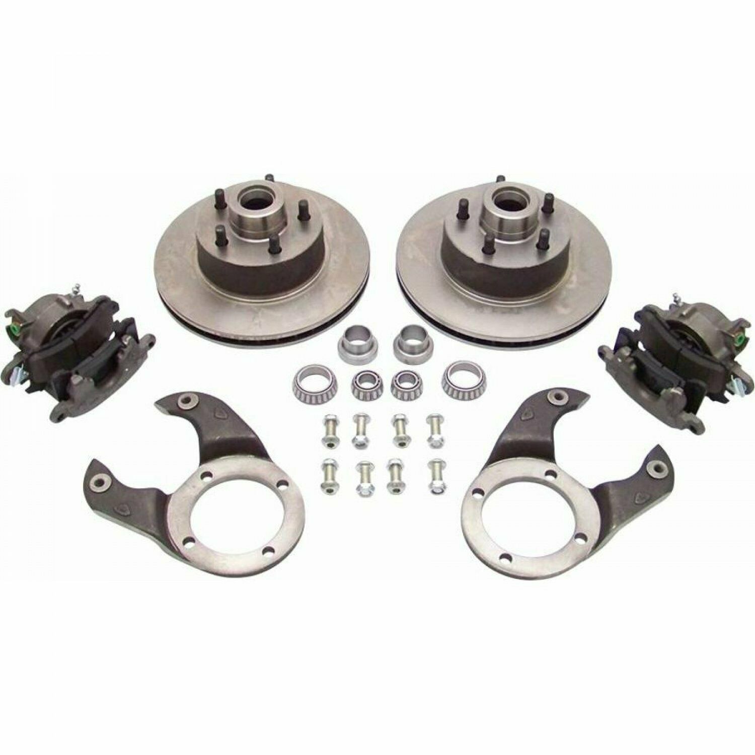

    I have a few sets of Airheart calipers and brackets but no rotors, I would much rather run those but parts are scarce!
    This may be my only choice:

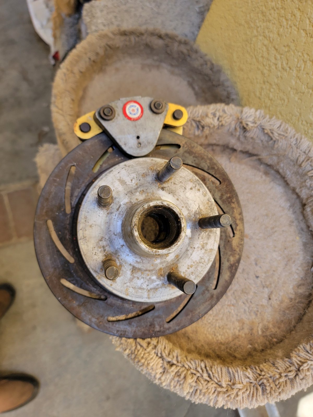

    drumyn29
    I have these anglia brakes but I worry about safety with machining my 42 Ford spindle

    Those calipers are for a really light car, or for rear brakes. Volvo discs were used on a lot of 1970s street rods, but are designed for a car that weighs well under 3000 lbs.
    You probably have to spend some time thinking about the trade offs of your available choices. You can get better drum brakes, you can get those small ugly modern street rod disc brakes, you can get more expensive aftermarket brakes like Wilwoods, you could do some research and see if there is a larger, older, foreign brake that will fit, or a different early US brake.
    You'd probably be better off with stock brakes than with way undersized disc brakes.

    It depends which disc brakes you get. Those in his first picture are pretty heavy, those in the second are pretty light.

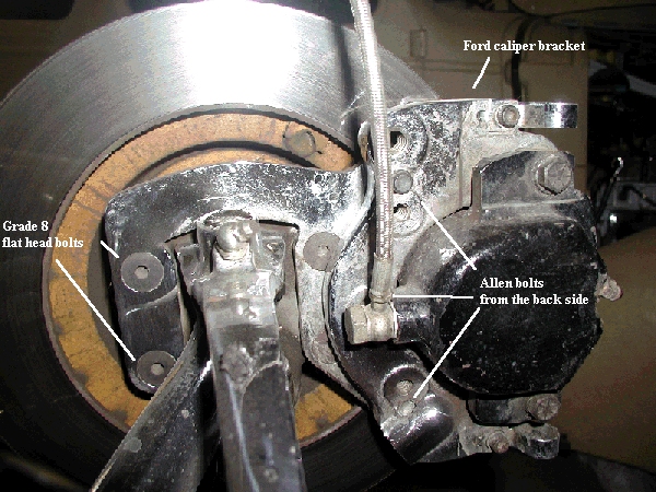

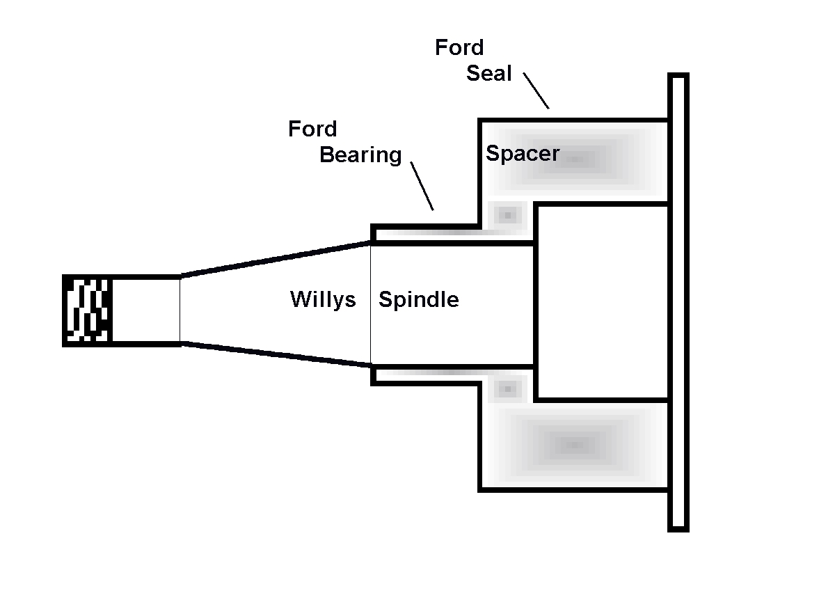

    willys36
    I adapted 70s Ford torino disks to my stock '36 Willys axle.
    Brakes 1.jpg Brakes 2.jpg Brakes 3.jpg Brakes 4.jpg Spindle Spacer.jpg brakes.jpg 1-p136willysJJ.jpg

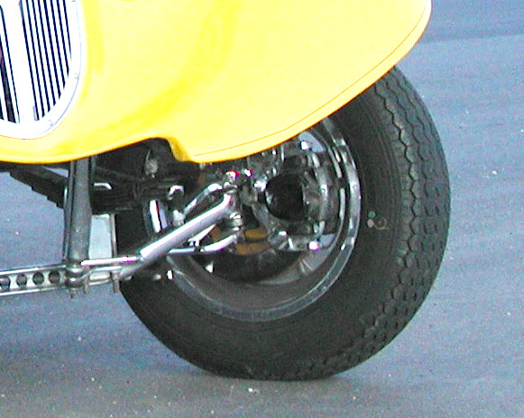

    I run either rally wheels or 5 spoke mags. I use dust covers (cheap) between wheel and hub. really cant say i have ever had an issue seeing disc brakes from the backside .I think street rodder had article on how to use, wait for it, a SS pan bolted on backside to hide rotor.
    Of course my buddy has to have his red caliper showing behind wheel....
