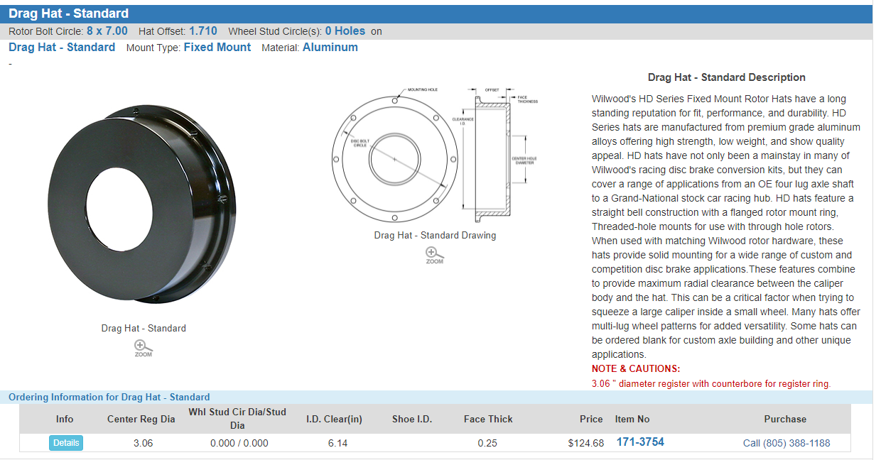

    Volvo hubs and I think I had to machine 1/4 inch if I remember correctly. But the Ford spindle is larger with what I am doing now.
  2. brading
    Joined: Sep 9, 2019
    Posts: 806
    brading
    Have you thought checking a brake disc catalog to see if you can find solid disc similar the vented disc in the picture that would be suitable for you could use on your Ford hubs.

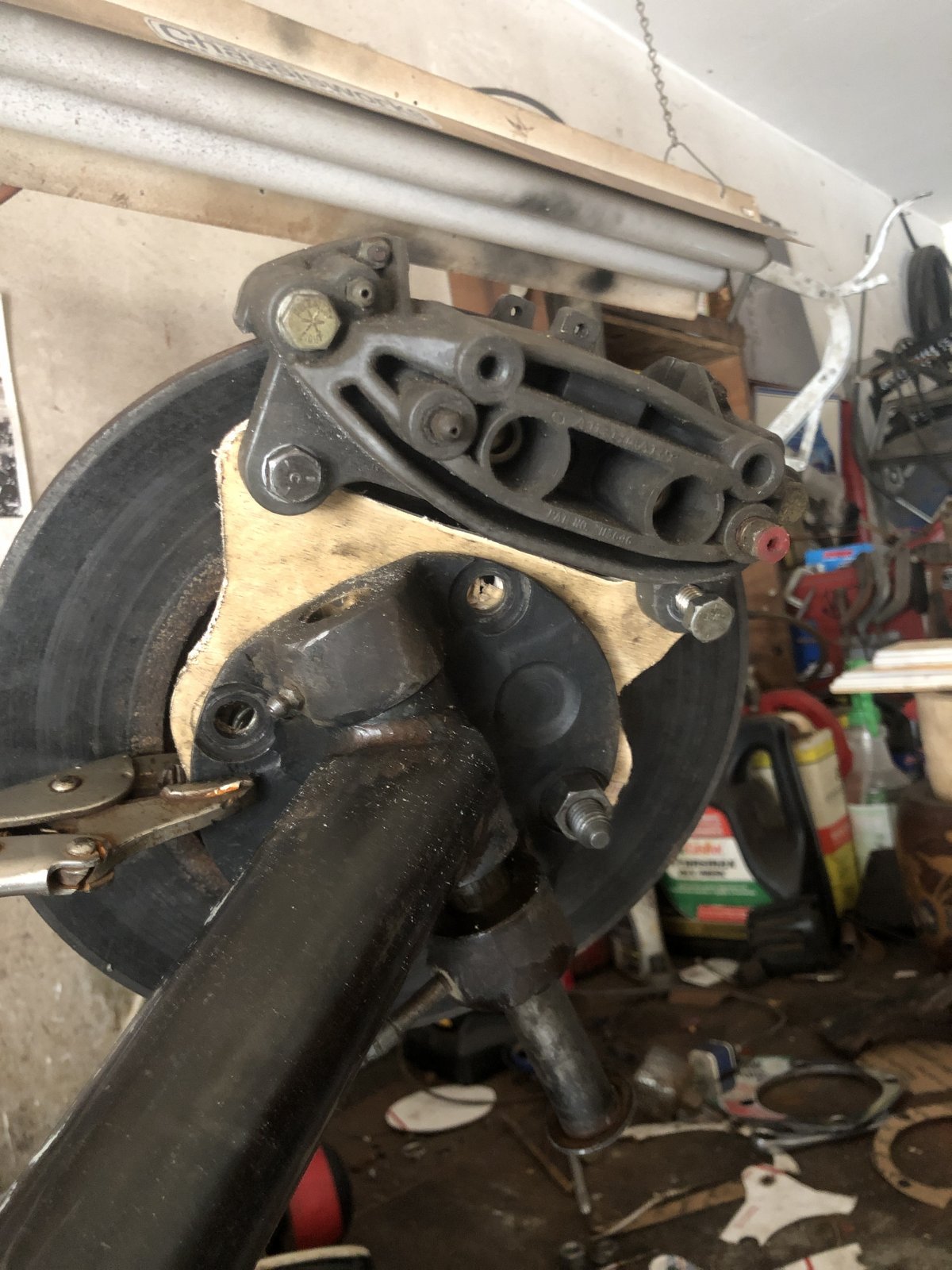

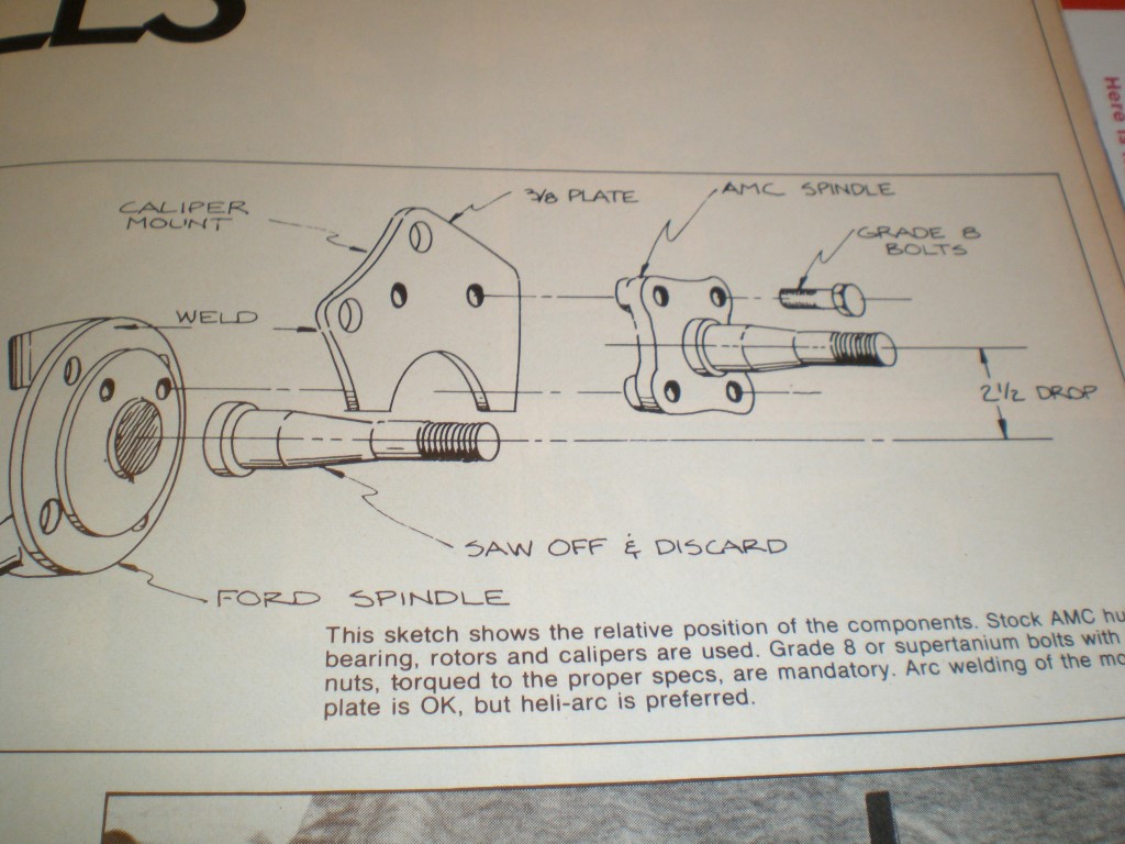

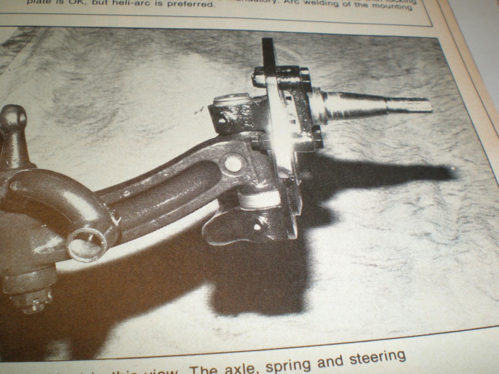

    This is kinda cool!
    AMC B872B5A1-DD0A-46F2-8445-83D1427D53D3.jpeg 4CCC37D9-8FE0-49ED-88FA-153E25E9E93C.jpeg

    Looks like the calipers bolt directly to the hub, are you using Volvo rotors?

    I'm guessing partly because the supply of Rambler bolt on spindles was dwindling, a lot of car trailers were built with them back then, a friend of mine built a handful in the early/mid 70's.
  10. drumyn29
    Joined: Feb 16, 2006
    Posts: 2,268
    drumyn29
    The only drawback I see is that it lowers the ride height 2.5 inches. Does the AMC caliper sit in front of the rotor?
  11. Around here we had a great AMC dealer so their were lots in the yards. I am sure it varied by area. Yes, they do make great trailer spindles!

    Hey, Drumyn29;
    The amc brake article that was posted, was done that way to get that 2.5" drop(+ instant *large* discs, cheap), instead of using a dropped axle & some of the issues that come w/that. You wouldn't *have* to use the extra plate welded onto the spindle back, just drill the holes to mount the amc spindle in the same plane as the ford. & of course, make a caliper bracket correctly for the offset needed. There's a thread on an amc here, that one of the guys notated the difference in the various amc spindles. There are, I think, 4 different spindles depending on brakes. Bradings' idea is probably better, as more is avail.

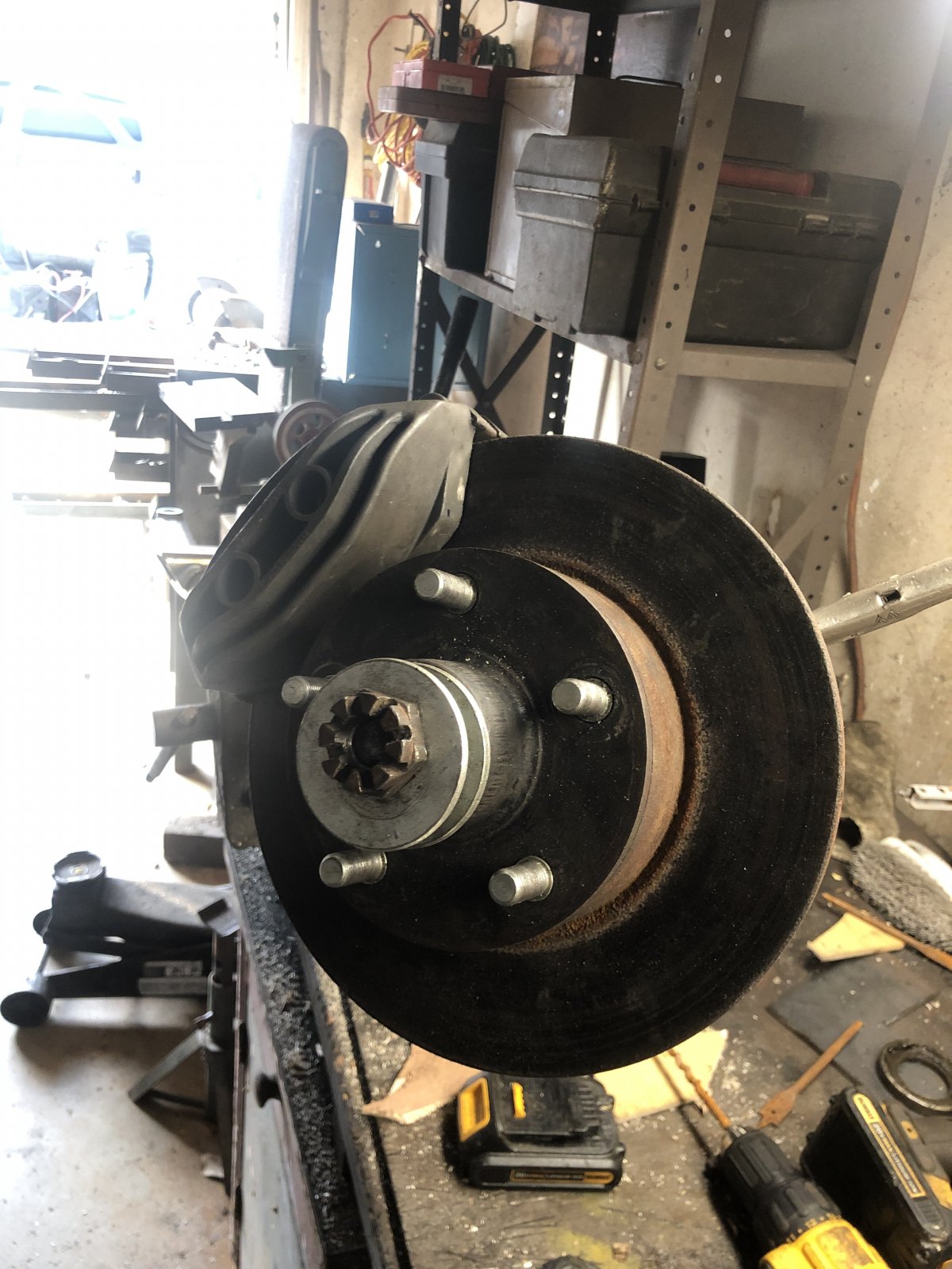

    I think I may go with Volvo rotors and machine the Ford hub to work with it. At this point I am considering Airheart calipers, does anyone have any opinions on stopping a big horsepower Hemi with Airheart calipers?
    67072676594__89DCABC0-2852-4F53-84BA-78A7E8A9E27C.JPG 67072678297__CA9538FF-F0DF-494E-BF38-A91CDFFDD674.JPG

    volvo rotors, 48 ford hubs, airheart calipers
    67072676594__89DCABC0-2852-4F53-84BA-78A7E8A9E27C.JPG 277785429_5316292768380966_3233548092700753794_n.jpg IMG_8081.JPG IMG_8082.JPG

    Nice setup. Have to remember 122s are 4.5 PCD as some of the Volvo's are 4.25 PCD.
