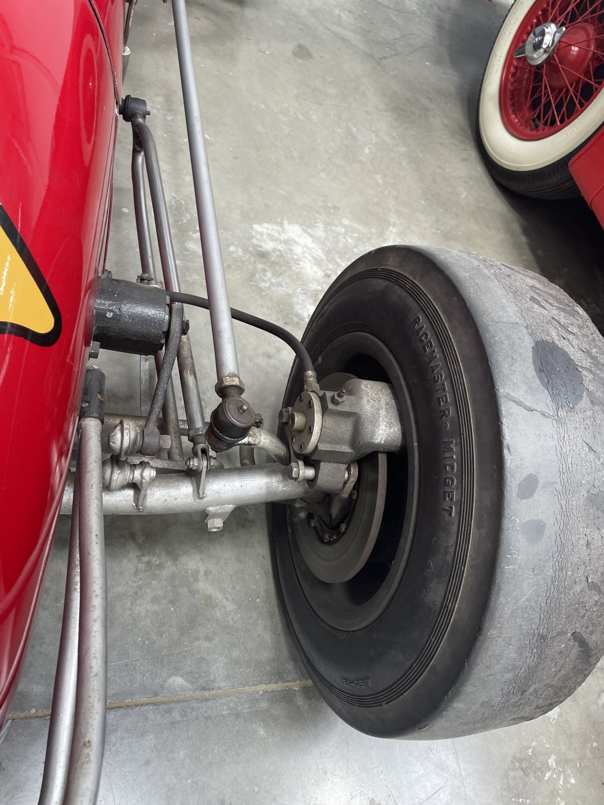

  7. What’s on this Midget at my old bosses shop?
  8. Fordors
    Joined: Sep 22, 2016
    Posts: 6,491
    Fordors
    Halibrand single spot calipers and rotors.
