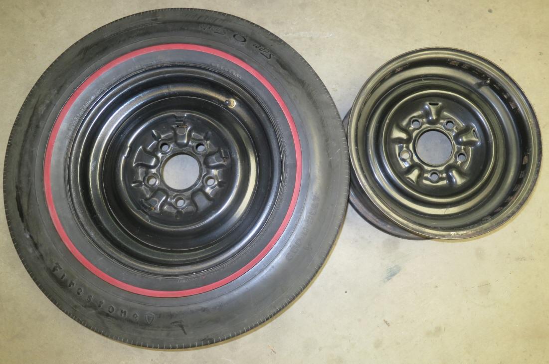

    While Pontiac went to 14" wheels starting in 1957, at least in 1962 15"x6" wheels were optional and part of the HD brake package option. Forgive the tire but here is a 15" versus 14" Pontiac wheel . The centers should be the same as the earlier 50's Pontiac 15" wheels. Not sure what the ID of a modern hoop is but FWIW the 15"center is 12-5/8" diameter versus 12" for the 14" wheel.

    Thank you for the pics and measuring the wheel centers. Is the 15" you have pictured a HD brake wheel from that era Pontiac? I've never seen one like that (rare?) Hoosier just came out with a 29x7x15 Super Stock Slick that I will be running, they only have 15", no 14".

    Looks like it. It has the 3 clips that are required to install the dog dish hubcaps.

    Love the redlines!!!!!.....:D:cool:
    Yes, they are the correct 15" wheels. The probably easier to find mid-50s Pontiac 15" wheels have very similar if not the same centers but I believe are only 5-1/2" wide.
