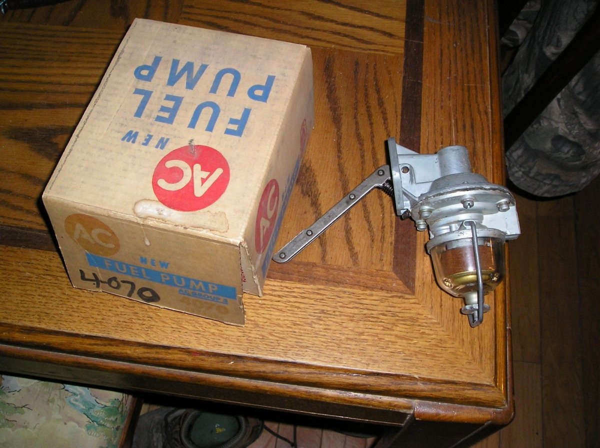

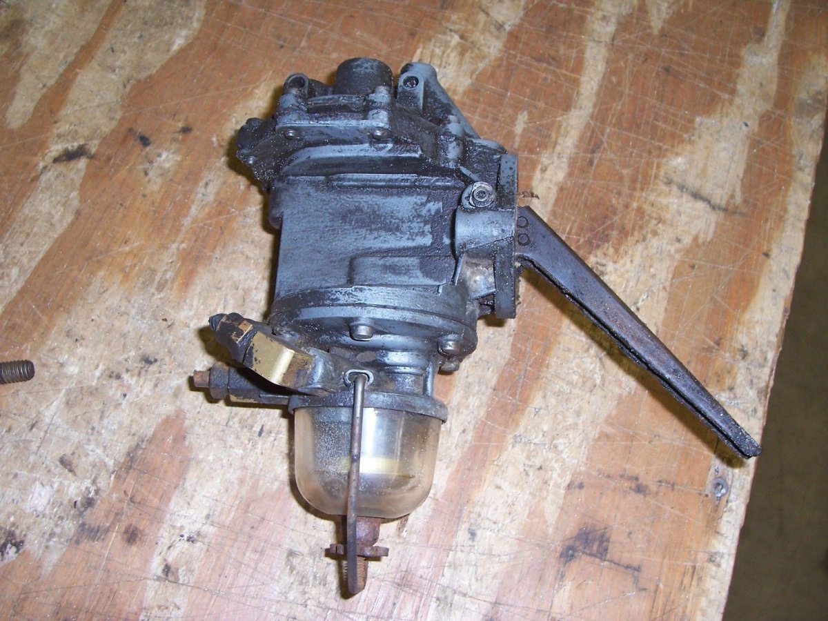

    I was told this fuel pump was for a Ford Y block. It is not. What motor is it for.
    Thanks
    Mike

  2. stillrunners
    Joined: Aug 27, 2009
    Posts: 10,586
    stillrunners
    from dallas
    see if some where on the body of it there might be a 3 or 4 digit #....might help....
  3. jim815
    Joined: Dec 20, 2007
    Posts: 17
    jim815
    from Dallas, TX
    Nunber should be on the flange where it bolts to the block...

  4. Budget36
    Joined: Nov 29, 2014
    Posts: 15,303
    Budget36
    AC...would think GM or industrial

  6. Mlacelle
    Joined: Nov 13, 2014
    Posts: 47
    Mlacelle
  7. Mlacelle
    Posts: 47
    Mlacelle
    4052r
  8. TagMan
    Joined: Dec 12, 2002
    Posts: 6,355
    TagMan
    Hollander's Interchange manual, says:
    "B4A9350E W/vac. AC # 5594052 Ford '54 8 239, 256 eng. P*** & Tr. w/Fordo or O.D. Mercury '54"
  9. Mlacelle
    Posts: 47
    Mlacelle
    WOW That's great information. Thanks. I just posted it for sale.
