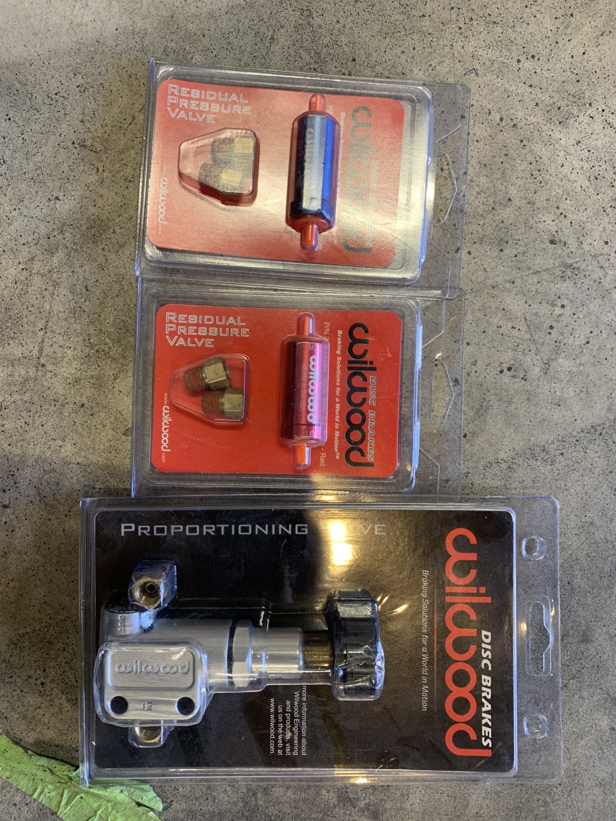

    I’ve installed plenty of brake parts over the years and done plenty of work on brake systems but I’ve never built one from scratch. I’m kind of confused and need a little help getting me over the hump.
    40 ford, I am upgrading to disc brakes, bendix rear brakes and dual master cylinder.

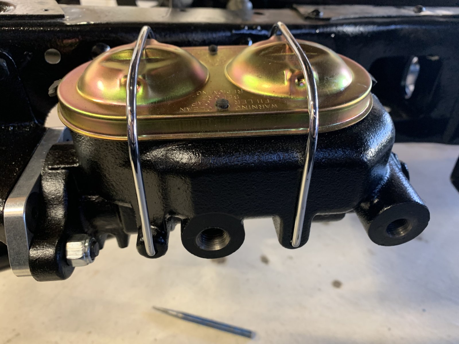

    The master cylinder has 4 holes to plug brake lines into (two on each side). What needs to go where? I know one goes to the front and then splits between the front wheels. What is the splitter part called?
    I was also sent two residual valves. Where do these go?
    Thanks! I know I am missing just one or two things in my head that once explained to me it will all click.

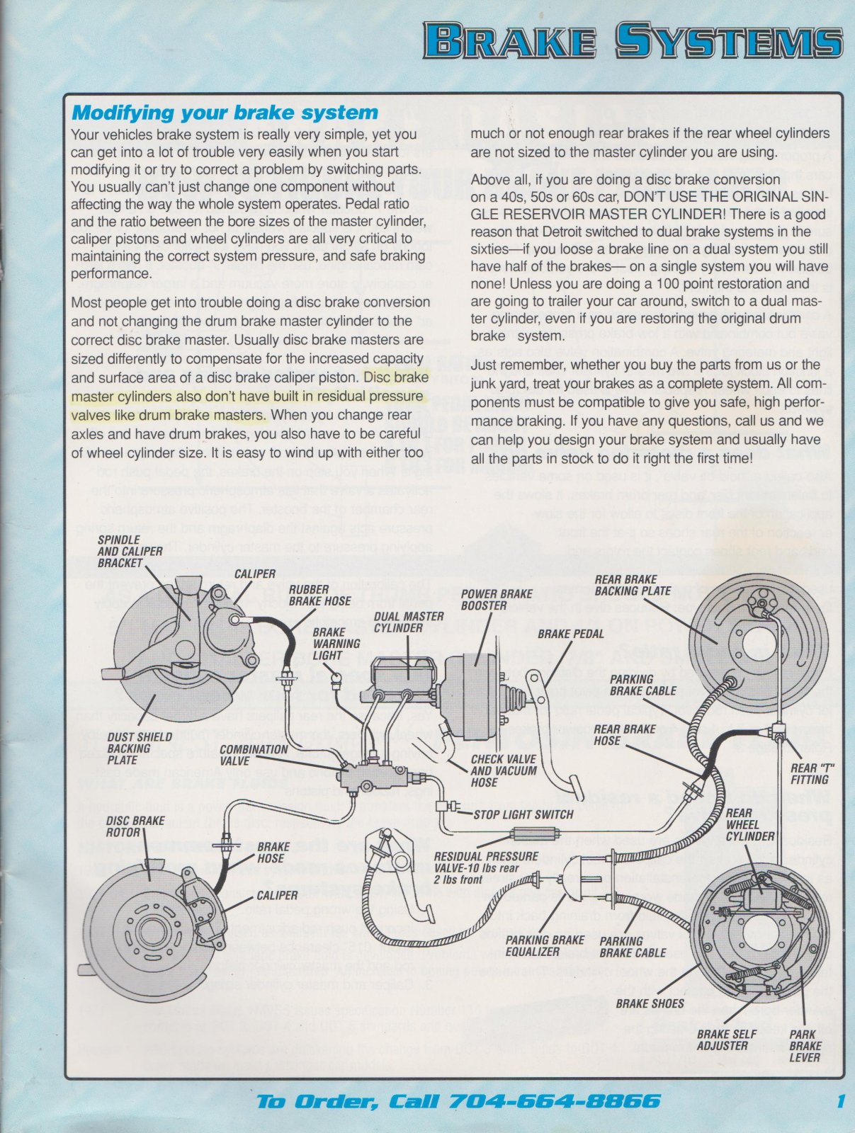

    Plug two ports on the same side, use which ever side works best for running the brake lines. If the master is firewall mounted the rear port goes to the front and the front port goes to the back brakes. 3# residual valves are for the front disc brakes, 10 # residual valves are for the rear drum brakes. The proportioning valve goes in line ahead of the residual valve to the rear brakes.

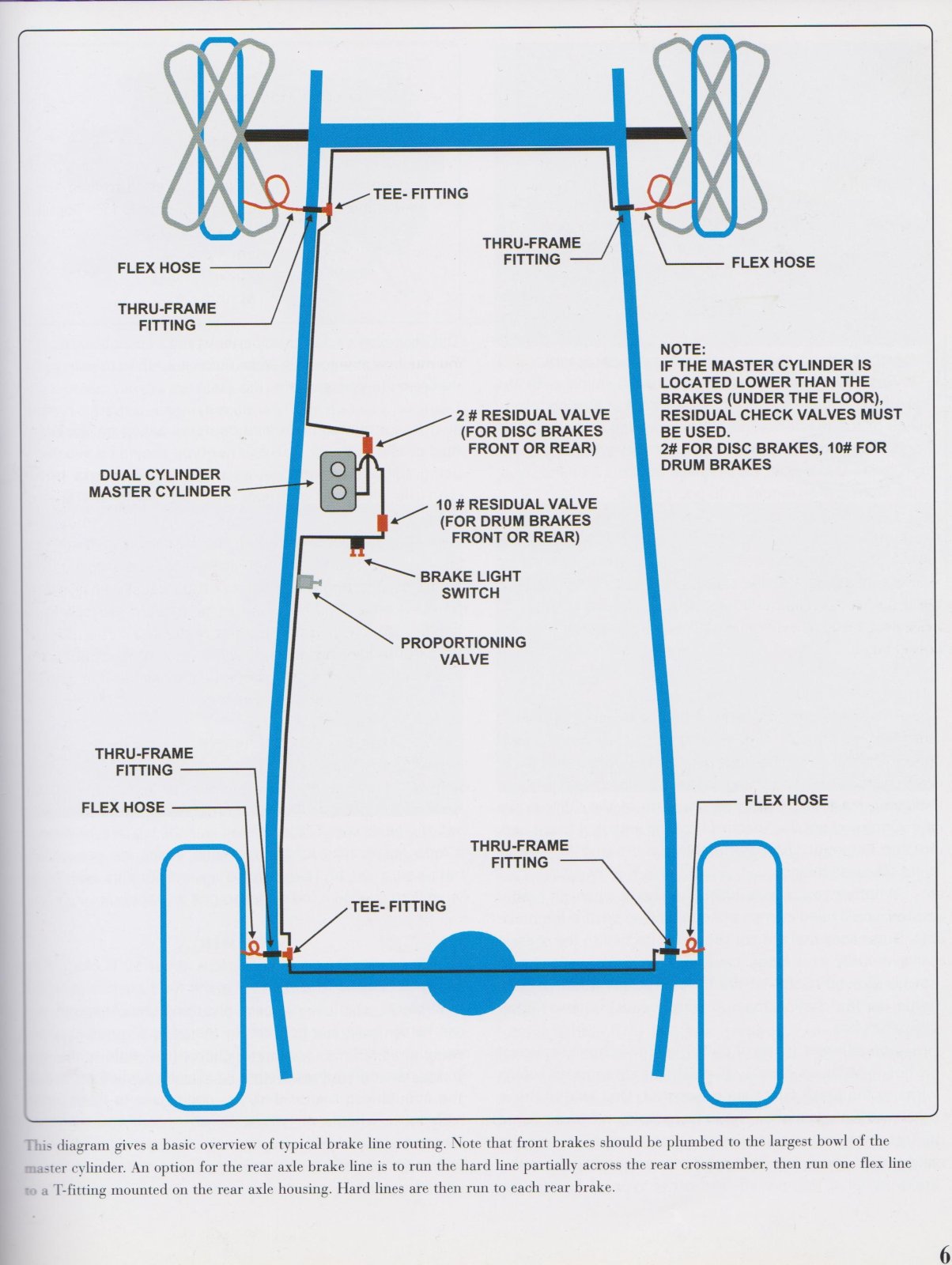

    Here is some info that might help.
    There......that should occupy you for a little bit.;)

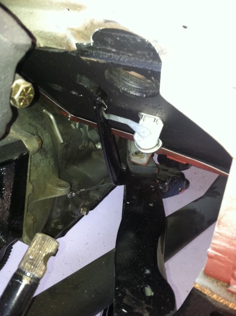

    I think you would be much better off to use one of the mechanical lever arm light switches instead of a hydraulic kind. I like the ones that came on 50-60’s Chevy big trucks. There was a thread here lately that had the part number in it.
    Mount it to the underside of the toe board and when the pedal comes up to rest it clicks the switch off.

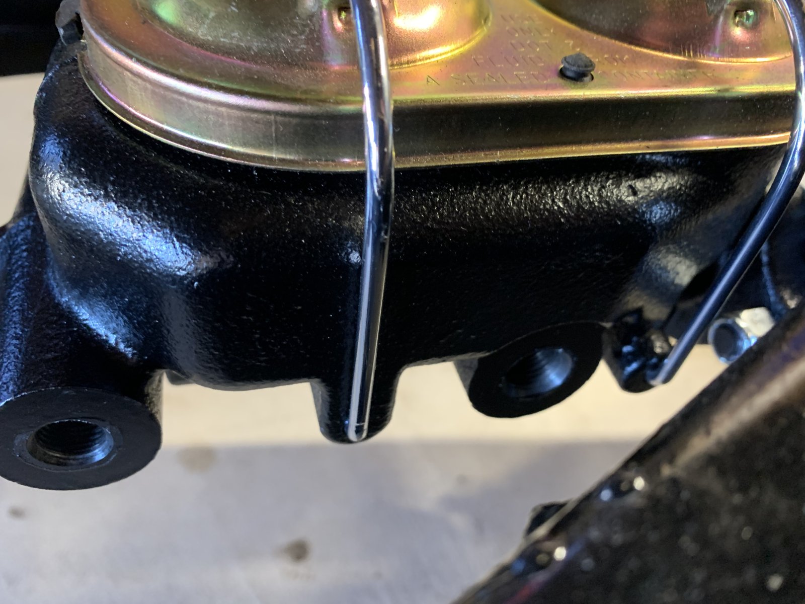

    The ports on each side are the same outlet, just two sided so you can use whichever side you prefer, or even use one from each side to feed the front calipers. Could use one side and T it after it leaves the master and the T can go anywhere it's most convenient. I like to T it at the driver's side frame near that wheel, so the brake hose can run to the caliper, and the line can continue to the p***enger side.
    The adjustable proportioning valve goes into the line headed to the rear drum brakes, and I install them just below the master where they're easy to reach for adjustments.
    Residual valves go somewhere in the line between the prop valve and the rear axle, before it splits to both wheels.

    I would use the frame side outlets on the master cylinder, especially if there will be part of the exhaust system on the other side.
    I try to use OEM mechanical switches whenever possible.
    When that is not possible, such as when it would mean large-scale replumbing, or when I am just quickly fixing a customer's car, I will replace a hydraulic pressure switch.
    For those, I use OEM ones I get from the local Harley Davidson shop, that fit 1979-2003 XL, 1971-2007 FL, FLT, FLST, FX, FXST.
  21. RICH B
    Joined: Feb 7, 2007
    Posts: 6,137
    RICH B
    Chev PU brake light switch. Easily adjustable so the lights go on right away and they never leak.
