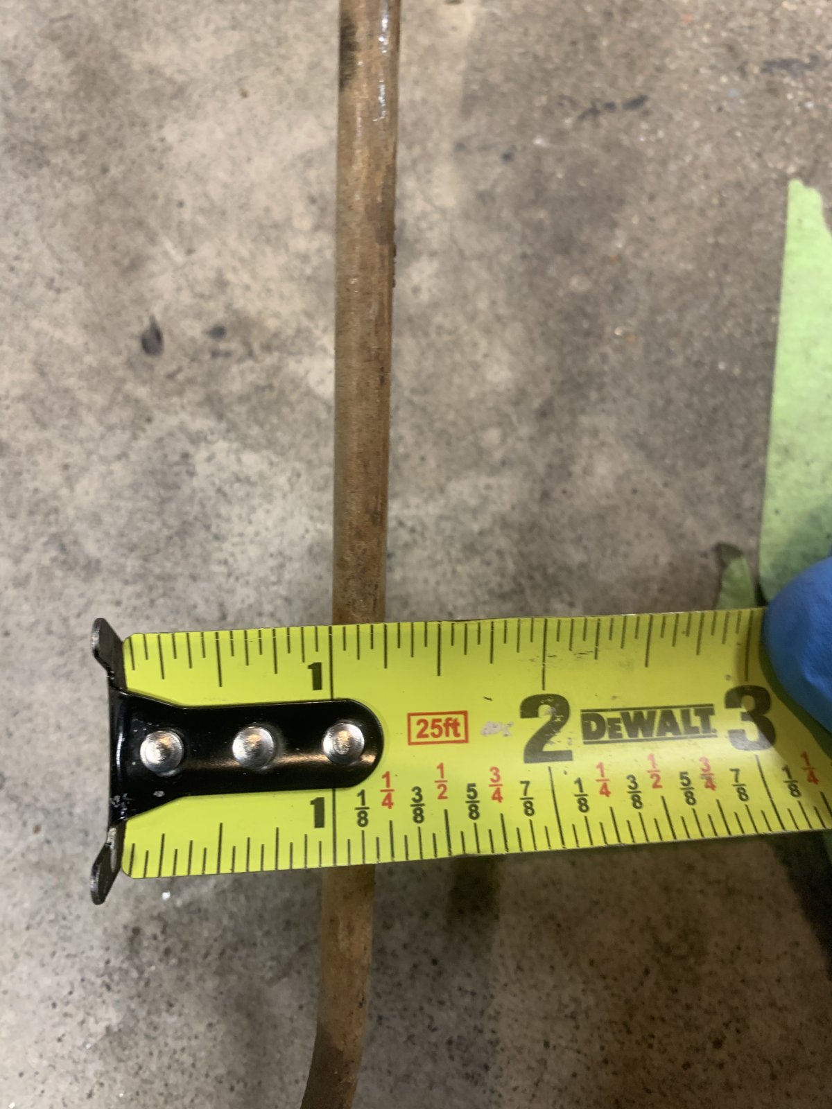

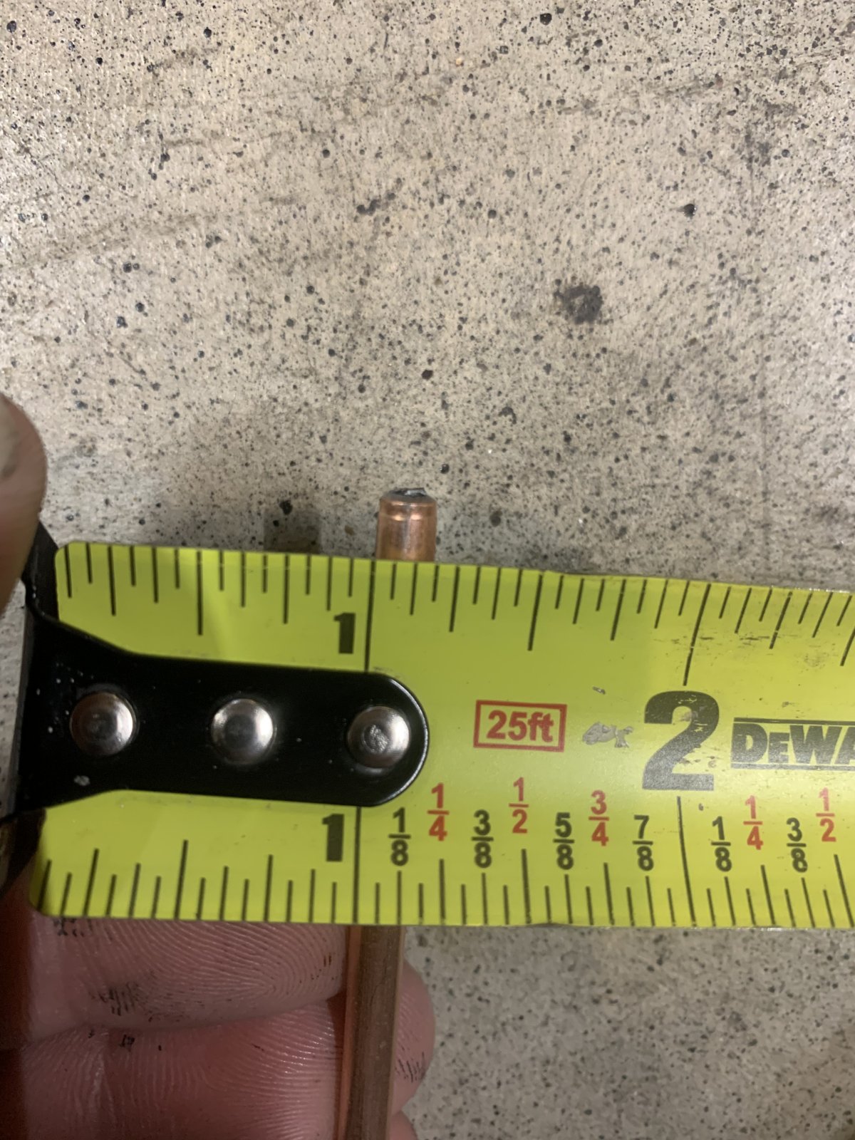

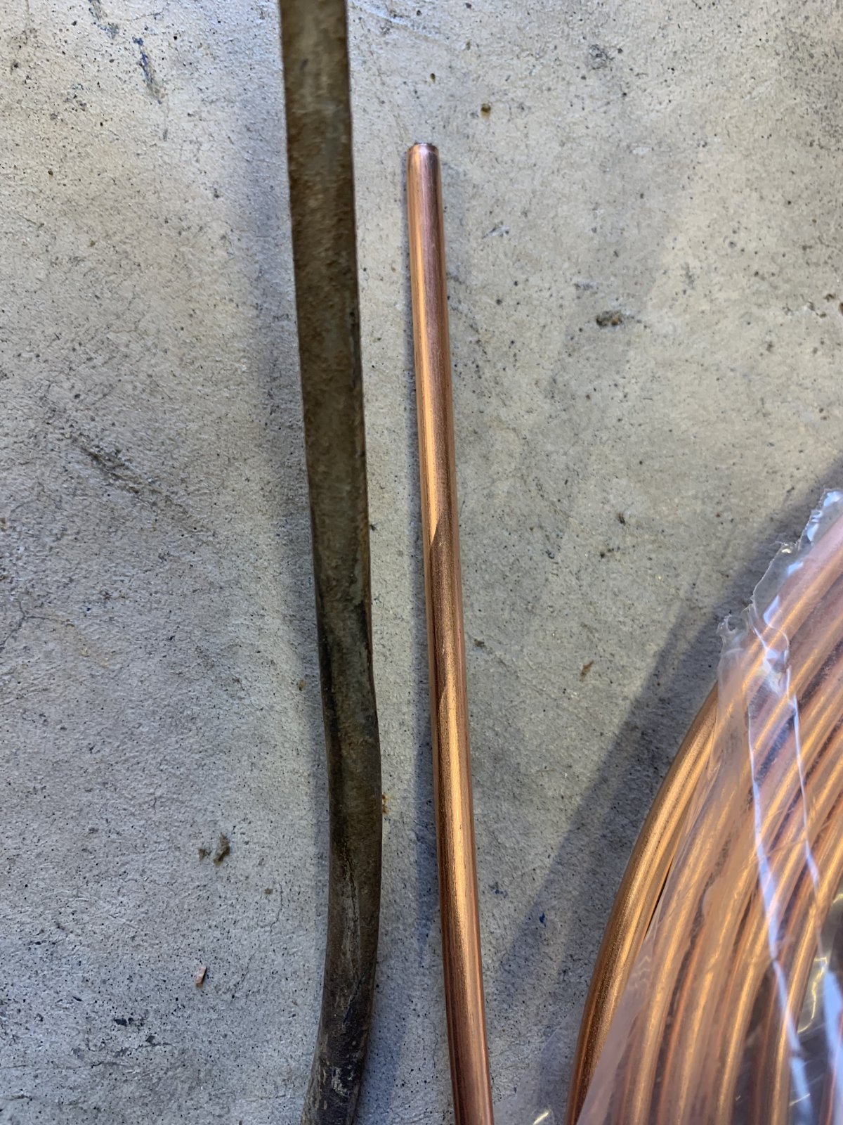

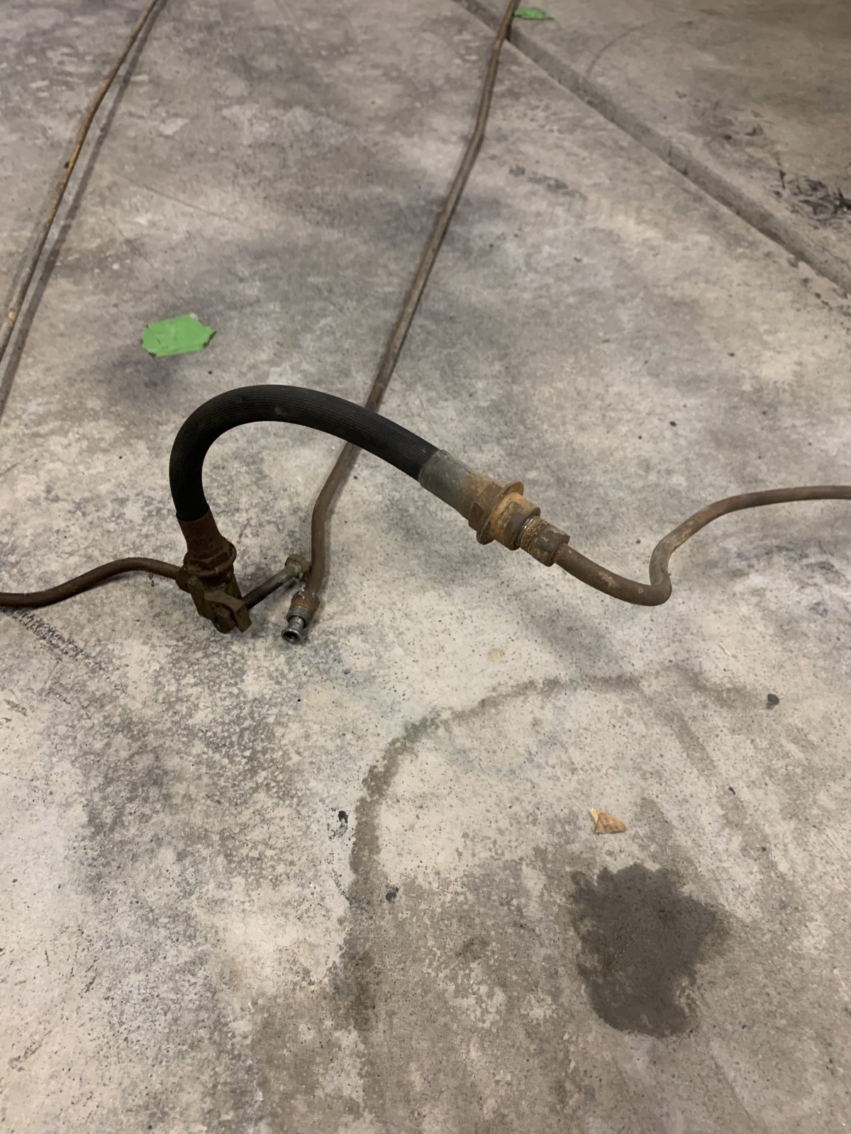

    question on 3/16 line. It looks awfully skinny especially when I compare to the old stuff which you mention as 1/4. Are we talking outside 3/16 or inside dimension of the tubing? Now, I must note that the tubing I have on hand is tubing I’ve had on the shelf for some time and it came with some brake line tools I bought years ago and I probably won’t be using it but the bag says it is 3/16 but I am questioning that. see photos.
    3EE8BC3F-5EB2-4C42-BC7A-8CEC55925531.jpeg 426BC47B-1286-4220-9C88-D77A185BF08C.jpeg
  10. wuga
    Joined: Sep 21, 2008
    Posts: 724
    wuga
    That appears to be copper tubing. You can't use that legally or safely. It will crack and split over time. Nicop was suggested earlier and it looks like whitish copper. It is easily available also on Amazon with the appropriate fittings at a very reasonable cost. What is that other dark tubing? It looks like pipe.

    Sorry, I should have clarified. The copper tubing I have on hand I am only going to use as a rough draft of the lines. I brought it up because it’s 3/16 like everyone recommends it just seems so tiny in size. I have it laying around on the shelf so why not just use it for mock up and bending and flaring practice. I'll likely never use it anyway. Figure I’ll get the general layout with that and then use the nicop as suggested once I mess up the copper.
    The tube next to it is the original brake lines I removed. It measures 1/4" OD. Reading alchemy's post, it makes sense that it measures 1/4".

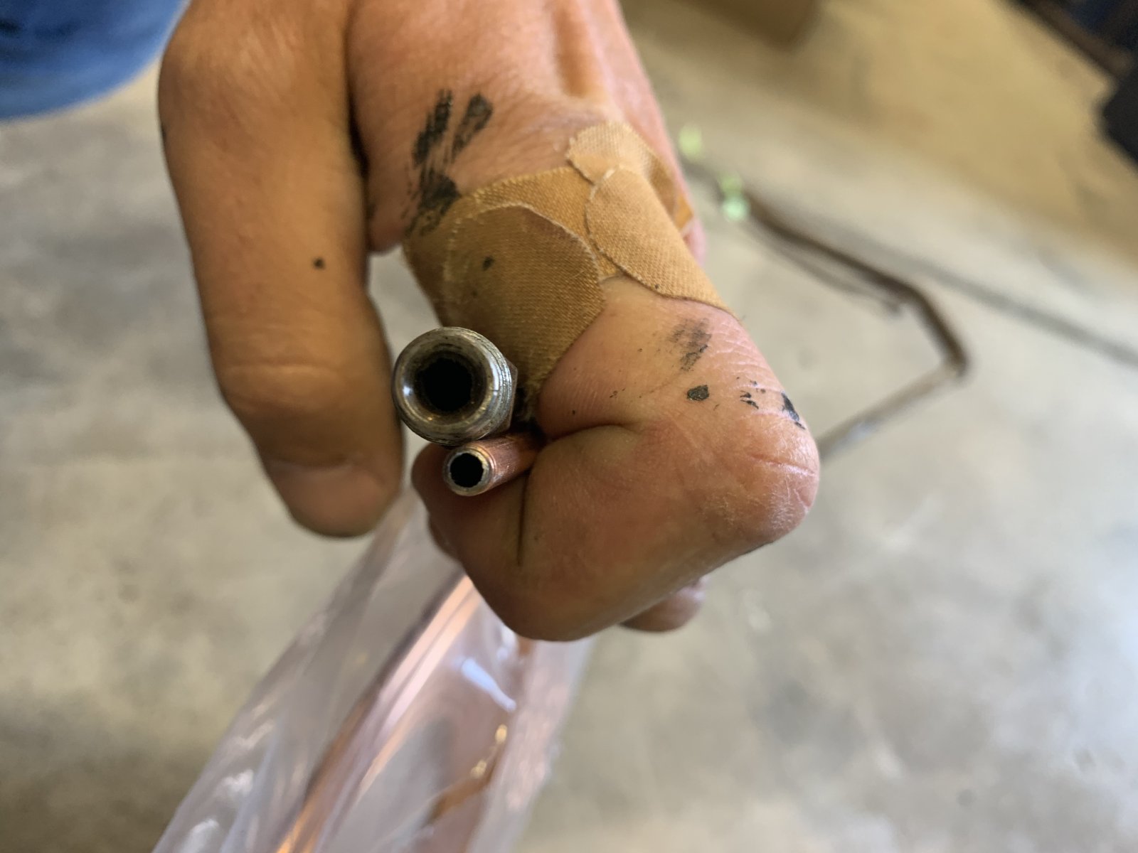

  12. gimpyshotrods
    Joined: May 20, 2009
    Posts: 24,532
    gimpyshotrods
    That larger tube is not 1/4".
    1/4" is 5/16".
    The larger tube is not 1/16" larger in diameter than the small one. It appears to be closer to double the diameter.
    You might have a sample of the old fuel line.
    Atwater Mike and lostone like this.

  14. lostone
    Joined: Oct 13, 2013
    Posts: 3,626
    lostone
    from kansas
    I agree with gimpy, looks like old fuel line to me too.

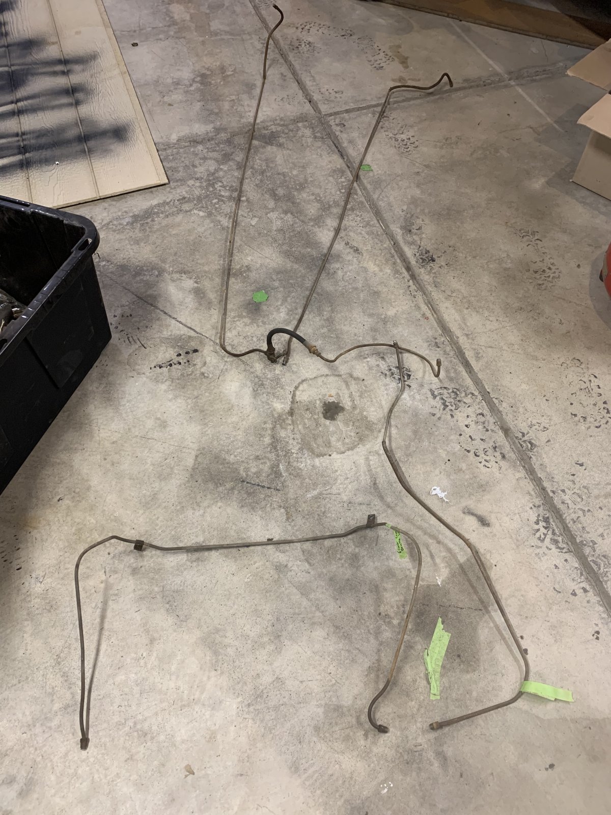

    I pulled the car apart. Seemed 100% original inside and out (off road since 1960) and these lines are 100% brake lines! I saved every single part and labeled everything pretty meticulously (or if I didn’t put a label on it I took a photo of it and made notes on the photos in my phone).
    these were absolutely the brake lines I pulled out. Definitely not fuel (I have that old line too…same size). Maybe at some point someone changed them? But I honestly think they are original. Here’s some more photos. They are the same looking as every other car I’ve worked on (60s - 70s vw buses mostly and some chevys sprinkled in).

    I see what's giving that illusion, your showing the ends but with the nut still on the larger line with it pulled up tight on the end.
    It makes the tube look much bigger due to the nut than it actually is.

    well sure but if you look at my last photos it is clearly 1/4 od. All the brake lines laid out too (so as not to confuse with the fuel line…which I also have). But I can see how my first phot was definitely confusing since it was the end with the fitting and flare. Poor photography on my part!

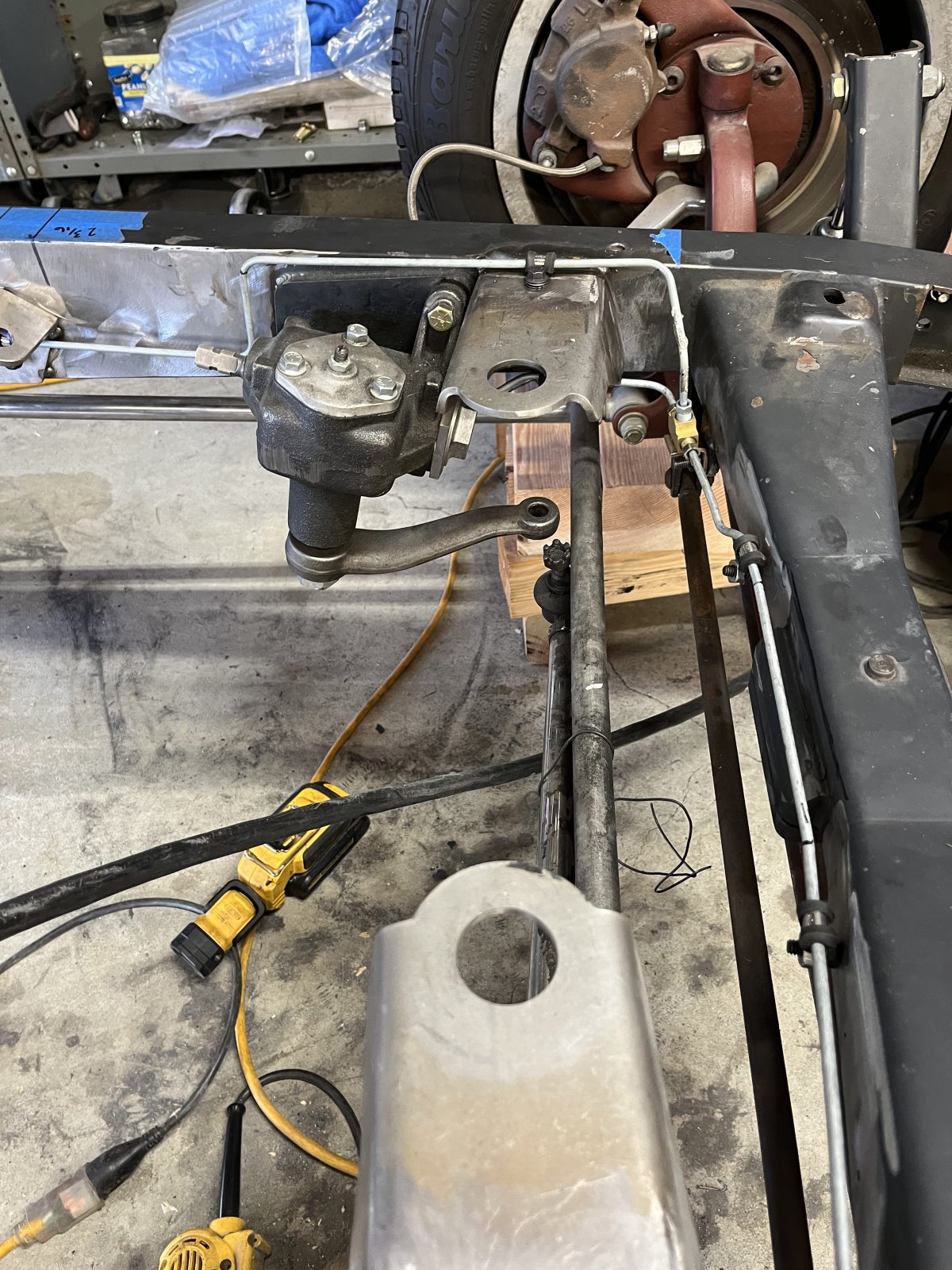

  25. i replaced my brake and fuel line on my '57 in august. . i used 3/16 on all of it.
    then after a lot of issues with master cylinders, i installed a dual master from a '67 mustang. for the rear line i capped the ends and pulled them through as opposed to flaring them off the car, i cut and flared the rear side the line on the car. i replaced (or refinished) every part of my brake system. after that i havent had any issues.
    pardon the rust... but hopefully its a some help despite being a tad newer. 20220807_190500.jpg 20230315_184959.jpg 20220807_190452.jpg 20220807_190440.jpg 20220807_190448.jpg
