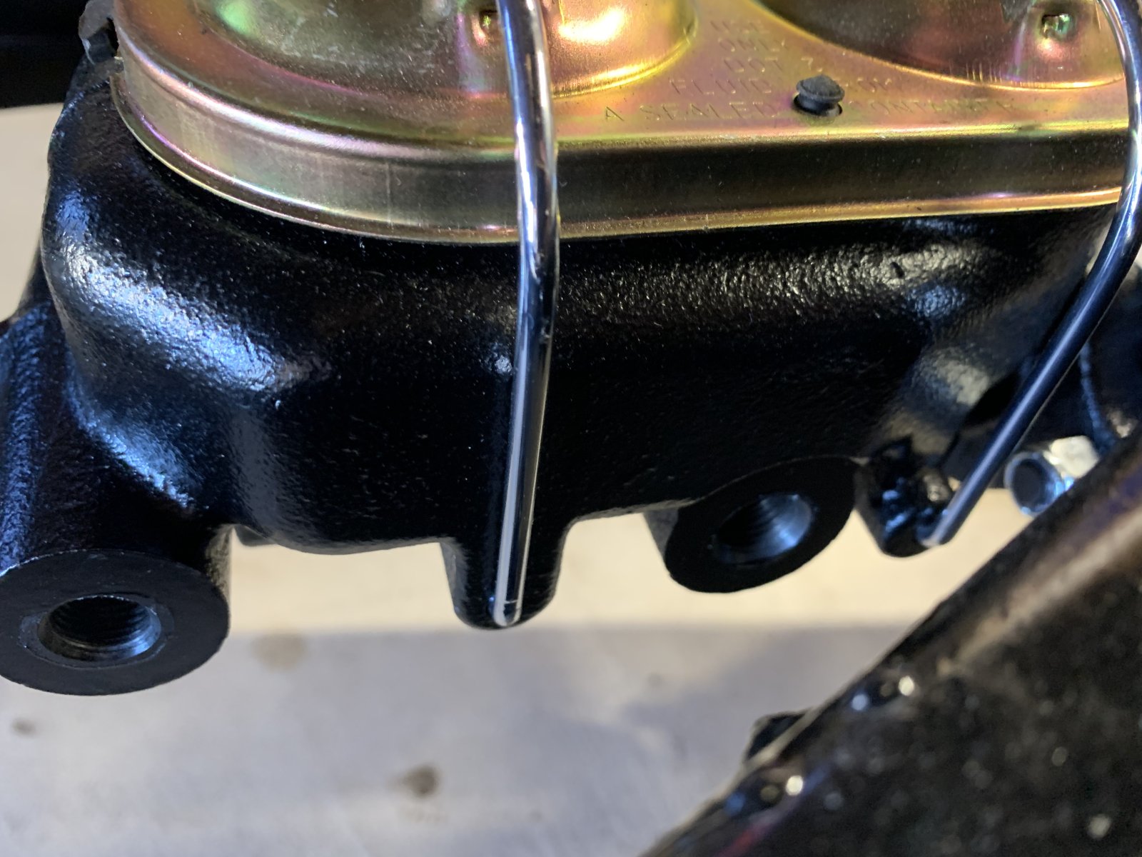

  10. That master has holes on both sides to make it more universal. Some cars have the brake lines on the inside and some do not. Plug your brake lines in where they work best and plug the others.
    The splitter is called a T. Too simple right?
    The residual valves go to the drum brakes. Usually the proportioning valve also goes to the rear brakes. The lower to ground and the less California Rake that you have the least need for proportioning. Perhaps better said the least front to rear brake bias is needed.
    When you get it installed fine a straight stretch of road that is pretty much deserted, get her tolling good and lock it up. Keep playing with the proportioning with the proportioning valve until you get the desired feel. I like my rears to just almost lock up but some guys like them to lock up for example.

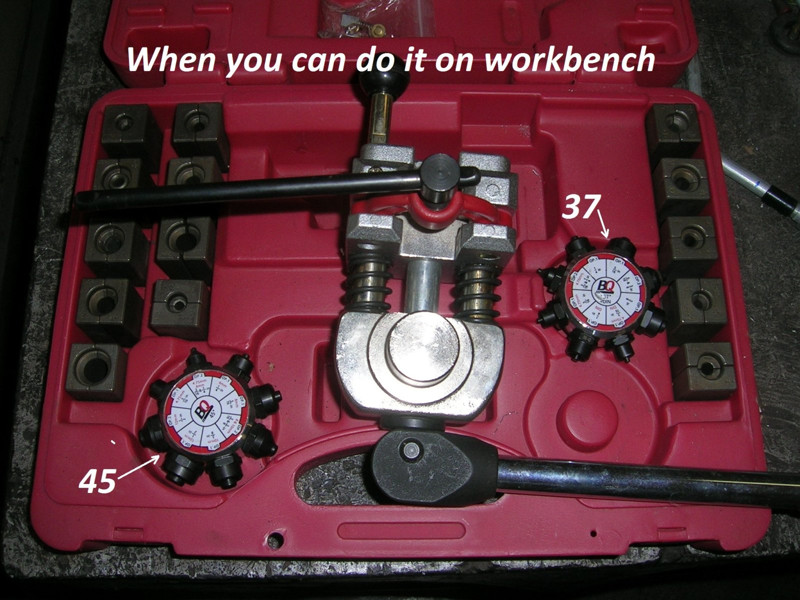

    Mike Colemire
    I like the bubble flares, 1 step and your done but the older stuff you use the double flares, wish I had one of the hyd flaring tools, I just have an old snap on deal.

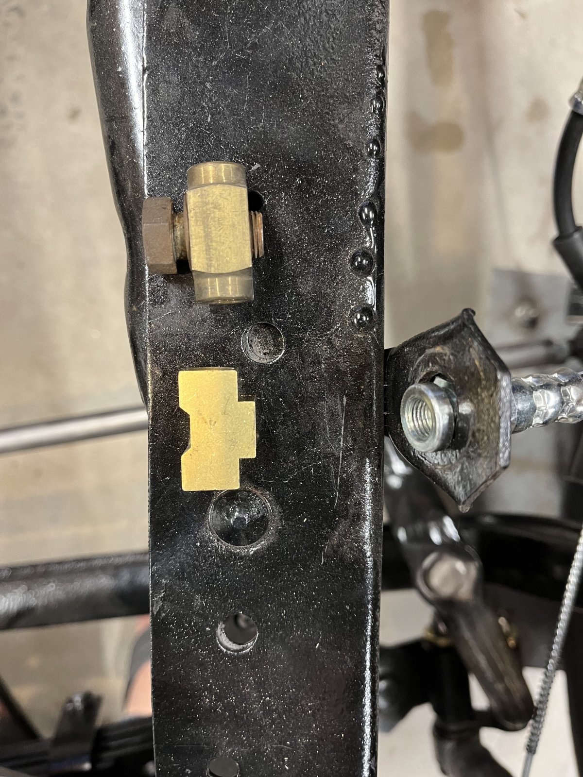

    Update and one more question.
    I have the rear all plumbed but I’m stumped on the front. Well, not stumped except for I really want to use a stock style Tee fitting on the front with a banjo bolt directly into the left front soft line (like stock). However, I can’t find this Tee fitting with a 3/16 tube size (I can find 1/4”
    Tube size). The photo below shows a generic Tee fitting I have along side the stock fitting with banjo bolt. I Don t like the generic because then I have to run a hard line from the soft line to the Tee fitting and it just doesn’t seem very clean and it’s one more line that I feel is unnecessary. A banjo Tee fitting would be so much better.
    Does anyone know where I can find a banjo fitting like this that works with the 3/16 line? Part number?

    The problem you are going to have with trying to mate a banjo style fitting to the end of that brake hose is the brake hose end surface isn't machined for it and would be prone to leakage. The inverted flare seat is the sealing surface that was machined for sealing. Plus even if you found a banjo bolt with the right threads the bolt may bottom out before holding the fitting to seal up. You could always soften the edges of the "generic" tee to make it look less blockish. And yes, this would require an extra line.

    nobby
    what just got me was the older style sykes pickavant non turret type flarer
    and the modern turret type
    and if you do get the 3/16 line for 3/8
    the later style is two on a spinning turret
    rather than one piece that you flip
    if you did just go and buy the older style, its impossible to find new dies.........
    is the usa sae double flare 45 dgrees as stated above.
    does the SAE and 45 degrees indicate american brake fittings?
    so - is the one stage 'convex' sae OP1 operation 1
    for if you like post 1978 metric chevy?
    so If I want to use a 24mm metric chevrolet aluminium brake master
    i simply need to go from m11 master ports to to the combination valve
    sae double flare inch with 3/16 brake line.

    RICH B
    See if Edelmann 121034 tube nuts will work for you, 3/16" tube x 1/4" flare nut.

    from Georgia
    For the fitting on the master cylinder you may be able to find someone on the 67-72 Chevy Truck forum who is getting rid of their original stuff.
