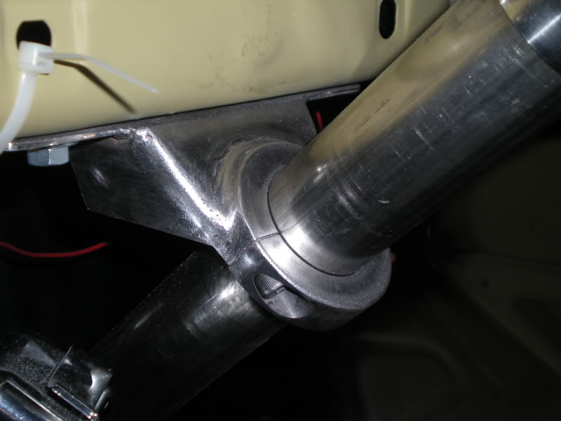

    I have been working on the sedan and finished up the new mounts For the front seat and have gained 6 more inches of leg room and now I need to raise the steering column up.
    I have no intention of changing the steering column and I ***ume it's a early GM van tilt column and the column drop is one of those swinging billet pieces painted black and not that offensive but I need the column to be higher.
    I am open to creative ideas. HRP
    This is what it looks like now with the exception of it being painted black.
    In the car......

  3. Weld it up and drill a new hole?

    All the Limeworks drops are designed for original or their aftermarket columns. HRP

    You know,welding it up is not even a consideration but the idea of drilling a new hole higher in the drop and cutting the old original hole off might be something to think about. HRP

    So cal makes one that a guy can open the hole up for a bigger column.

    I always thought an aluminum connecting rod looked good for column drop on old school type rod. If you can't find one that you can modify to fit, machine one up from 6061 stock.

    If the two pieces of the support separate. Cut it down re cut the notches and screw it back together.

    Check Speedway they have shorter drops that look similar in style to that one.

    Can you unbolt the lower section that has the whole and make a new lower half and bolt back up.

    HRP, what's your steering column's diameter?

    2 inch. HRP

    Maybe, just shorten the top and use flathead screws for the pivot, so you don't have to counterbore for the original allen bolts

    Aluminum piston rod

    ...with a 2" rod bearing diameter... Probably something with a small displacement. Nobody would have to known where it came from.

    As for 'raising the column', I'd slice a horizontal section out of the mount body, and weld it back together. Grind and file like it never happened! ...and paint it again...

    You can make one like this in any size you want — simple and very traditional.
  24. My next question will be will it move enough at the underside of the floor between the column end and the box? Or will you need to move the hole in the floor too, you know so the foot has more room to get at the new brake pedal position?

    Try to find one for SBC, big end 2.0 or 2.100 journal size, know for sure they were made for the 2.100

    Section your current drop
    Engine man, The37Kid and HOTRODPRIMER like this.
  27. His OD is 2", need smaller like a 1.89 Honda connecting rod without the bearing.

    If you are going to paint it black anyhow why not a SJ SBC rod?Just put a set of bearing inserts in it.If you wanted to fancy it up you could tap the bolt holes in the rod and run stainless allen bolts.
