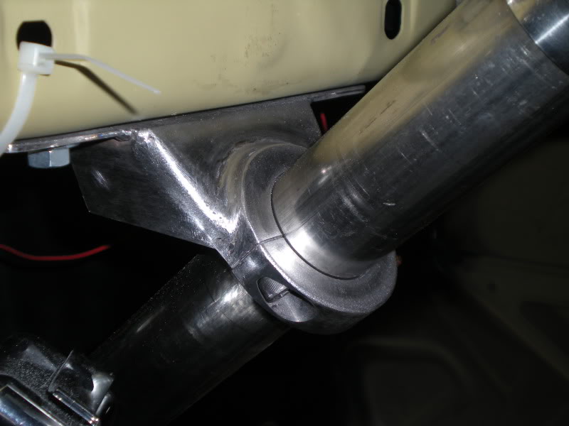

    Flathead connecting rod. Since this photo, I moved the drop back (to the new steel brace behind the dash), and up, moving the column, and the wheel towards the dash, and up. A dozen guys here can tell you the ID of the rod, but it's the same as the T'bird column.

    hotrods_0090.jpg I used an old SBC LJ ally rod on an early Falcon column.. works ok

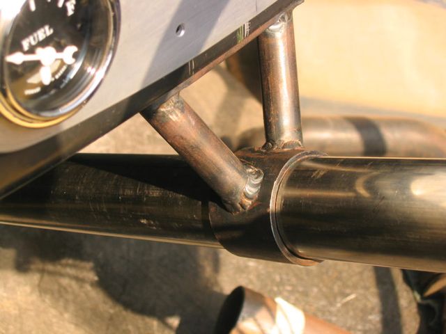

    mine's definetely different alright.....an old lug wrench cut down, heated and bent to fit my offset, slanted needs. 34drop3.jpg 34drop.jpg

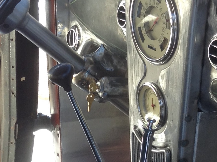

    image.jpeg This is a Model A, had to come up with something to cover the wiring out of the column. So I made a cover over the original column drop.

    That drop along with the dash extension looks nice,it has a Zephyr look to it. HRP
