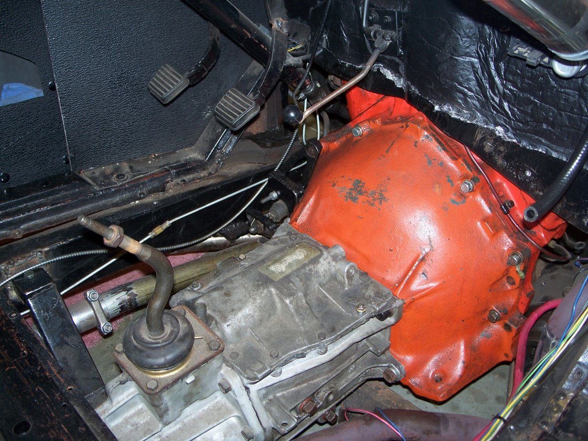

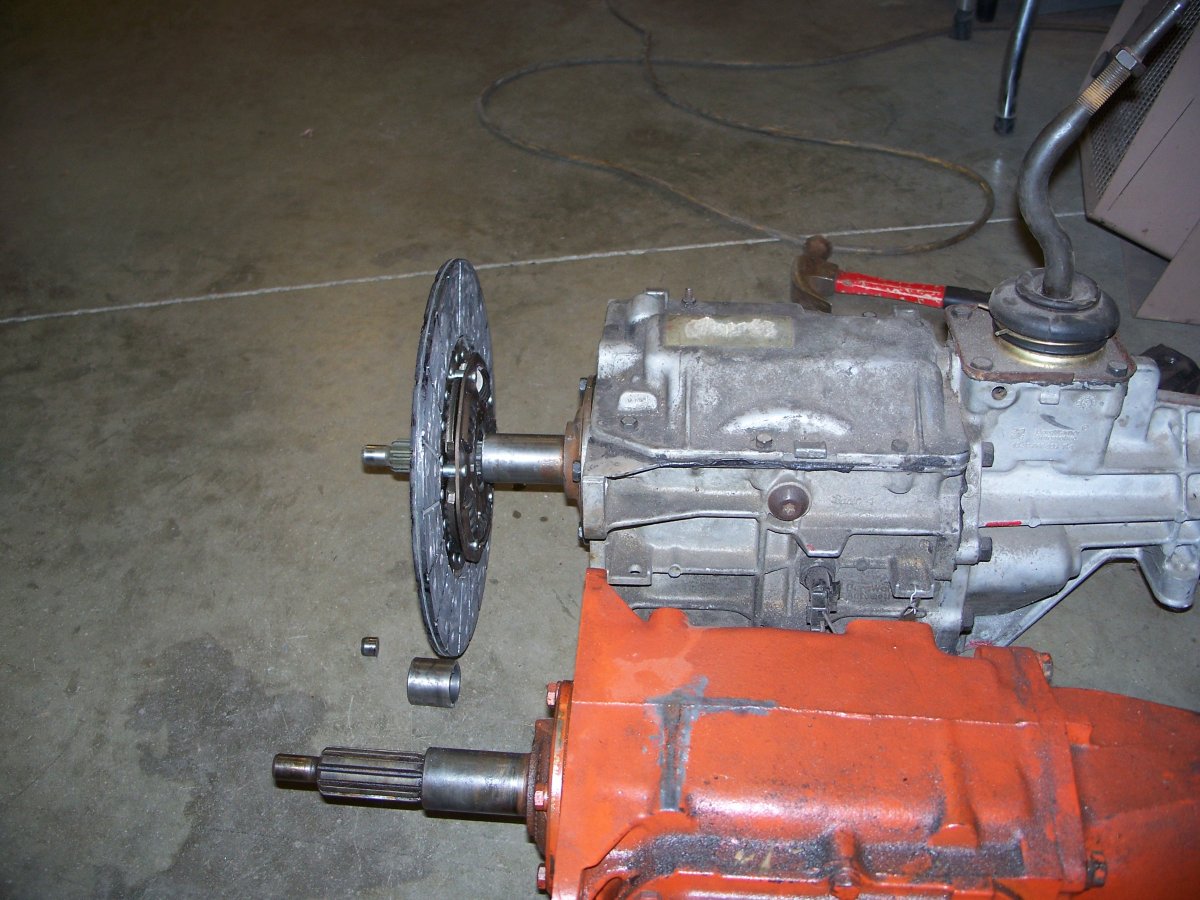

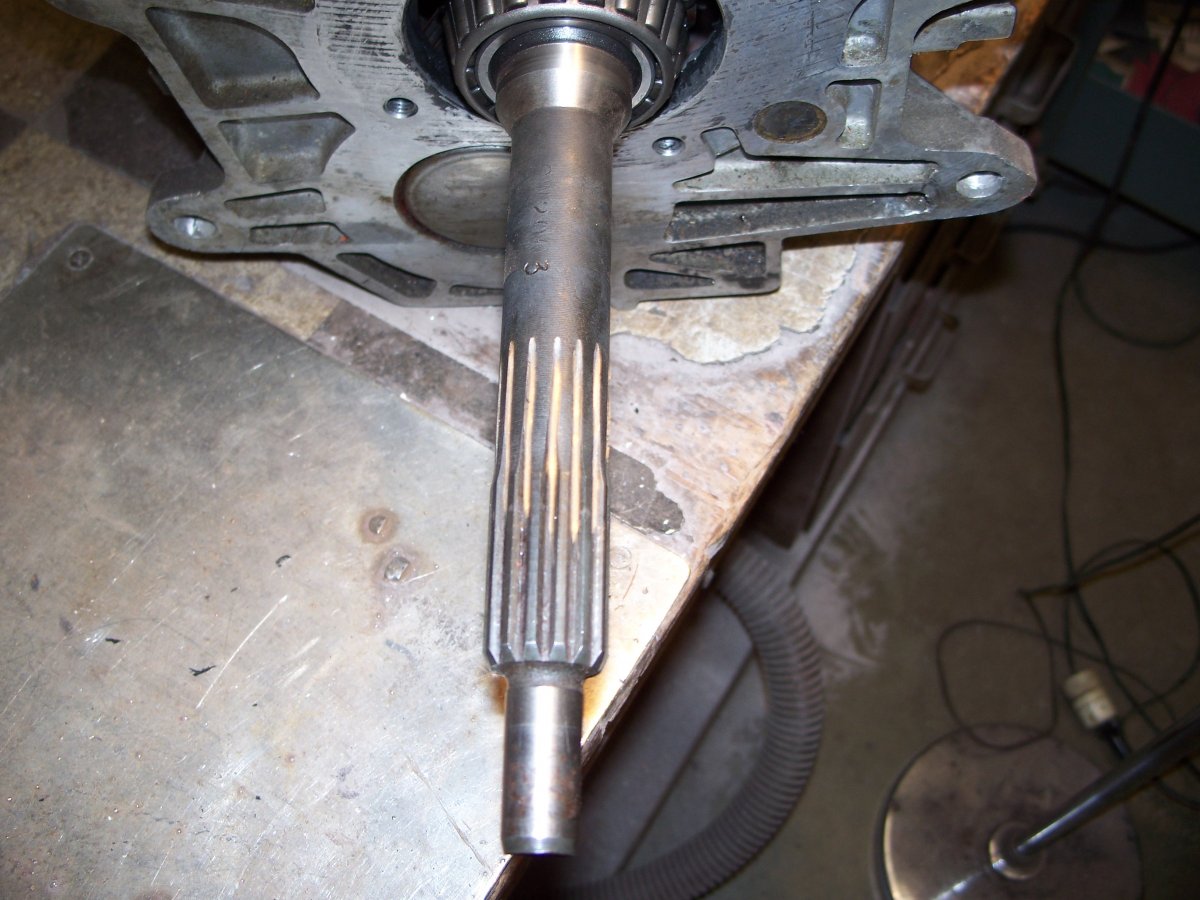

    Extend splines using a cutoff wheel.. Cut end of input shaft and housing.. (Can't remember the exact amount so measure off Saginaw 3 or 4 spd).. Get GM "M" van clutch disc.. You're ready to go...**clic pic** T5 install 001.JPG T5 install 007.JPG T5 install 008.JPG T5 install 009.JPG
