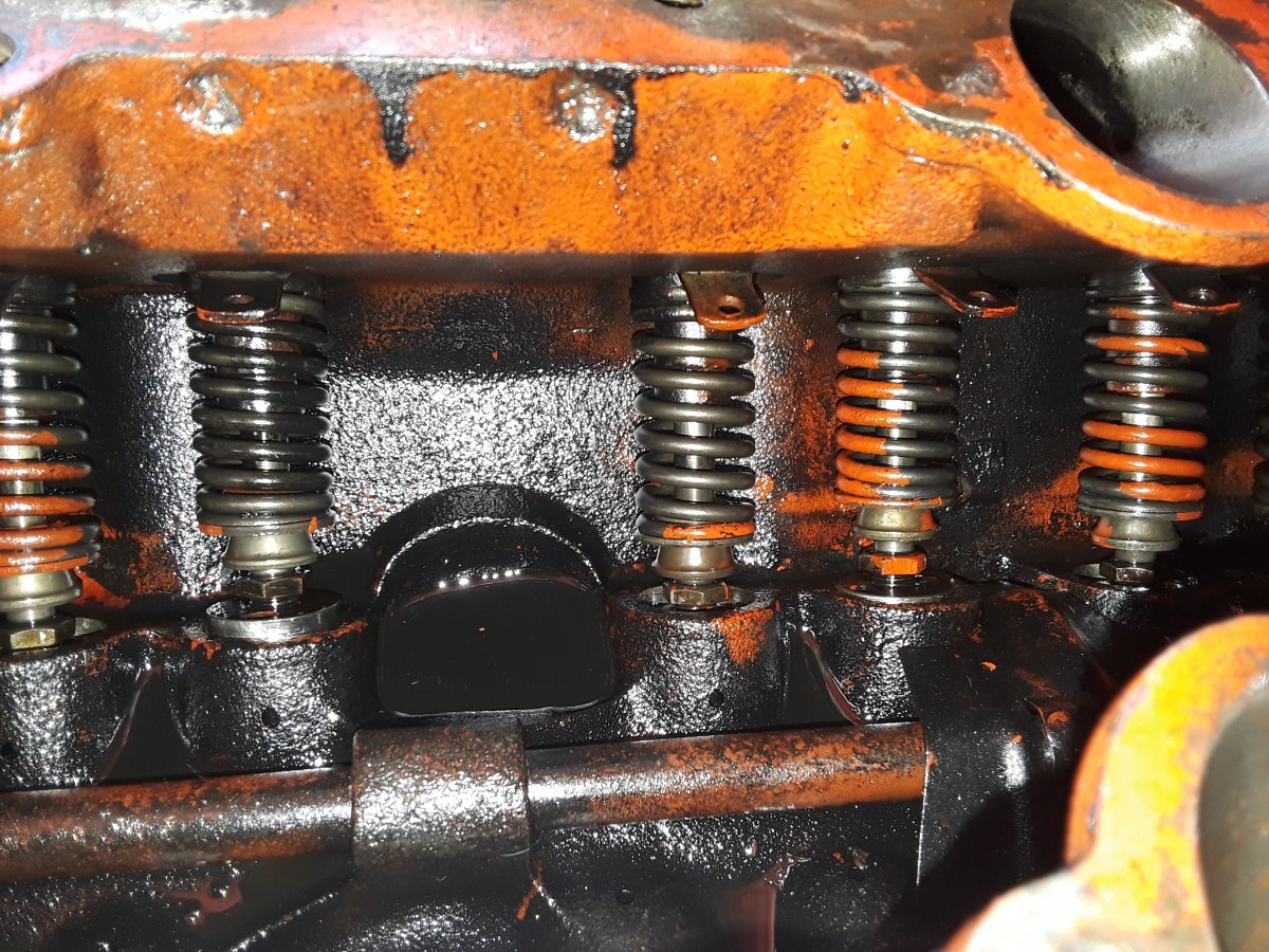

    Thanks for chiming in Adam! I think I'm gonna go with your advice and just keep the mm oil in the gas tank only. It does have adjustable tappets. 20201015_113555.jpg

    Did you check the valve lash on that cylinder while the intake was off

    I didn't physically get a feeler gauge in there but I did notice a small gap between the valve stem and the adjuster while on the lowest point of the cam lobe.

    I'm going to pull the head and check the valve seats. I blasted the mm oil out from the #6 hole today (sat in the hole over night), did a cold compression test, and was able to reach almost 100 lbs. I put the top of the engine back together, fired it off, and drove it around (actually ran better). Checked the compression in #6 while the engine was hot and I was barely able to reach 50 lbs. I'm pulling more toward frozen rings. Won't know for sure until I check the seats. Any other feedback on that note is appreciated....
