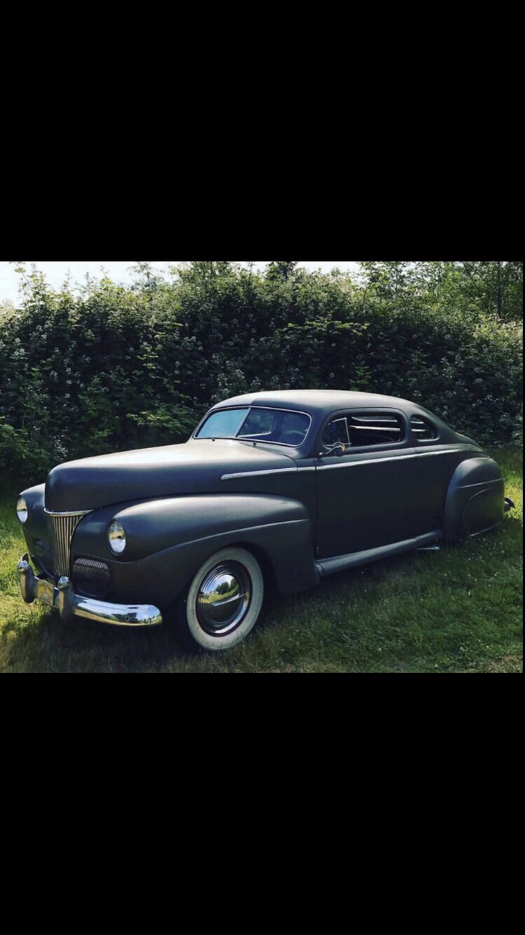

    Here’s my old 47 long door that I put a 41 nose on
    I personally like the long door coupe chopped, 39DFC036-CBCE-43E7-8925-9B1769A8E147.png 783C9C43-15B1-4018-898F-08E437FF73BF.png but to each his own
