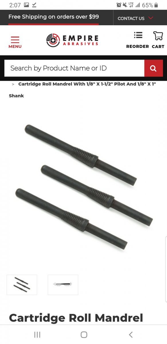

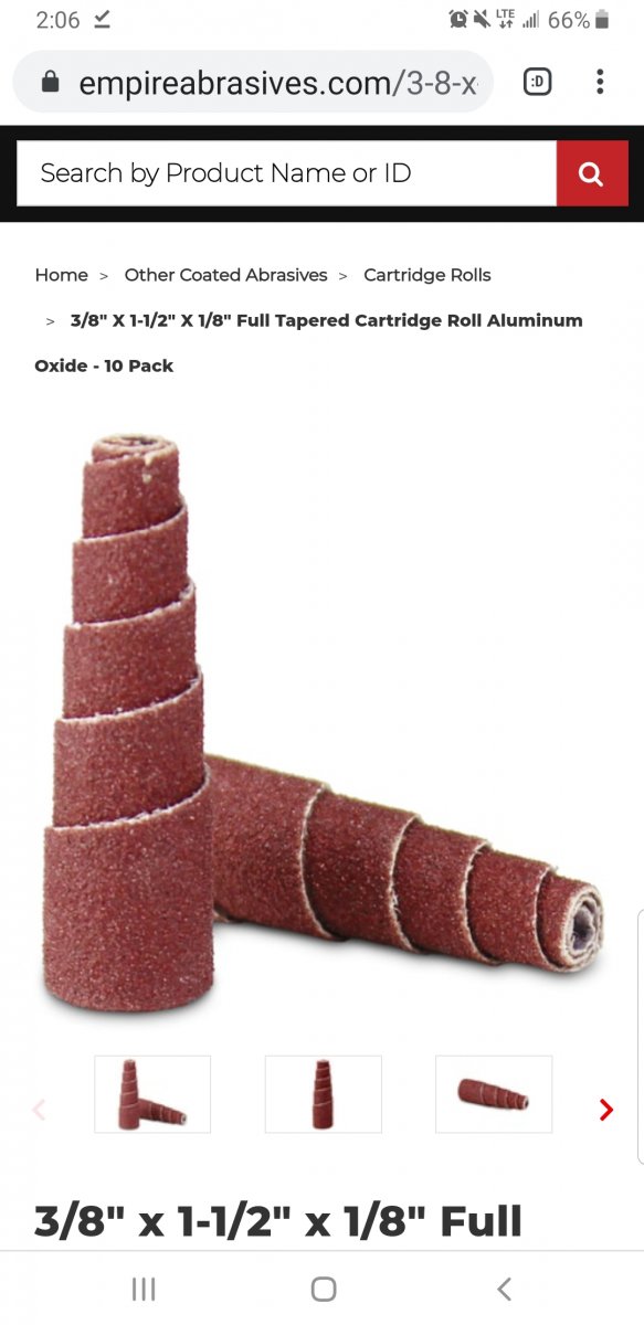

    I've never done Louvers but perhaps wrapping the sandpaper around different diameter rod, pattern files, etc. and using that instead of your fingers might preserve your skin and precious blood...
    Perhaps a dremel type tool with it numerous types of abrasives might ***ist as well...
    In Aviation we used to use a disposable conical (Cone Shaped) sanding roll that you turned onto a threadlike arbor with a 1/4" shaft that came in many different sizes and grits that could again work and keep the flesh away...
    https://www.empireabrasives.com/cartridge-roll-mandrel-with-1-8-x-1-1-2-pilot-and-1-8-x-1-shank/##

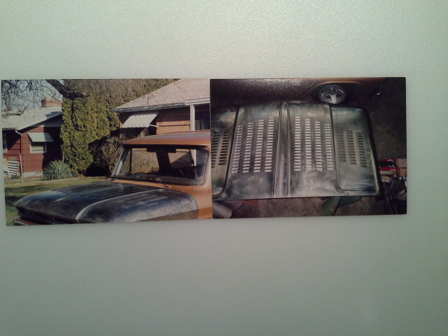

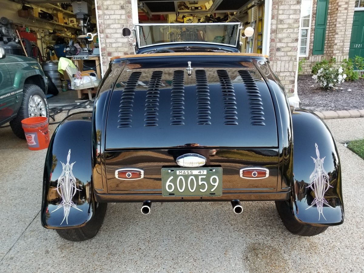

    The best thing I have seen to use on louvers is your good old fingers. Nothing else I found worked as well on the louvers I did on my car. Good news is you won't be picking your nose anymore when your done as your fingers will be down to stubs!
