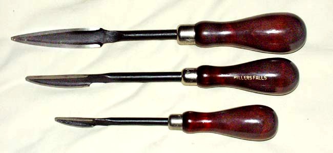

  13. The37Kid
    Joined: Apr 30, 2004
    Posts: 32,350
    The37Kid
    Babbit scrapers were used to fit crankshaft bearings in the 1920- 1930's would work fine on aluminum as deburring tools. Bob

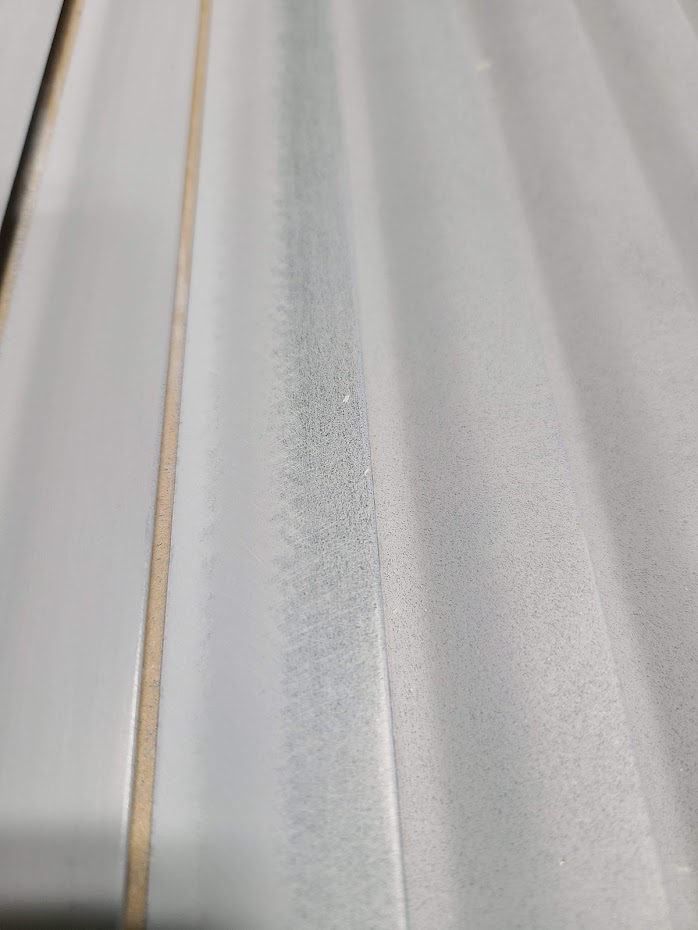

    Time and patience. Sand away from the louver, so you don't wind up with a trough at the bottom of the louver and you lose the hard lines. Easily had 50-60 hours sanding these out ,from start to finish. Good luck. I feel your pain. 20200801_094723 (1).jpg 20200801_095057.jpg 20200731_153159 (1).jpg 20200731_183919.jpg 20201107_133219 (1).jpg
