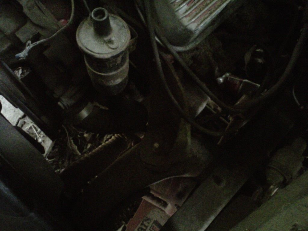

    1968 302
    I'm not too crazy about this engine mount. It is mounted to the flathead mount with brackets bolted to each engine head. I think I need to replace this with a proper cross member mount.

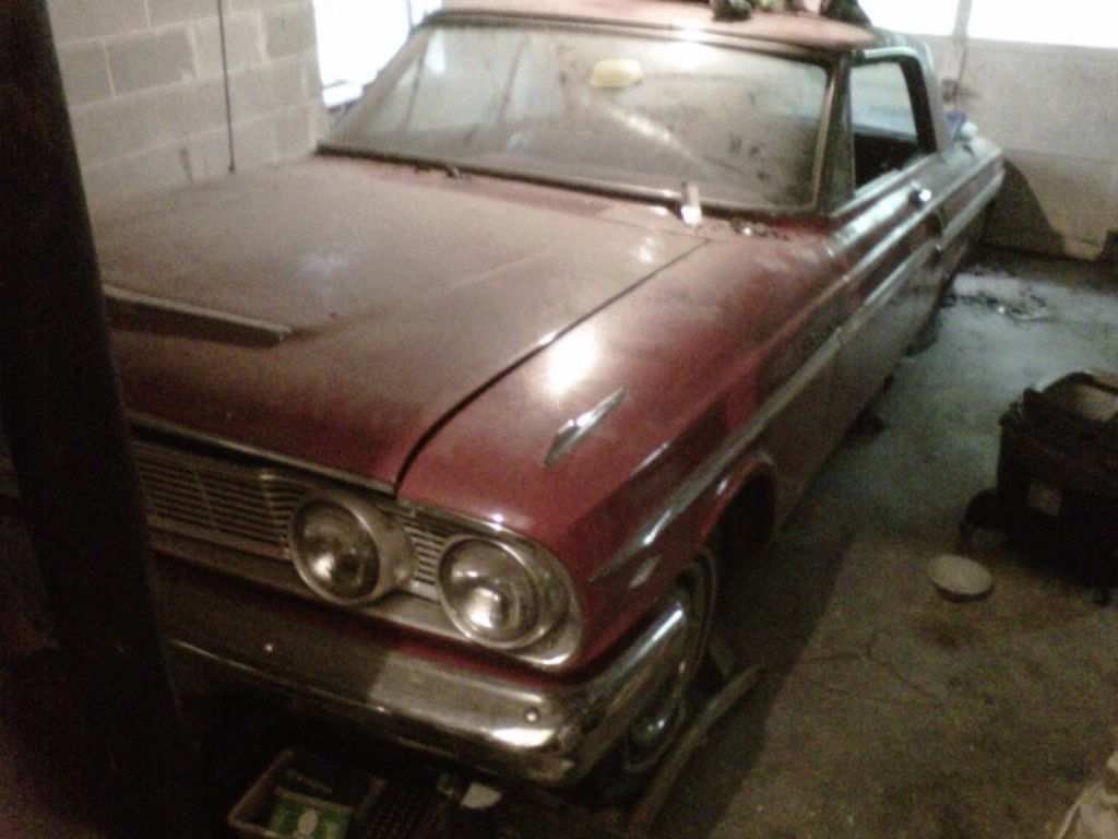

    1964 Ford Fairlane
    Mayor Daly's signature on a what remains of a 1966 City of Chicago parking decal. I wonder if he voted in the last election? Fortunately the O.O. was in the military and probably did not drive it much up there as the car is really rust free.
    Not a good pic but I would like to run dog dishes and trim rings.
    The remains of a white vinyl top. I like the looks of them but I may just paint the top white instead of going with the vinyl top. I have not decided. Until I got this car I did not know such was optional on Fairlanes in 64.
    The Fairlane has been dormant since 1977 or 80. To run it needs the engine rebuilt, transmission rebuilt or at least new seals, power steering rebuilt, new brakes, new drums, wirring???,gas tank, tires and two new taillight lenses.
    As you can see both are extremely dirty but I thought you might enjoy seeing the starting point. I go back and fourth about which one to start on first. I feel the truck may can be done fairly easily as the engine should be good.

    I'd get the truck up and operational and have fun driving it while I worked on the Fairlane. You will need a truck to haul stuff to the machine shop for that any way. It doesn't sound like you have too much work to get it up and functional, not hing that a few weeks and a few hundred dollars won't solve. The mounts are original Hurst brand or a good copy thereof, and depending on what has been done for a trans and trans mount ahould work fine with possibly the addition of some stabilizing mounts at the bell housing. If the stock trans crossmember has been removed you do have some more work involved though.

    I have a bell housing adapter, 6bolt SBF to early 1939/F-1 transmission. I'm using the f-1 pressure plate and throwout bearing. So I'm using the original transmission mounts with the original transmission. The 302 is mounted like a flathead with the above mentioned mounts. They are well made but a little unfinished cosmetically.
    I've never had problems with engine movement as it's really secure. It's much more secure than some of the front motor mount set ups I have seen on GM engines.
    I had a 55 1st GMC with homemade front mounts adapted to a 1970 300HP 350 that had a dog chain around the frame and exhaust manifold to keep the engine from twisting out of the frame. If you revved the engine it would twist and hit the floorboard and firewall. It had cracked the H-400's bell housing. That mount was quickly replaced by a cross member.
    It's good to know that the mount on the F-1 was made commercially or based on such.
