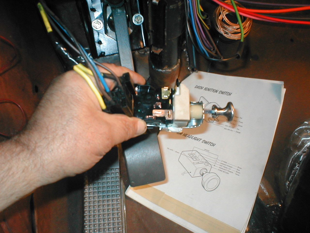

    Seems the reason that I had no front park lights is that they are somehow controlled from the dash light dimmer rheostat segment of the switch. When set in the dome light 'on' position I have full front park lights. They dim when you turn the switch, as would be normal of instrument lights. So... do I not have this switch wired correctly? Is the diagram wrong? photos from today.

    My eyesight not the best on your pics, but something must be wired wrong.
    Use a test light to see what the terminals do, on each position of the switch.
    Your park lights should be a different terminal than tail lights, because park lights should go out as you change to headlights on.
    So, the park light terminal should be the only terminal that lights up "only when in the park position, which is one half way out to the first click"
  7. F&J
    Joined: Apr 5, 2007
    Posts: 13,291
    F&J
    You will fix this today I bet :)
    Hopefully the diagram is correct on just the main power input wire.
    Leave that one on, take all the other wires off.
    - test each terminal in each position to see what each one does.
    -dash lights go to the term that changes with reostat.
    -tail lights go to the term that gets power on first AND last click
    -Headlight feed to foot dimmer, goes to term that only comes on at 2nd full click out
    -park lights go to term that only comes on at first half click.
    get all the above lights working before messing with the dome light wire...leave that wire off for now

    So did you replace the headlight switch? or are you still using the one that smoked?
    I know when I wired my headlight switch up, the switch had a different pin out then what the included instructions said.
    Finally found a diagram online of my switch and it fixed the problems.
    I just seen you used the same harness/switch as me. Let me get some pics of mine for you to see.

    OKay here we go. The parking light wires are wrong between the Rebel diagram and your switch. Not sure whos fault it is, the wire or the switch but here is mine and everything works. On the plus the colors will match your harness exactly. The big orange "ignition" wire was only used as the splice.
    If you need to see full size (super size) pics go here:
    http://www.netquickposse.org/photos/index.php?album=bucket3
    Hope this helps you out. Drove me nuts trying to figure this out.

    What is the white wire? I don't got no white wire!
  13. Keep
    Joined: May 10, 2008
    Posts: 662
    Keep
    Sorry thats the light for my tach!
  14. unkamort
    Joined: Sep 8, 2006
    Posts: 1,012
    unkamort
    OK... I have the small brown on that terminal ... dose your tach light dim with the dash lights?
  15. Keep
    Posts: 662
    Keep
    Yes it does. I have my gauge lights connected to that as well.
  16. unkamort
    Joined: Sep 8, 2006
    Posts: 1,012
    unkamort
    so this diagram is wrong
  17. Keep
    Posts: 662
    Keep
    Yup. Like I said, its either that diagram, or the switch itself.
    Not sure if its a different switch supplier? But I did the same as you, fought for a while. I will see if I can track down the other diagram I found that pointed me in the right direction.
  18. Keep
    Posts: 662
    Keep
    Its the diagram. Search for "GM 7 pin headlight switch" and you will see a bunch that point you to the right wiring. There seems to be two versions of this switch. One that matches the Rebel diagram. And another that does not.
    Wonder if there was a change somewhere along the line that is not documented.
  19. unkamort
    Joined: Sep 8, 2006
    Posts: 1,012
    unkamort
    went down and changed it already... front park lights now control from the switch. Thank you sir, and thanks to all who have responded.
