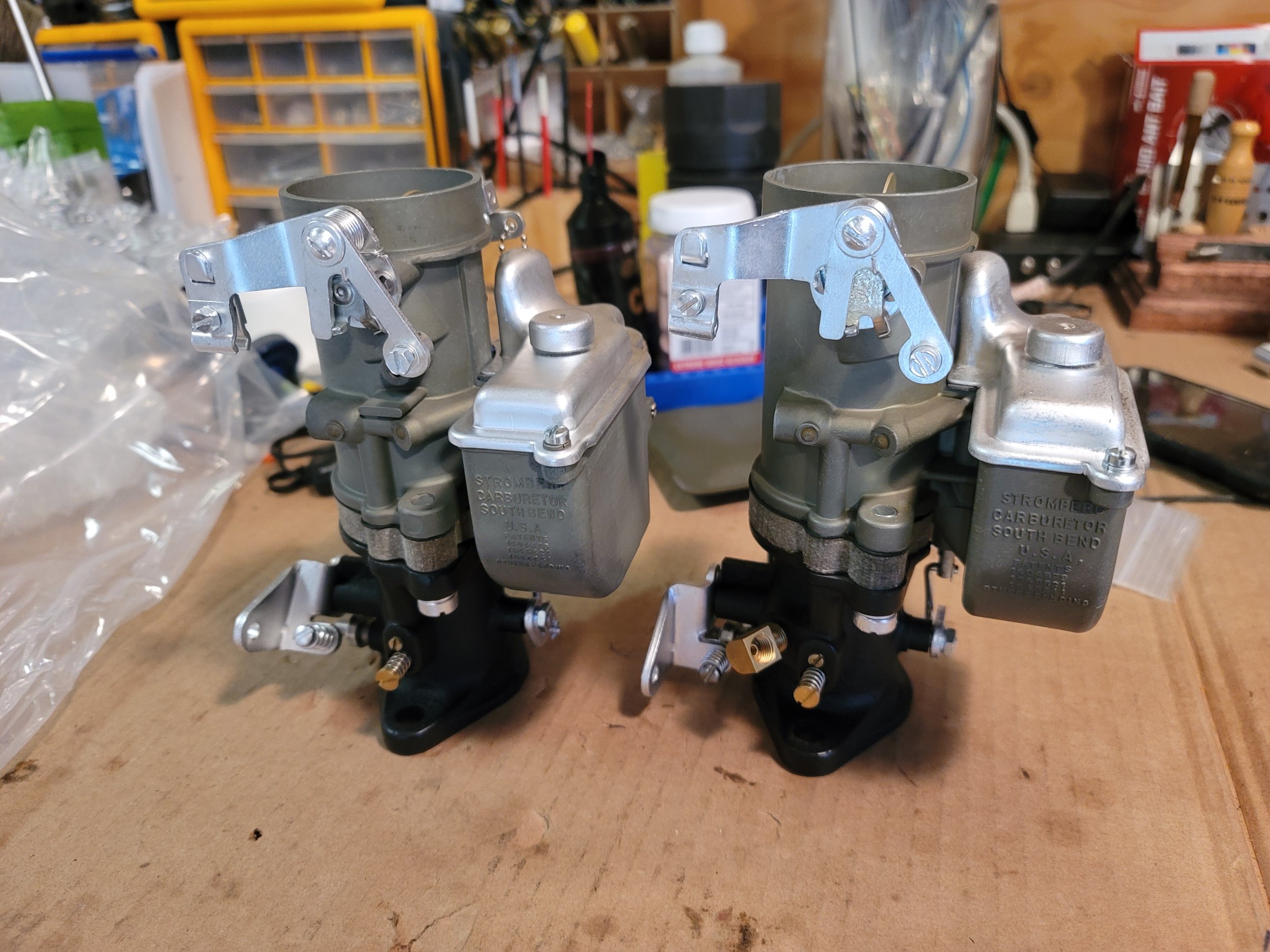

  4. Semmerling
    Joined: Jan 6, 2022
    Posts: 30
    Semmerling
    20250215_130330.jpg Yes, Single barrel carbs, just like the ***le says.
    In this case these restored older Strombergs with 1 1/2" id throat to the later Thickstun Dodge dual manifold with the slightly larger 1.65"
    Thanks for the help, didnt see an offering on the Speedway Motors site.

  6. 1952henry
    Joined: Jan 8, 2006
    Posts: 1,598
    1952henry
    No help from me, but have to say those carburetors look nice. No spray can wizard touched those.

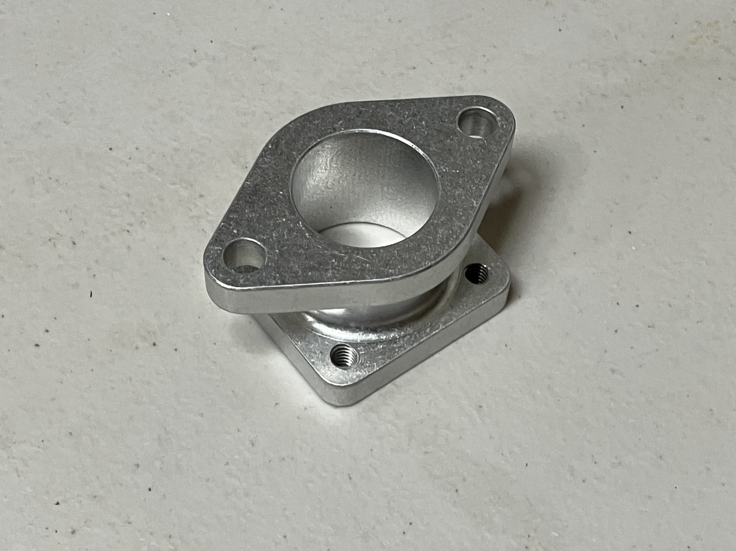

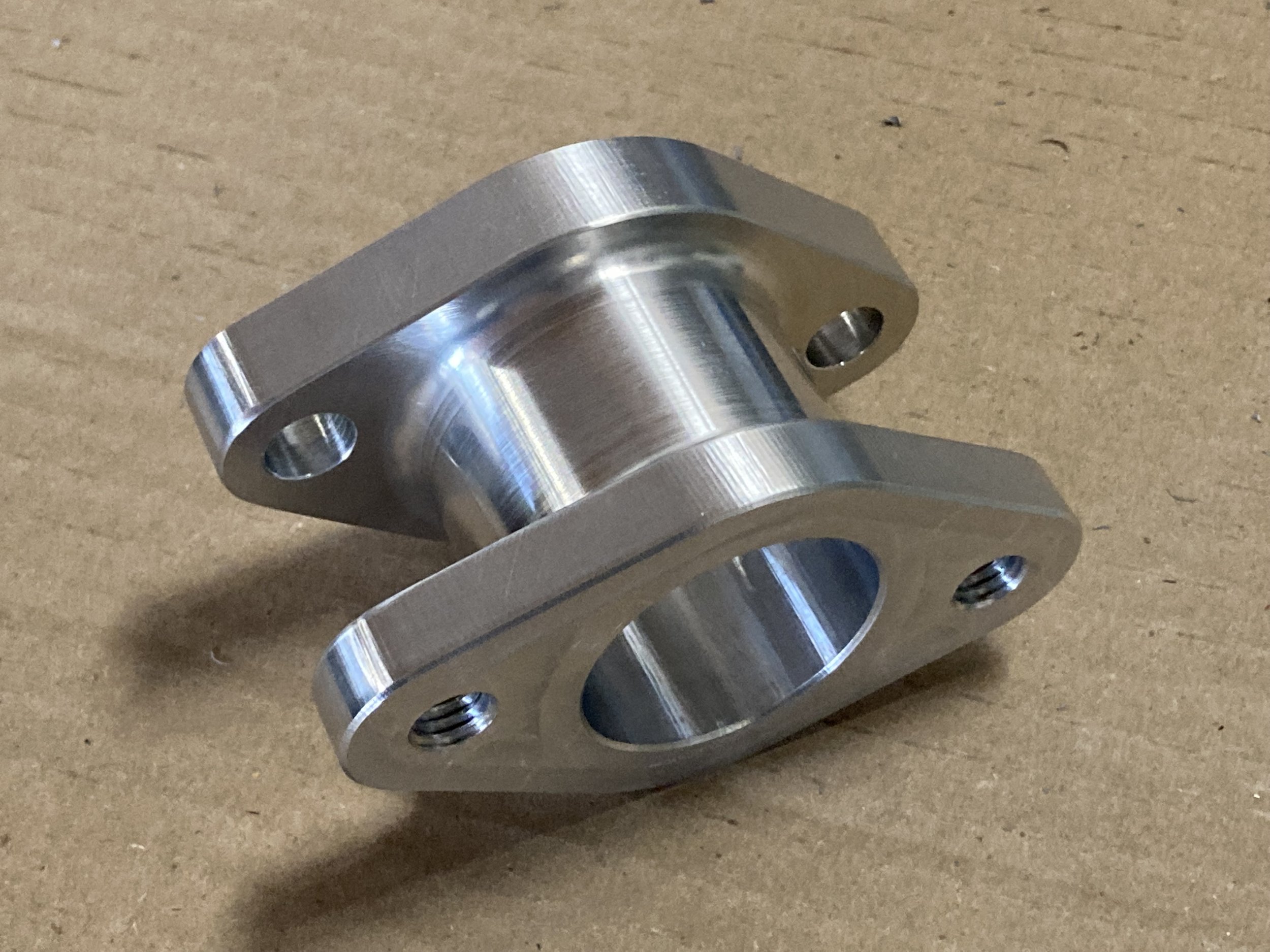

  8. Kevin Pharis
    Joined: Aug 22, 2020
    Posts: 724
    Kevin Pharis
    from Califunny
    I make several sizes of Winfield to 2 bolt adapters, and have made 2 bolt to 2 bolt adapters too. Some setups need the additional height, while others are better off with a flat plate style. Minimum height for this “drop flange” style is about 1-3/8”, but could be shorter if the flanges are not inline.
