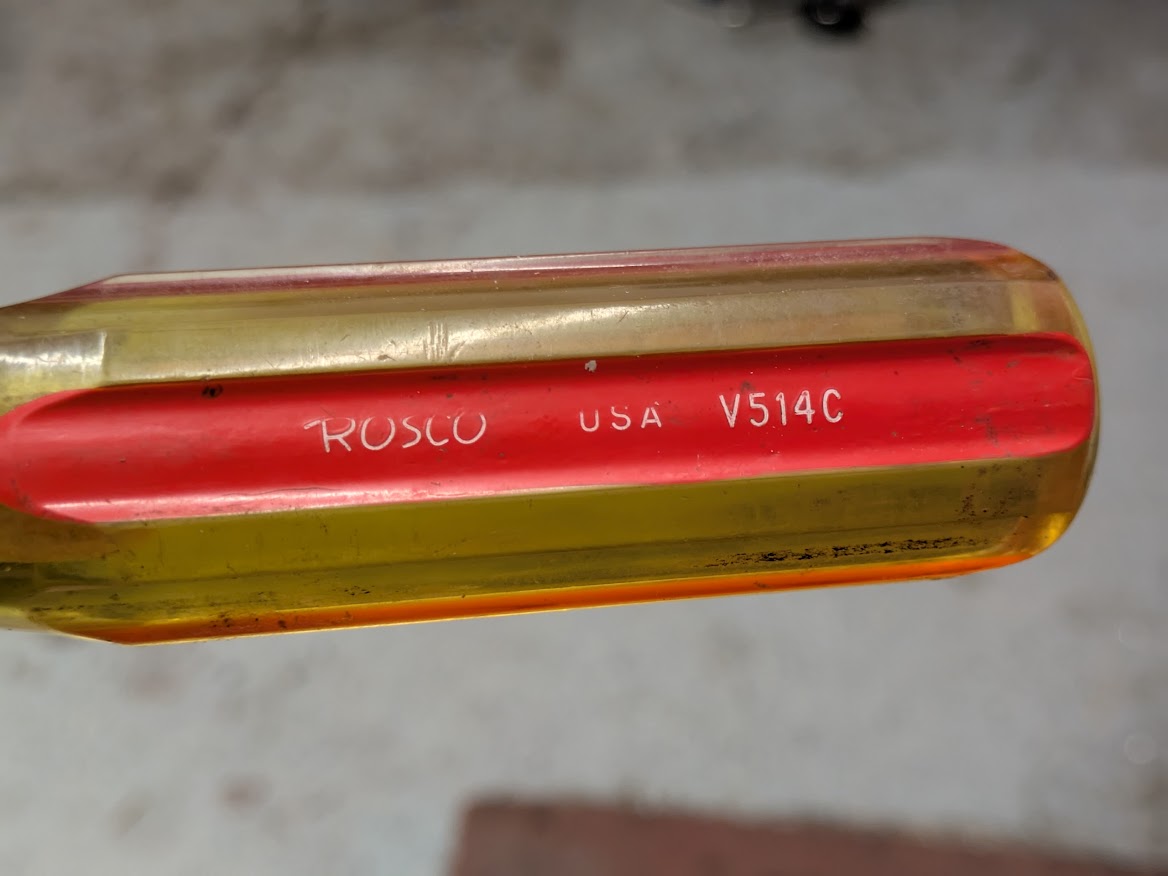

    If it's that screw, it might be 1/4". I have a very old driver that fits is perfectly, the driver measures 0.240" on it's major diameter.

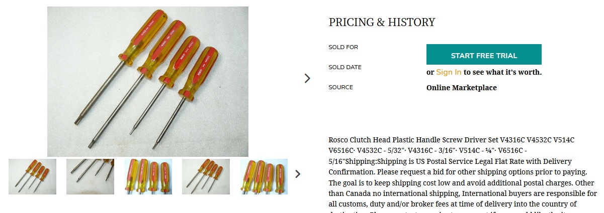

    according to this worthpoint auction save, it is 1/4". And that matches the apparent numbering system of the drivers.
