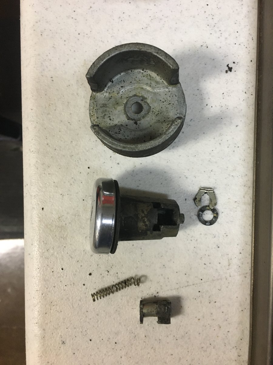

    So I was rolling my rear tail gate glass up and heard alittle pop/ crunch? Glass is about 2” up and want do anything now. The manual crank just freewheels in any position. I can’t get the gate open and can’t get the inside panel off with out the gate open? Not sure where to start? Was hoping someone has experienced this before and can shine some light on this. Thanks for the help

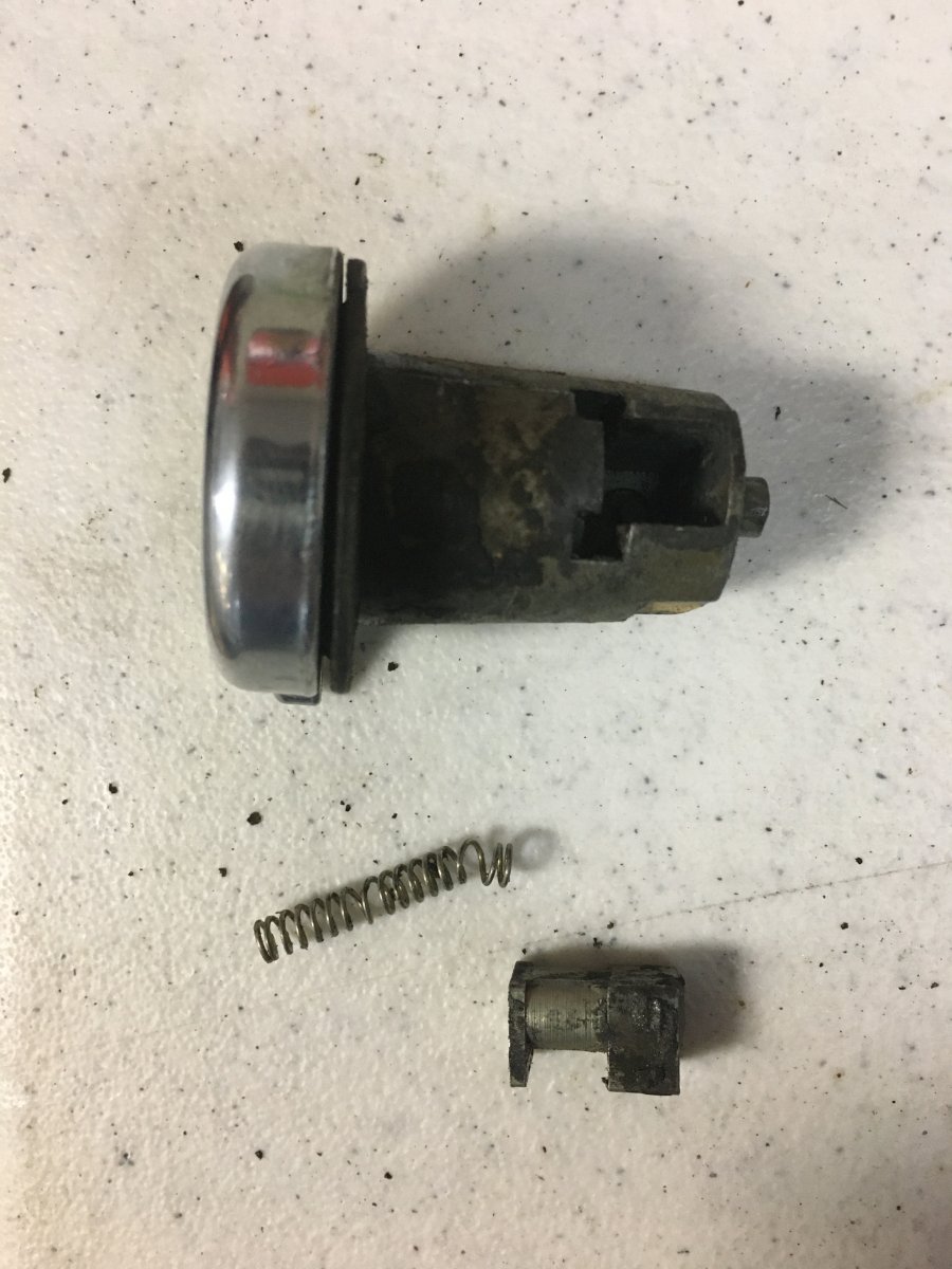

    If it’s anything like my 63 wagon I suspect the lock cylinder assembly. The main pieces are pot metal and subject to breaking.
    You may end up doing surgery on the interior panel so you can remove the crank mechanism/lock cylinder so you can then access the winder to lower the glass.

    Thanks for the encouraging words! I removed the two outer stainless window channels the window was only up about 2” thanks god. Three screws with side. They are glued on from the factory so quit a bit of prying to get loose. Then hooked both cables either side to get it unlatched. Once it’s open you can remove access panel, four bolt hold the glass in a frame to the regulator. Remove glass and then four screws hold regulator in place. Then you can access window crank held in by 3 nuts. The internal key cylinder/ key way broke which allows the crank to just free wheel. Not a real good design IMO. I if the window would have been up any more I wouldn’t have been able to get to all the screws. Guess I was lucky!
