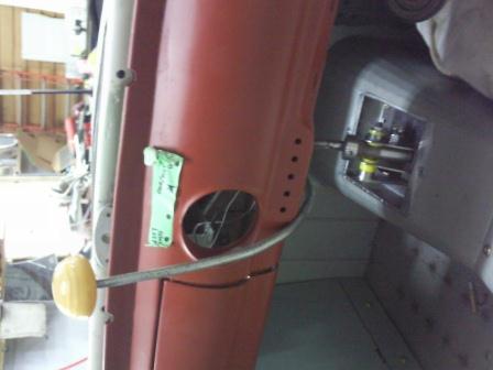

    I had an old 3 speed manual box on the back of an old flatty motor. I had been eyeing up the shift lever on that to use because it is tapered from 5/8" at the base to 5/16" at the top and is forged too. After some careful disassembly (rather than chopping it off like I was going to do!) I found that it would work out well with the tapered lower part as well (more on that later)
    I had a look at the store bought shiney shifter that I had and took a few basic measurements from that and the old lever, then set to and drew out what would be needed to make it all work.
    I am using a 2 speed Buick Dual Path trans behind a 215" Aluminium V8, and as such there aren't a heck of a lot of aftermarket parts in the shops for these.
    I had a scratch through the steel bin to see what was available for raw materials, and settled on a piece of 3mm (1/8") pressed channel and some bits of round stock.
    Some marking out followed by some hacksaw and filing later I had the main side plates basically sorted. So It was off to Dads' to spend some time on the lathe, spinning up the main pivot, cross shaft and some bushes to let it all pivot smoothly.
    To enable to see how it was all going to fit in the car, I made up a dummy trans tunnel piece with no sides for starters. This meant I could sort out the lever position and the linkage onto the trans itself, before cutting into the actual trans tunnel later in the job.
    I will throw in a few photos to help explain my ramblings.

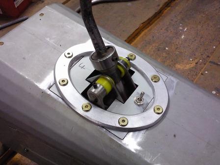

    Once happy with the way everything was fitting with the dummy tunnel, I set about making up a recess to go into the actual tunnel. To fasten the shifter into the recess I have used RIVNUTs. But to get the base of the shifter to sit flat on the recess I had to make up a dimpling Die and press individual recesses for the fastenings to sit down into.

  3. To enable the shifter to work properly with the bazar Buick selector pattern ( P N D L R ) and not be able to drag it back into reverse when in low gear with my foot hard up it, I had to have a series of "Gates". To do this I made up a curved plate to go under the main pivot tube, with a cut gate. I have also set up an inhibitor switch on the side of the shifter so it will only start in park or neutral. Just a simple ball type switch, actuated by the main pivot as it moves back and forth.
    The original 1939 gear lever I used had a taper on the bottom end which enabled it to pivot sideways inside the main tube. So by pulling the lever gently to the side when moving forward and back you are able to move through the gates. But not able to inadvertently select reverse, without trying hard!
    Once I was happy with how things were working out, I made the oval piece to hold down the leather boot which will cover up all my hard work.
    After getting things working out of the car I had to bend the shift lever to fit around the dashboard when in park and allow space for reaching reverse without hitting the centre console/trans tunnel. To do this I made up a buck from wood and got at it with the gas torch until things fit nicely.
    I am pleased with the way this little project has turned out and plan to pull it all to bits and send it away for Cadmium plating to keep it in good shape.

  12. Neat shifter, nice workmanship. I was wondering if you incorporated a spring or anything to keep it to one side in your gate?

    Yes I did. You can see it in the drawing I did. It is inside the main pivot shaft and is adjustable with the grub screw.

  23. Here is the drawing I put together before I started. It is pretty close to what I actually finished up with. The side plates are not as heavy as shown, only 1/8" not 1/4" as drawn, but otherwise pretty damn close.
    You can see the hole in the main pivot shaft where the spring is located. This spring holds pressure on the side of the shift lever, to keep it against the gates.
    The 1/4" pin that holds the shift lever, is drawn wrong in the colored elevation. I faces the otherway to allow sideways movement.......My bad!
