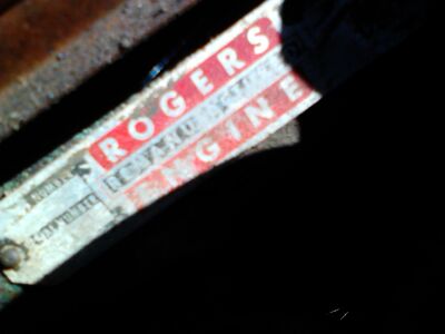

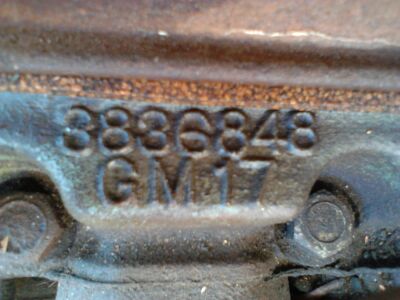

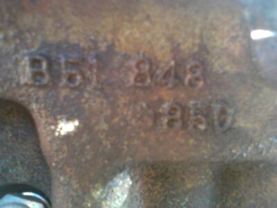

    A few more pics...
    At least it turned out to be a 235!

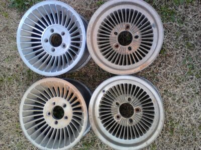

    Pulled from a long-forgotten, well-past rotten, 1953 210... Only fitting that they be given a new lease on life rolling beneath another '53 210. 14" Fenton front, 15" (Unknown) rear. Despite the difference in the number of fins between the 14s and 15s, they actually looked wicked-cool on the car they came off of.

    I agree. I think those wheels are going to look pretty darn sweet on her.

    Like I said, I pulled them from a 53, so I've already SEEN what they're going to look like. Trust me, they're gonna fly here.
