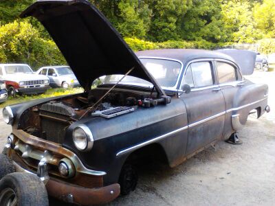

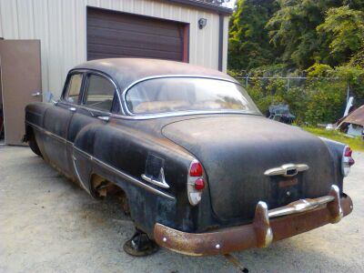

    So we had it up on jack stands this morning in order to finish up the brakes and play suggestive ping-pong concerning what to fill the aluminum lowering blocks with, and I decided I might as well crack out Mr. Sawzall and remove that pesky muffler that seemed to... muffle things. I'm not real bright, and I figured it would only take a few seconds, so I left it idling. No sooner than the muffler dropped off my decision was made. I would be running straight pipes. I tapped the accelerator a few times and carved my decision in stone. The little 235 sounds... mean!
    More to come as progress is made..!

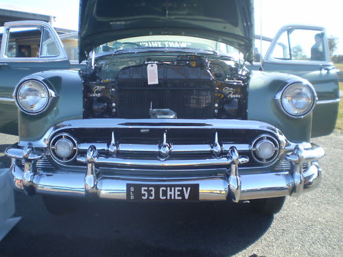

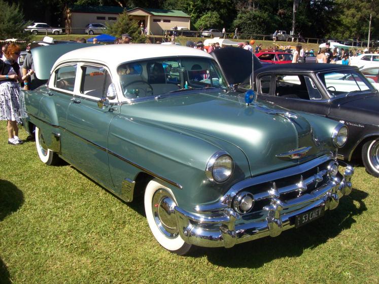

    Keep up the good work, four door are COOL.
    Here is mine.

    Thanks for the support, CW and Colin! I was starting to think nobody was even reading this thread. Nonetheless, I was updating it if for no other reason than to keep a running record of everything I had to do to get it rolling. I only HOPE my '53 looks HALF as nice as either of yours one day. I'm going the custom/hot rod route so the fam and I can have a little Saturday night fun once in a while, so it'll never be a show car. If I had the dough, it would be a good solid candidate for a full resto, but alas, I am just a poor boy "though my story's seldom told, I have squandered my resistance for a pocket full of mumbles, as were promises. All lies in jest, still a man hears what he wants to hear and disregards the rest..." Sorry, broken into a Simon and Garfunkel moment there...
    Thanks again! Hope y'all stick around, and PLEASE, feel free to throw in any comments, pointers, and suggestions!
