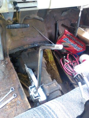

    Took the 3-speed shifter off the column today and put it on the floor. I know it's not everyone's cup-of-tea, but I've read thread after thread about the linkage from the column getting worn and binding up and having to occasionally free it up when it jams, and I really just prefer it on the floor anyway. Just need a cool shift knob. Anybody got one laying around they might wanna part with?
    Bled the brakes but didn't seat the new shoes first, so I hyper-extended the piston on the front p***enger side wheel cylinder. I figured, since I'll essentially have to rebuild the cylinder anyway, why not use new stuff, right? Picked up wheel cylinder rebuild kits for all four wheels, hoping to get it all hashed out and stopping on its own by COB Tuesday. Once the brakes are done, all I have to do is find the pressure switch that makes the brake lights light up and replace it, and throw some good rubber under it, and it's driving time!

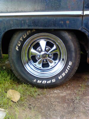

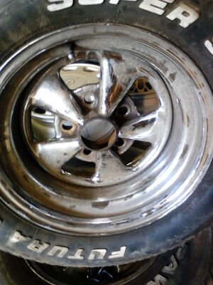

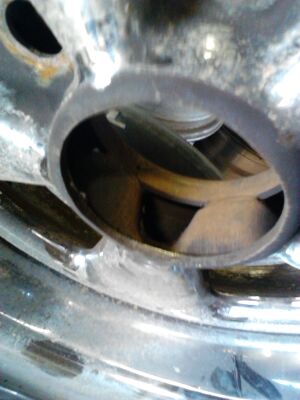

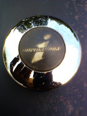

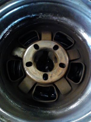

    MYSTERY WHEELS!!!
    I dropped by the local salvage yard this morning in hopes of scoring a set of decent matching 15" tires for my stock '53 steelies, which I finally finished in black epoxy paint this morning around 3AM. After walking the entire yard for about an hour and a half, I headed inside to chat up "Shorty", who pretty much deals with all the round rubber things that come across the scales. I told him what I was looking for, what size, and what condition, and he said that off the top of his head he didn't know of anything, but to stop back in around 4 o'clock and he would try to have something for me. Then, out of the corner of my eye, I see a tall stack of wheel and tire just off to my right... I think the chrome caught my attention.
    At first glance they looked like Cragar S/S wheels. Really wide ones. But when I flipped the top one over, it became apparent that they were NOT Cragars. I looked all over the inside, hit it with a wire brush, sprayed it with soapy water and wiped it dry... nothing. I can't find a single marking on the back of this wheel anywhere. I'm betting it is on the outer rim, and I'll probably never know for certain who made them until I need a new set of rubber. The tires on them are just fine for now, and I doubt I'll be replacing them any time soon. I snapped them up for a flat $100 for the four and headed back to see if they fit the '53. Well, what do y'all think?
    After wiping off the dust I found FLAWLESS chrome beneath on all four. Another $35 at Pep Boys (only because they stock a ****-ton more lug nuts than anyone else) and I was on my way back to the shop with my new wheels and lug nuts.
    Here are the facts; They LOOK like Cragar S/S wheels, EXCEPT that where the Cragar S/S wheel has a cast center these are stamped steel with a secondary backing plate welded behind. They are unilug Chevy. They are (all four) 10" wide I believe, but, again, with no external markings I'm not sure. WHO MADE THESE WHEELS?!? One wheel had an "international" center cap, but I have no idea whether or not it was original to the wheel, and I can't find any info on any International Wheel Company.
    If you know who made these wheels, please let me know. I don't really care except for the purpose of knowing, but as of right now I haven't got any answers. I just know they're in awesome condition, and I like the way they look on the '53.
