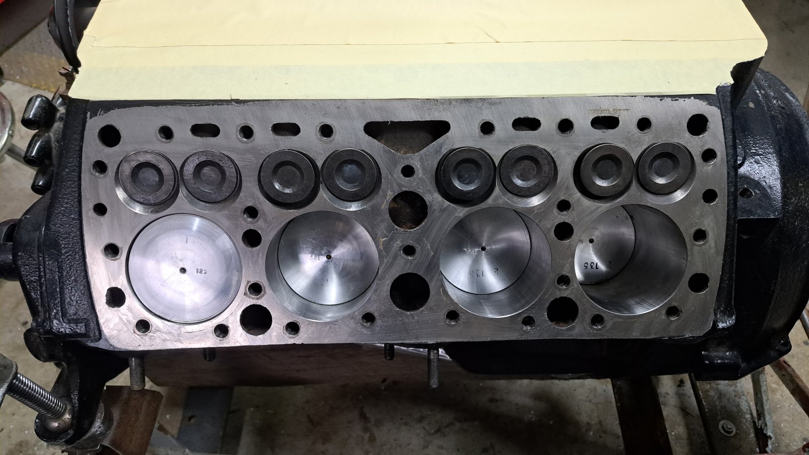

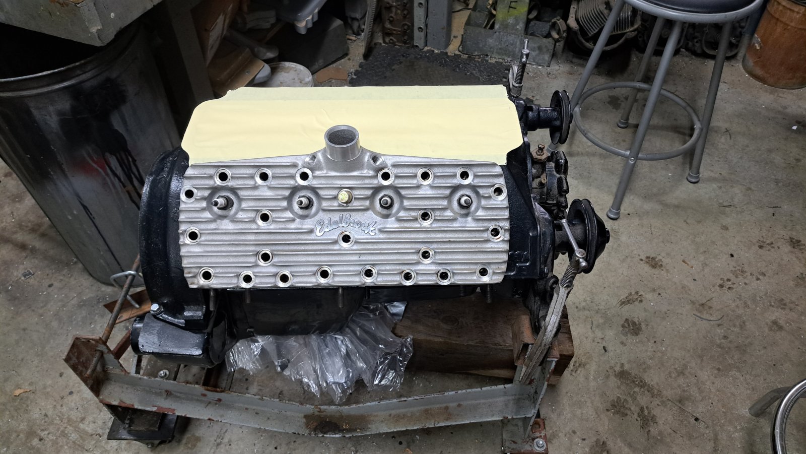

    The gathering of the parts has begun . I found a 32 cross member with pedals . I soaked it in citric acid for a couple days and have started the whittling . I made a MC mount and changed the location of the brake pedal arm. I freed up the pedals and made a new shaft. I just need some new bushings.

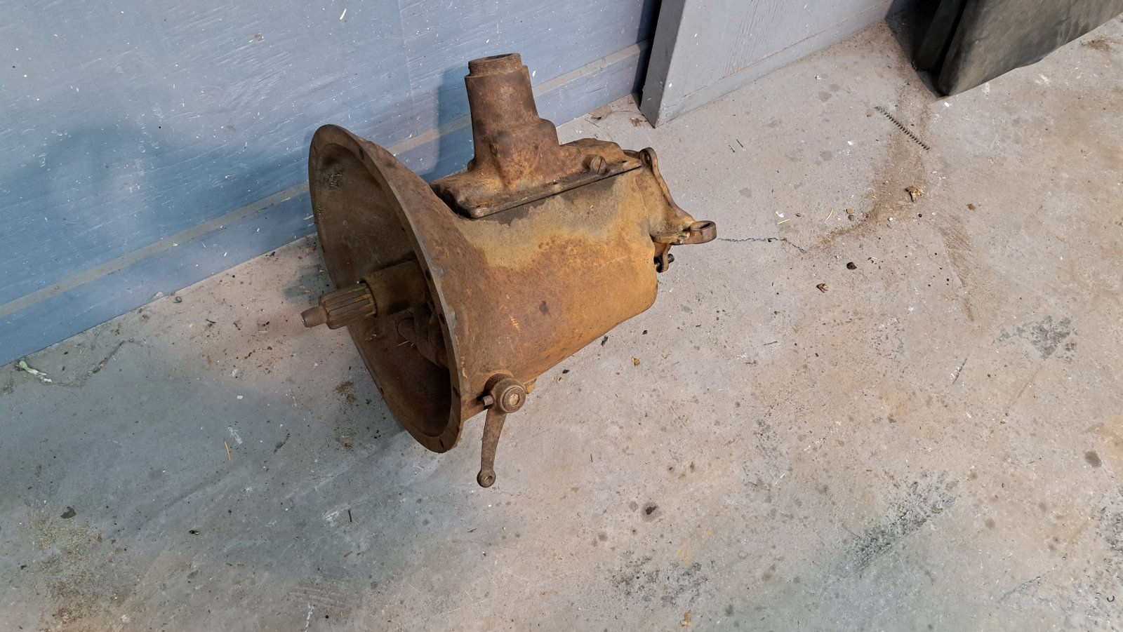

    Got a transmission for mockup , I want to use a side shift trans with a column shift...3 on the tree.

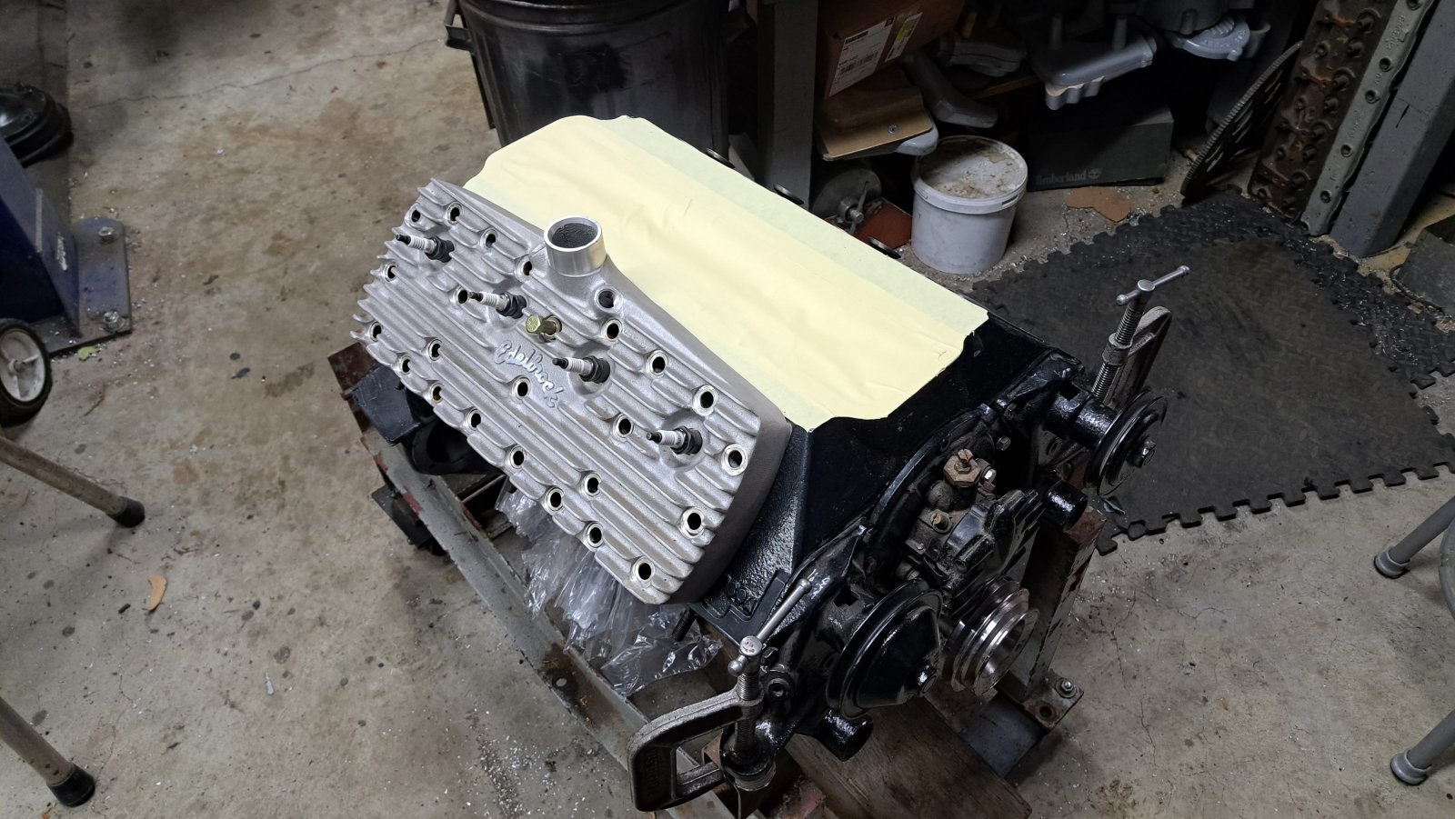

    I also bought a rebuilt flathead. I haven't dug into it but initial inspection looks good. It has .125 over pistons the block is decked and it has brand new Edelbrock heads. I'm pretty excited! Things are coming together! 20231210_135534.jpg 20231210_135558.jpg 20231210_135605.jpg 20231210_135639.jpg 20231210_135650.jpg 20231210_135626.jpg 20231210_135631.jpg

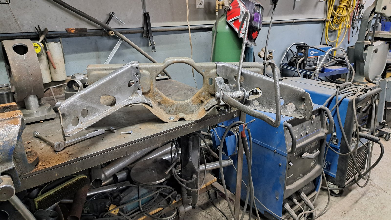

    Making some progress. I stripped the frame down to the nitty-gritty. Slicing and dicing a 32 cross member and pedals and some crack repairs on the original front cross member. 20240118_115545.jpg 20240118_115538.jpg

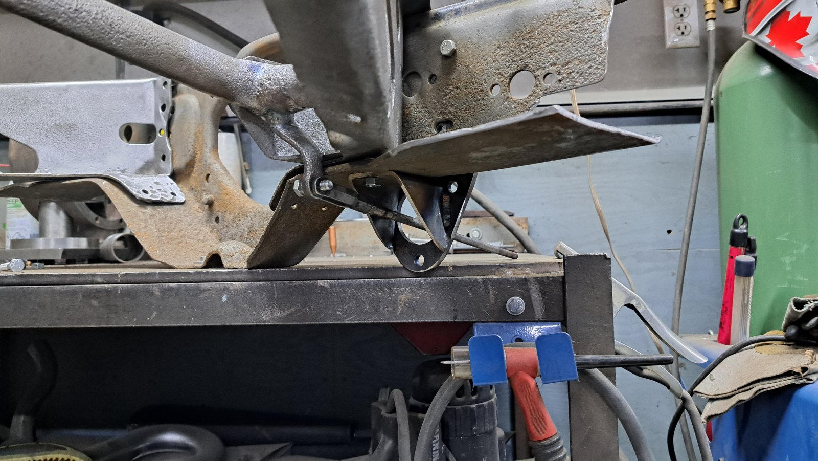

    I modified a later rear trans mount that had one ear broken off then brazed back on. I cut the ears off and turned it down to fit into the 32 rubber mount. It worked great! I have a friend who is pretty much a 32 only guy and he was letting me know how rare and precious a 32 rear mount is. This saved a broken mount and I didn't have to beg my friend for his 32 mount. 20240130_095515.jpg 20240130_095523.jpg 20240130_095141.jpg 20240130_095134.jpg 20240130_095659.jpg 20240130_095608.jpg 20240130_102343.jpg
