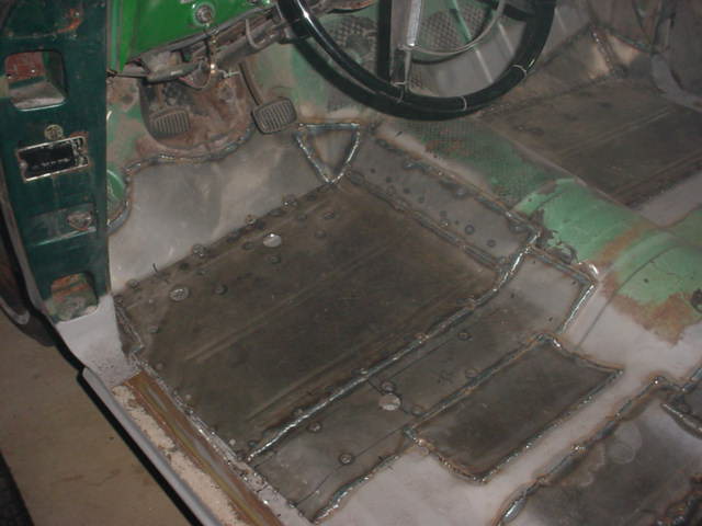

    I prolly already know the answer but do you weld your floor panels solid or just tack em every half inch or so?
    I have mine tacked all the way around and they seem pretty solid. I thought about just seam sealing it and moving on.
    I had cut the rust out so I would have a nice uniform hole and then overlapped the panels about 2 inches...then welded in.

    i didnt weld mine. I pop riveted them then put some silicone around the edge. I will eventually get new metal and weld it in! Nate

    after it was fixed!
