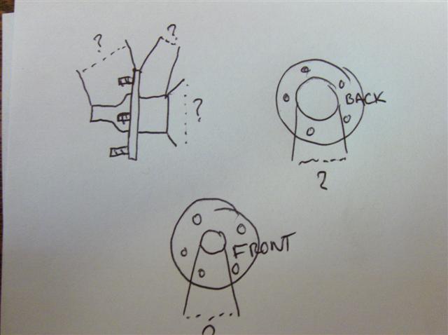

  30. 117harv
    Joined: Nov 12, 2009
    Posts: 6,586
    117harv
    Can you post these measurements?
