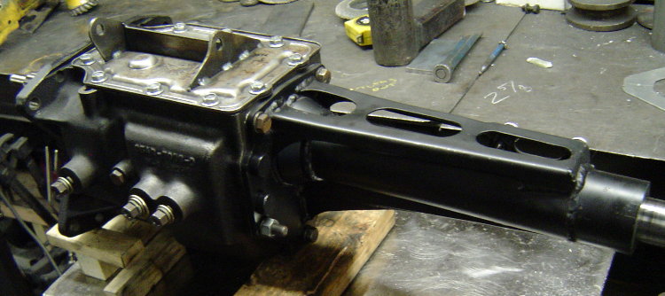

I succeeded in fabricating a center shifter for the Muncie tranny

    it looks fantastic!!! where was this during tech week!?

    Could we please see some more, close-up, photos?

    Very well thought out and executed. Can you post more close up photos? Thanks!

    That's pretty incredible.

    Fantastic work. I can't believe I am first to say it is a shame to cover that up!!

    Well said! That trans and shifter needs to have a tunnel on the bottom of the car so that workmanship can be admired! Tano looks like he could pull that off easily.

  26. Tano
    Joined: May 3, 2010
    Posts: 85
    Tano
    from Japan
    They have a very little clearance, and do a small swing from 0.2 mm to 0.4 mm.
    Everything was measured with the laser by my friend and corrected to a precise setup.
    He worked here as a mechanic for a formula car.
    However, since ****** has the individual specificity those numerical values are individually different.
    The size of spare ****** used when I built the linkage and Muncie of my Hot Rod had an actually little individual specificity.
    Positioning of the rod and the joining section should be perfect.
    The shifter will not function if they are not correct.
    Therefore, I needed to adjust the position by metal washers finely.
  27. Tano
    Joined: May 3, 2010
    Posts: 85
    Tano
    from Japan
    Swing mechanism is important.
    So, I thought that the shifter of Saginaw to which I referred from web didn't work by not having a swing mechanism.
