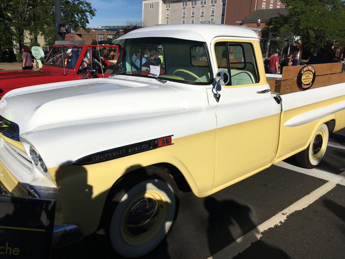

    84578357-77A3-4990-829F-45AF150935D7.jpeg Saw this truck this evening(Apache 36). Looked good to me but owner no where near.
    loudbang and catdad49 like this.
