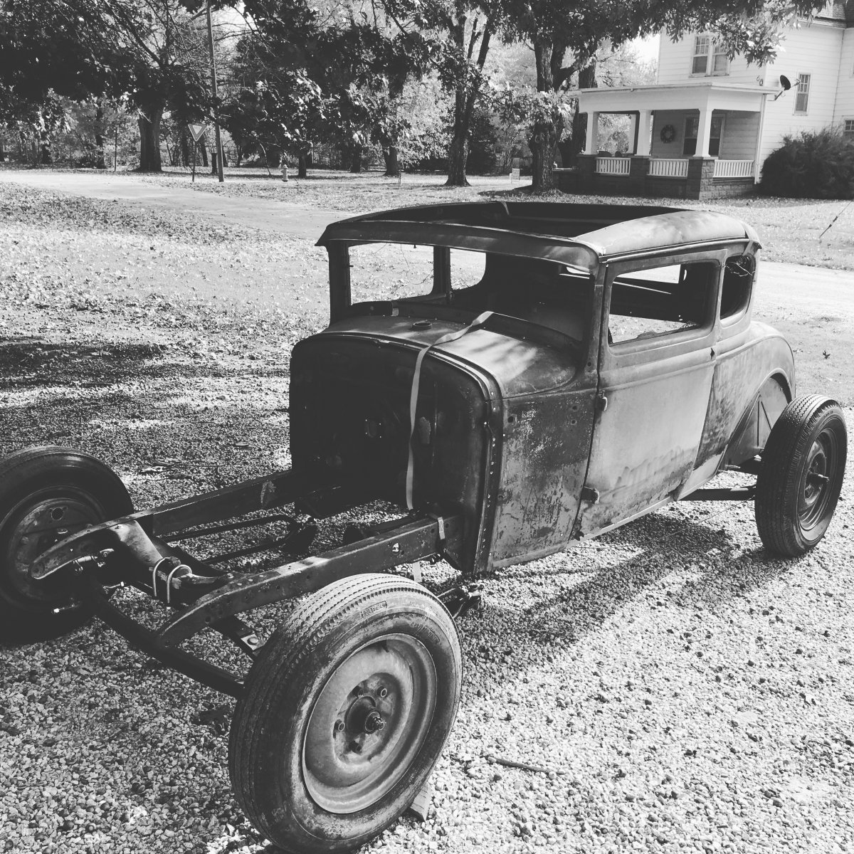

  2. Doug Hines
    Joined: Jan 9, 2019
    Posts: 283
    Doug Hines

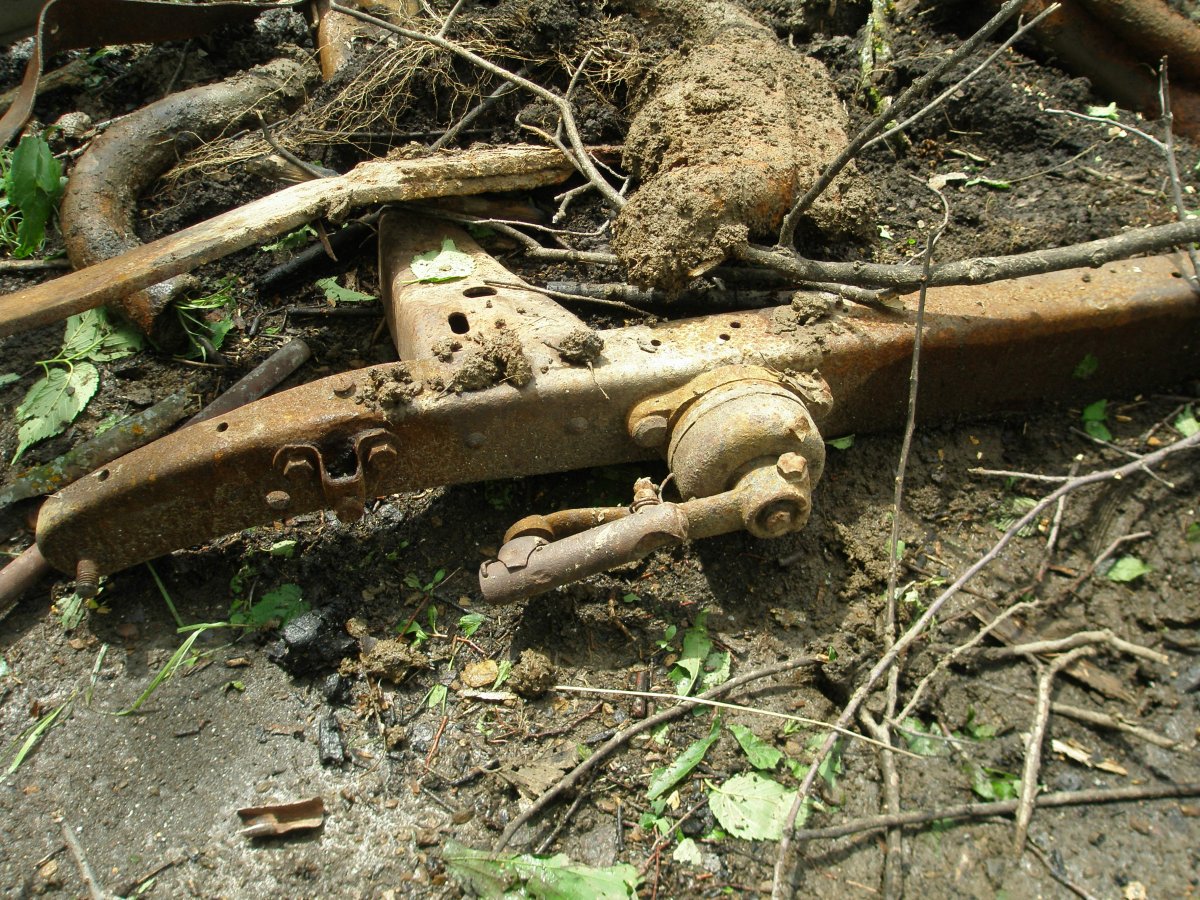

    I should have included these at the beginning of the thread. The 1st picture was the 1st time I saw the one. I did not even know about the shopped one on the ground until I went out there with Vincent. You can't see it from the road side.

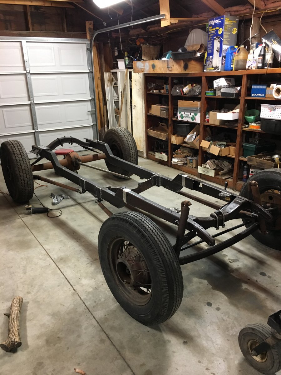

  10. Doug Hines
    Joined: Jan 9, 2019
    Posts: 283
    Doug Hines
    Then it was time to set that flatty in there and see how she fits. I built the frame about 3 inches longer than a Model A so I would have a little more room. It was pretty tight. Don't know were that extra space went? Then I trimmed the firewall out using the back of the engine as a template. The F1 box cleared the Millworks headers real nice. IMG_0364.JPG IMG_0373.JPG

  13. 1pickup
    Joined: Feb 20, 2011
    Posts: 1,847
    1pickup
    Awesome build! Remove the firewall & reverse it. Should have the room you need.
  14. harpo1313
    Joined: Jan 4, 2008
    Posts: 2,589
    harpo1313
    from wareham,ma
    You will get a much more comfortable ride with that frame stretch.
    pitman and loudbang like this.

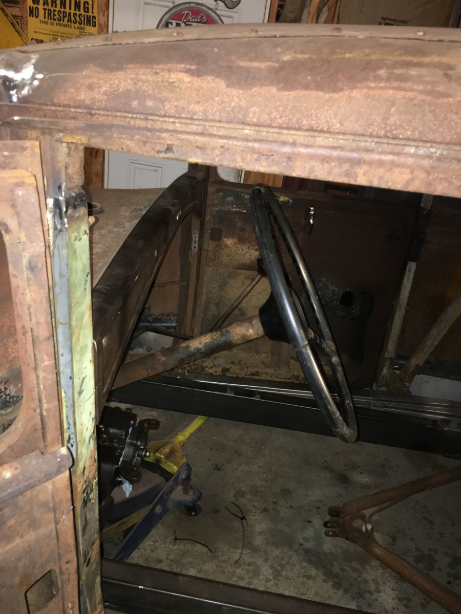

  15. Doug Hines
    Joined: Jan 9, 2019
    Posts: 283
    Doug Hines
    I never thought of reversing the firewall. Too late now. Thanks for the idea 1pickup. More comfortable ride is good. I did not know it would do that. I think I was just trying to get a little more engine room when I did that. Make it more like a 32 length if I remember right. Anyone have an idea about how many inches to take out of an F1 steering column? Or maybe how close the steering wheel should be to the dash? IMG_0382.JPG

  17. Kiwi 4d
    Joined: Sep 16, 2006
    Posts: 3,885
    Kiwi 4d
    Nic job Doug. Don’t worry about steering column length just yet. Get the pedals in , get the chosen seat in and sit in the car and see what position feels most comfortable for the wheel.

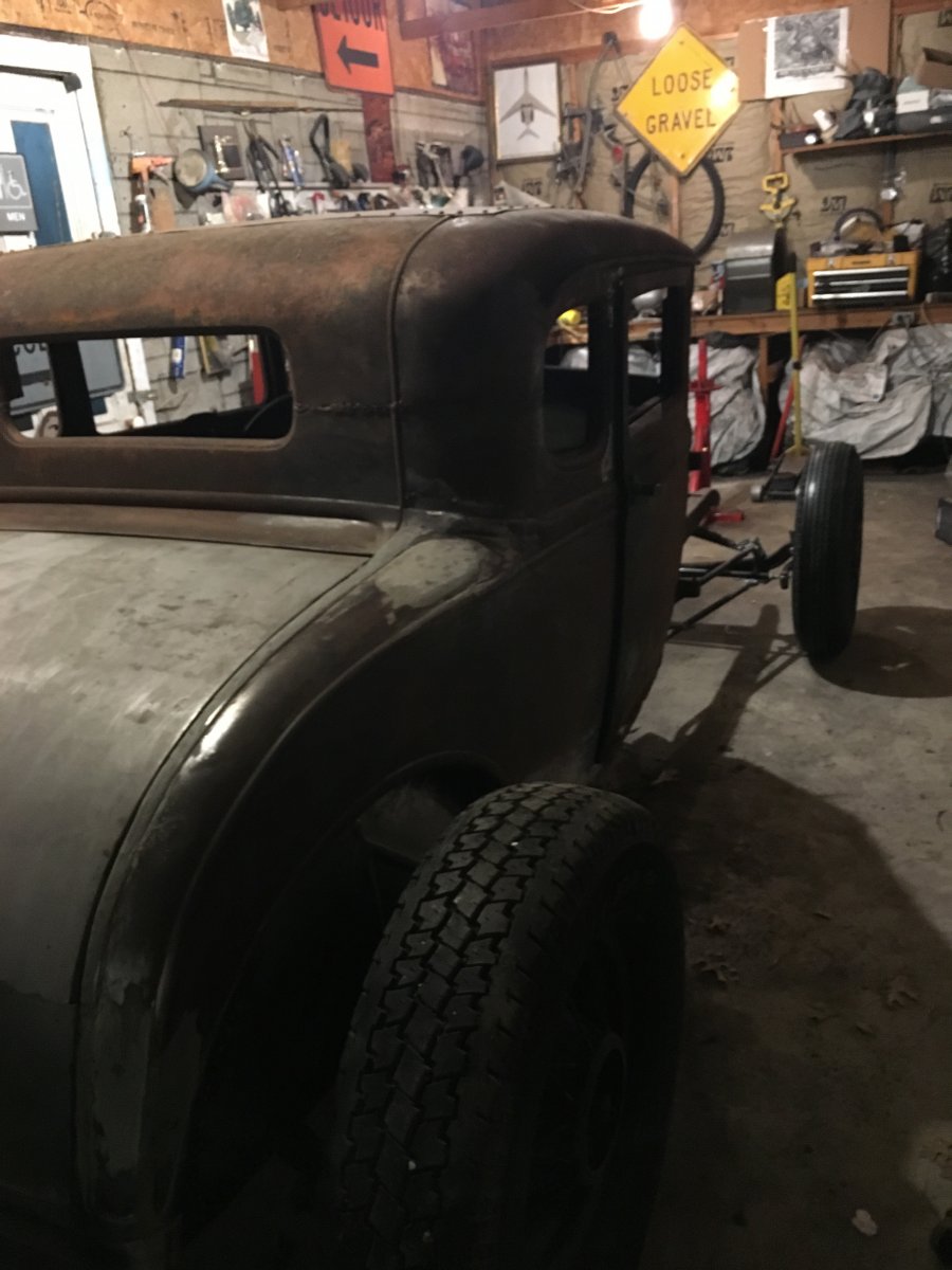

  19. Doug Hines
    Joined: Jan 9, 2019
    Posts: 283
    Doug Hines

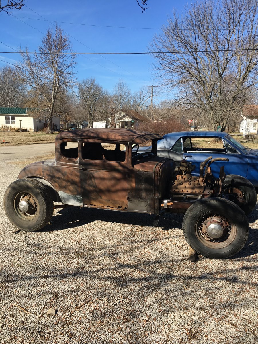

    Here are some pics of when I rolled it out of the garage to have a look in the sunlight.

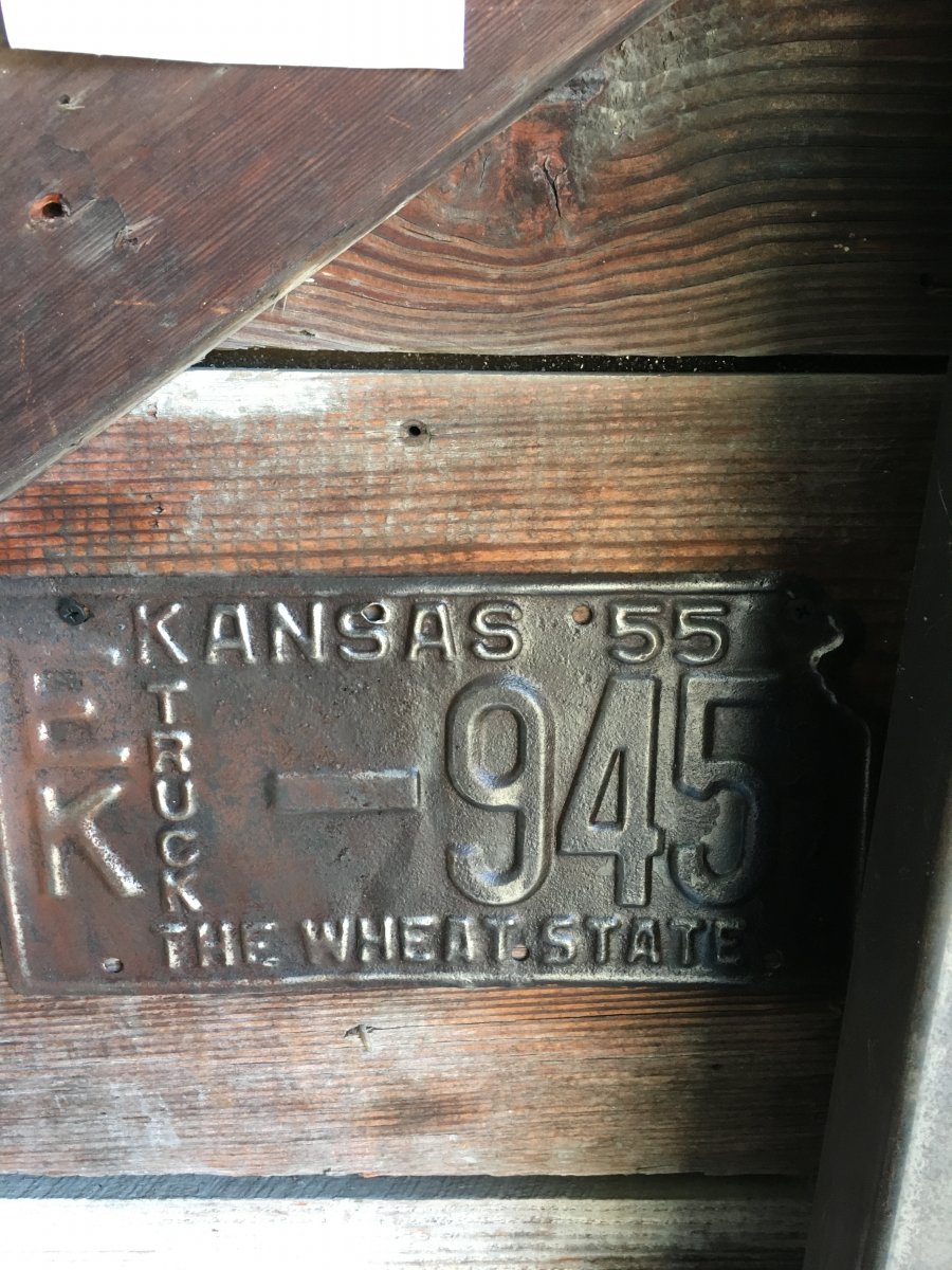

  21. Doug Hines
    Joined: Jan 9, 2019
    Posts: 283
    Doug Hines

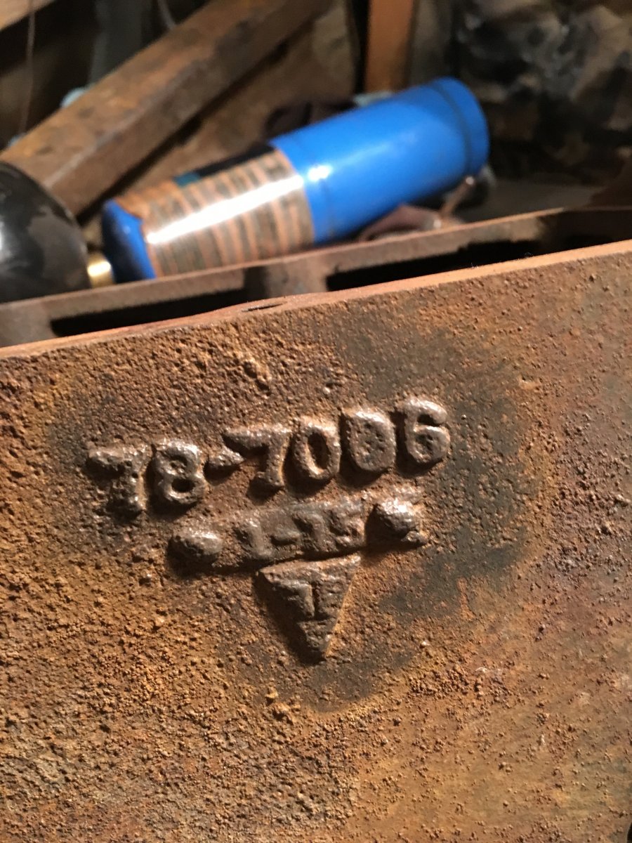

    I bought a case and a shifter from a guy over in El Dorado. I also bought a side shift 3 speed out of a 1940 ford. I got real lucky because the side shift trany looked like it had been rebuilt. Great internals. I put the guts of the side shift into the 78 case. Notice the odd casting number on this case. IMG_0279.JPG IMG_0285.JPG IMG_0291.JPG IMG_0314.JPG

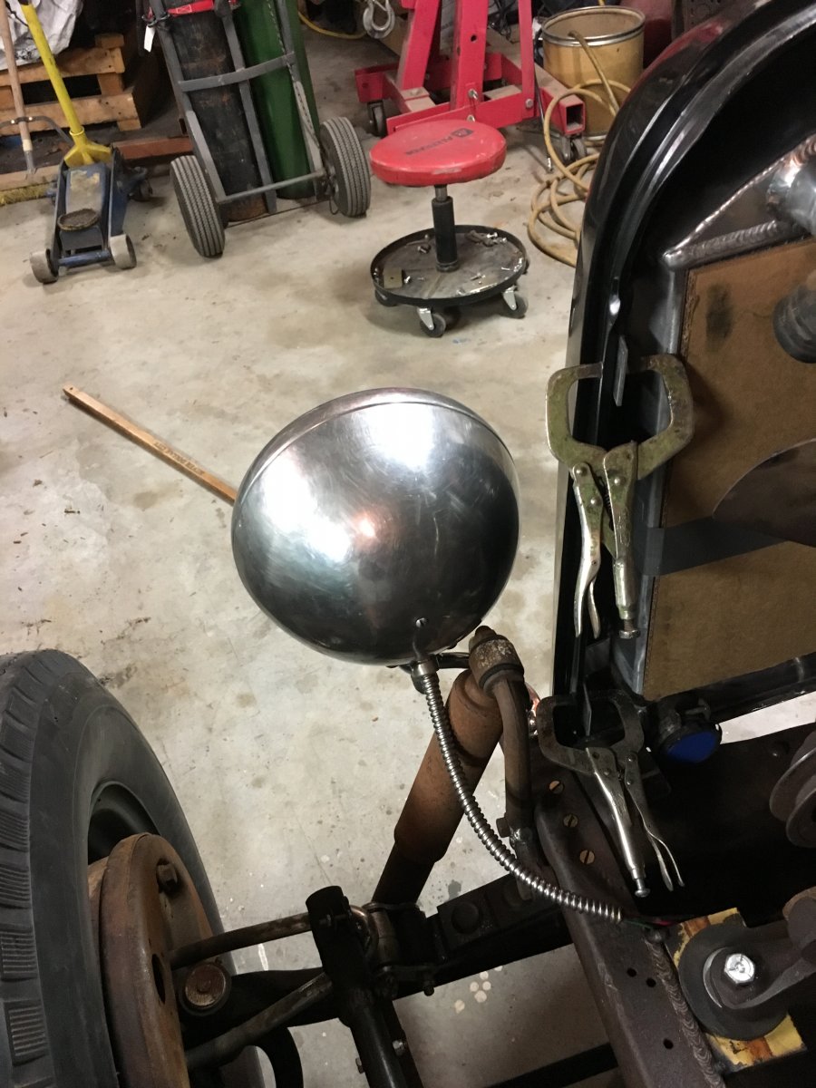

    Next I traded off those hair pins for some dog legs courtesy of my good friend Corky. They look much better. I ordered a hokey *** ebay 32 grill shell and it actually looks really nice. (especially if you have never seen a real one) I built a bracket to mount the C IMG_0545.JPG oldcase lowboy radiator to hold it all up. Notice the extra bolts in the pitman arm. If for any reason my welds were to fail, they are still bolted to the ends of the original shaft. I put in new end kits and fabbed rubber seals out of an old inner tube. IMG_0516.JPG IMG_0517.JPG IMG_0518.JPG

    I am glad you all are enjoying the pictures. I know very few people in the "real" offline world that understand what this car is and what I am trying to do. Most of my "car buddies" don't understand things this old. Not to sound like a snob, because 2 years ago I was in the same boat. Yes headlights. I bought these Two-lights for $60 up by Hutchinson KS. They work. I did not intend on using OEM lights but I like they way they look. I will admit that some of the stuff I like is probably not what is typically thought of as being on a hotrod (like the spokies), But I like the older looking stuff. The stands are just some Speedway parts. I decided to go with the chrome since the headlights are originals and still have chrome on them. IMG_0652.JPG IMG_0662.JPG IMG_0664.JPG IMG_0665.JPG
