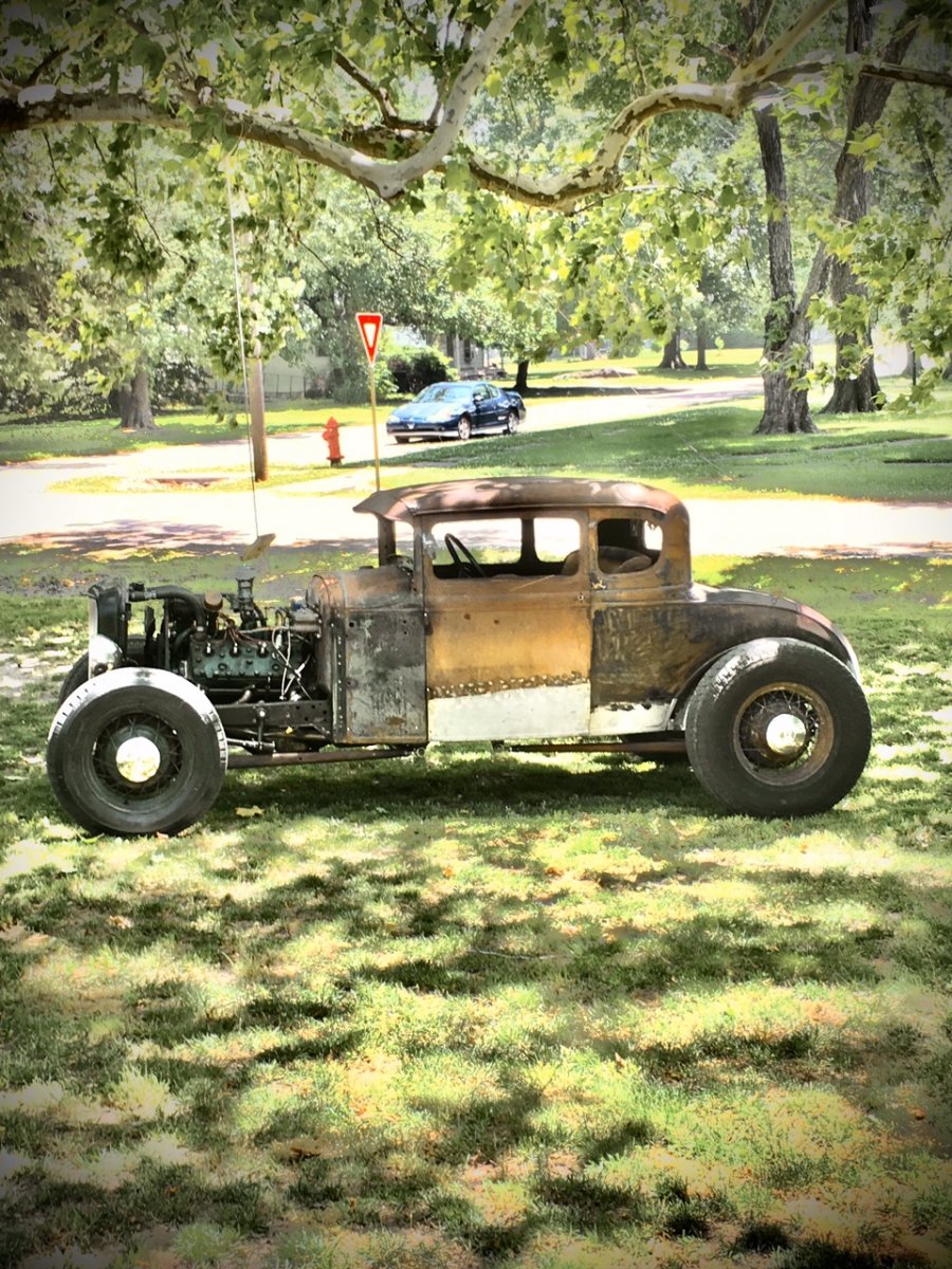

    Ya, I started out to build a Hot Rod and along the way I kind of fell in love with the things on this particular car that are so much of a time capsule. I just cant bring myself to change them. Like that "hand chiseled out of the doner car" roof with the old full radius screws holding it down. I agree, that single tail light really fits it, and I just like the wire wheels, I actually have a nice set of 50's period correct Ford disk wheels, but I like the wire wheels better. Were ever I go I find myself looking at the rusty old stuff. Not the shiny new stuff, or even the shiny old stuff. I don't think I have built a Rat Rod, but I would not be offended if someone thought it was. I say that because I have not done any of that on purpose stuff that rat rodders often include. I love shiny Hot Rods and real Rat Rods. To me this is something in between. When I look at pictures of cars built back in the day. I see a lot of variety. Many people did things many different ways. I claim to have done the same. I have used what I had and could find, and could afford. Each piece has a story behind it. I like telling people that I have very little "Speedway" on my car. The "cost per hour of entertainment" building this car is actually quite low compared to some cars I have modified. That is because so much of it is fabricated. I did not expect that. But then again I had no idea what I was getting into when I started.

    I know there's a big debate on "patina", and I don't want to hijack your thread by starting an argument here, but I really like your car. To me there is something honest about preserving the history of it.

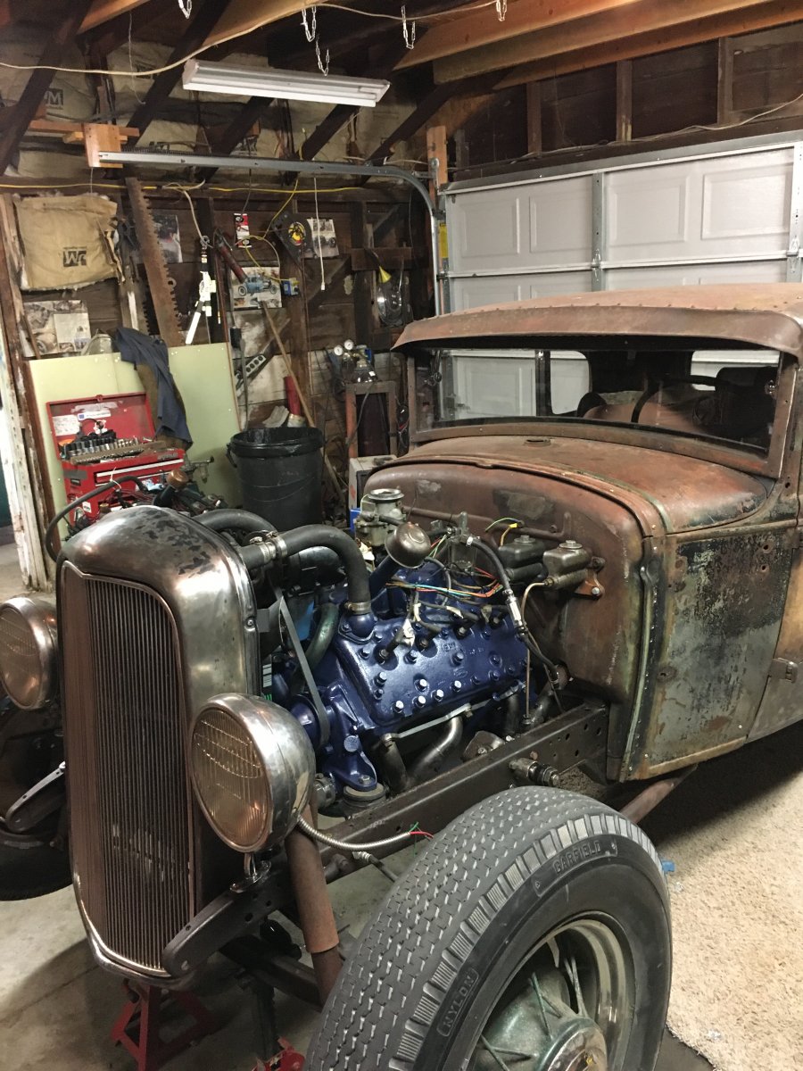

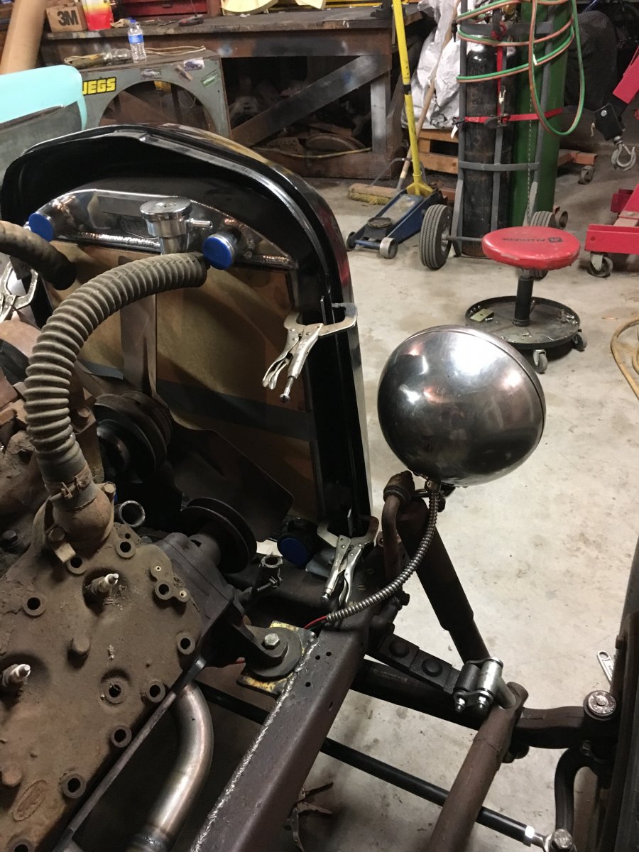

    So after a while I got tired of some of the gremlins in the car and decided I would rather take it back apart and fix them than drive it any more. I had been thinking I would hold off until it got cold, but nope I took it back apart. Here is the list of problems. 1. The old flathead I put in it was just shot. It has a low spot in one cylinder bore that is not going to be right until it gets bored and it was generating so much blow bye is was embarr***ing. 2. The ****** would not go into 3ird gear without grinding. 3. The level of Mystery in the steering was concerning. So I pulled the engine/****** and the steering column and went to work. I found the steering box to be in very very good shape, no problem there. Eventually I found the (cheap) heim joints I had used to be too loose. And I think I had the toe set out instead of in. I also put a different set of wheels on the front and I no longer have any tendency to want to shake at 35 mph. I ended up putting an original 1947 tie rod and ends on it. Now it drives real good.
    hfh, Runnin shine, loudbang and 5 others like this.
  6. Doug Hines
    Joined: Jan 9, 2019
    Posts: 283
    Doug Hines
    ****. I did not mean to hit enter, so I continue. I replaced a bad blocker ring in the ******. Now it shifts great. And then about that engine. I had purchased a different engine, before I bought the running engine. I didi not know much about it other than the usual "it ran when it was parked" story. I put that engine on an engine stand and got it running and it is a better engine than the one I was using. So I stuck that engine in the car. Now I can run 65 MPH down the road and it does not feel like I am going to die. LOL I think this engine will work while I s****e and collect parts and eventually build a Hopped Up Flathead for it.

    Apologies in advance, if it looks like I'm tryin to hijack this thread- I was admiring all of your work, and wondered if you could provide details on the left spindle/ round tube steering attachment -I'm trying to learn as much as I can- any ***istance is appreciated- thanks for posting these cool photo's/updates!!

    looks like your standard bolt on aftermarket- or home made- steering arm.

    Like Tim said. It is a standard purchased part. Here you go.
    Speedway Hoop Style Steering Arm, Ford Spindle
    Universal Fit, 3.375" Center to Center, Steel, Zinc Plated, 7 degree Degree of Taper

    The part between the pitman arm and the hoop style steering arm is made from the ends off of an F1 truck welded on the ends of a piece of pipe to lengthen it. I don't know what those type of adjustable tie rod ends are called. Someone will.
