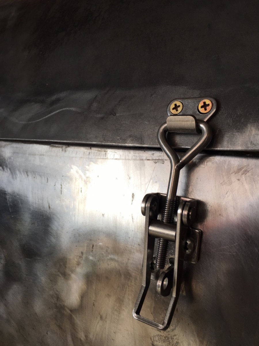

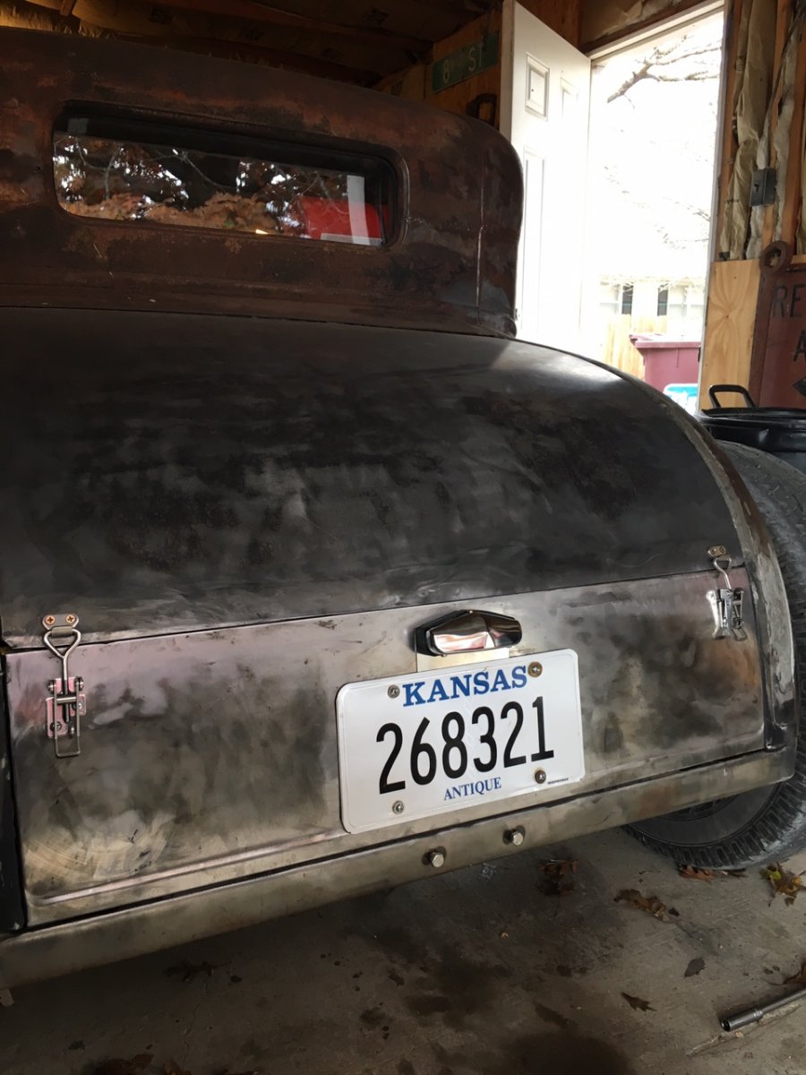

    Amazon. I think they cost a little under $20 bucks for the pair. They are so forgiving because they easily adjust. IMG_1626.JPG

    Those latches are neat!
