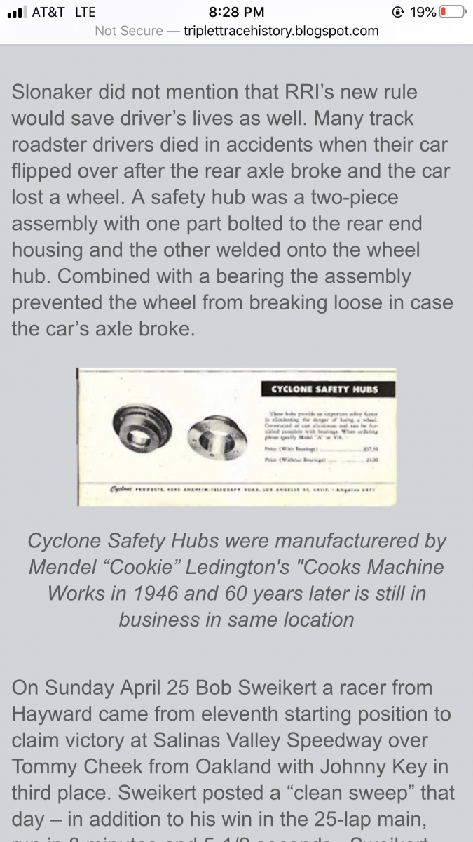

    In one of the captions of the number 2 roadster it says it’s equipped with a Cooks quickchange. After doing some research on the cooks/cyclone rear end I Learned about safety hubs. With the help of cyclone Kevin on here I know for sure that the hubs on the quickchange in the car are cooks safety hubs which were required for the 1948 season to stop sending wheels out into the grand stands. Maybe it was mentioned and the promoters wrote cooks quickchange. there is a lot of similarities also with the low quickchange and the cyclone maybe Lenny low put his name on it.

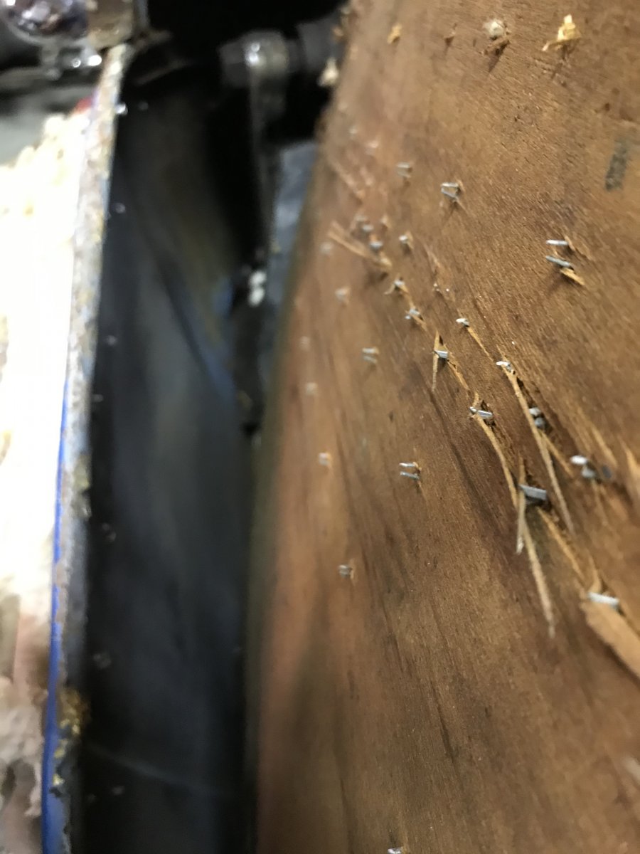

    There’s holes!!!! Stripping the paint down now to see if they match up with pictures.

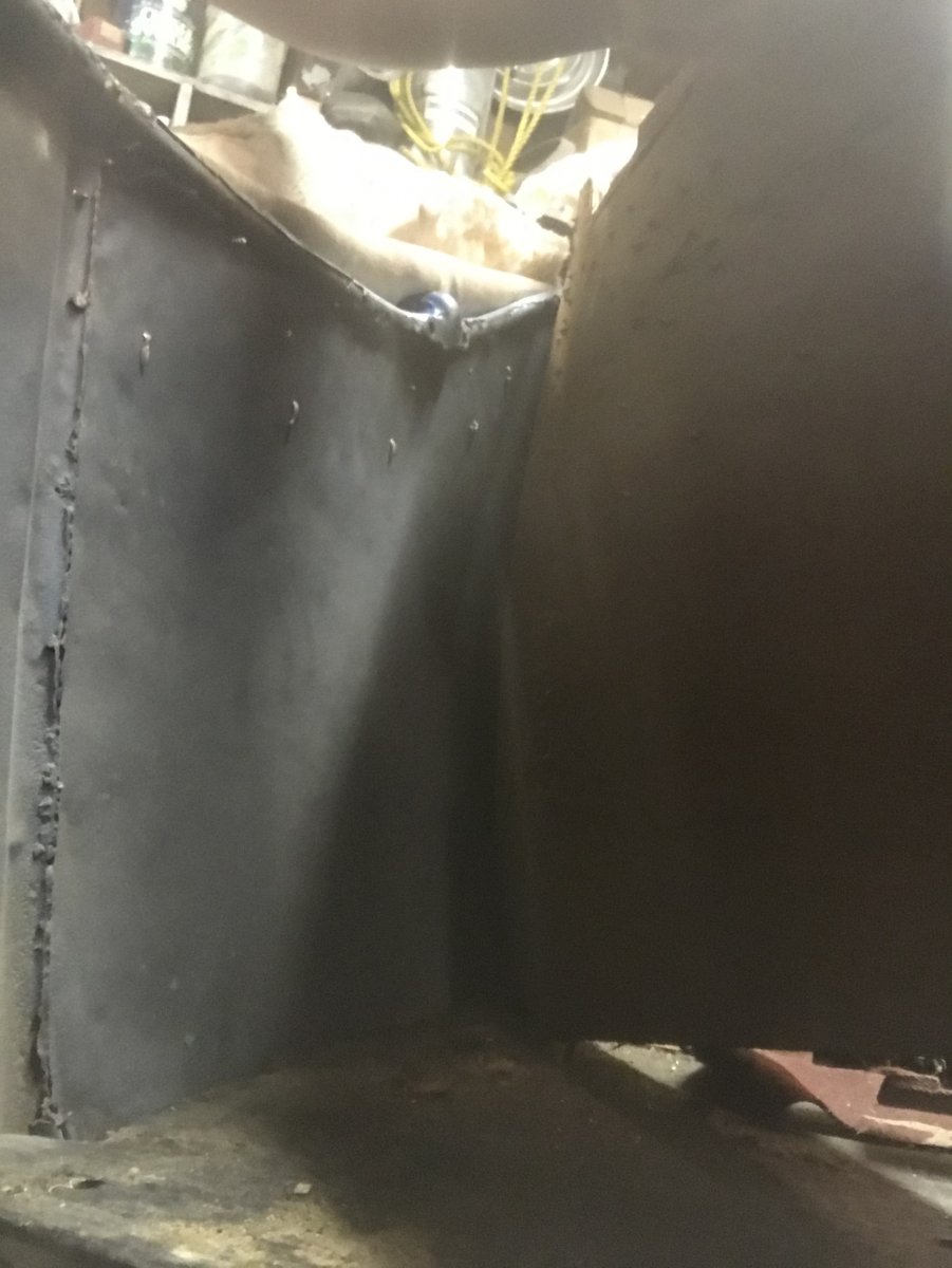

    Have a long way to go I believe the painter when he said 40 coats of lacquer the paint is very thick then lots of bondo. 1/4 inch thick is come places.
