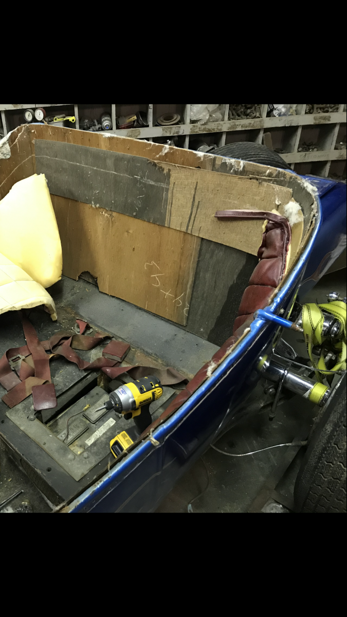

    The original blue fade paint job was still under the interior along the top rails and maybe purple under that

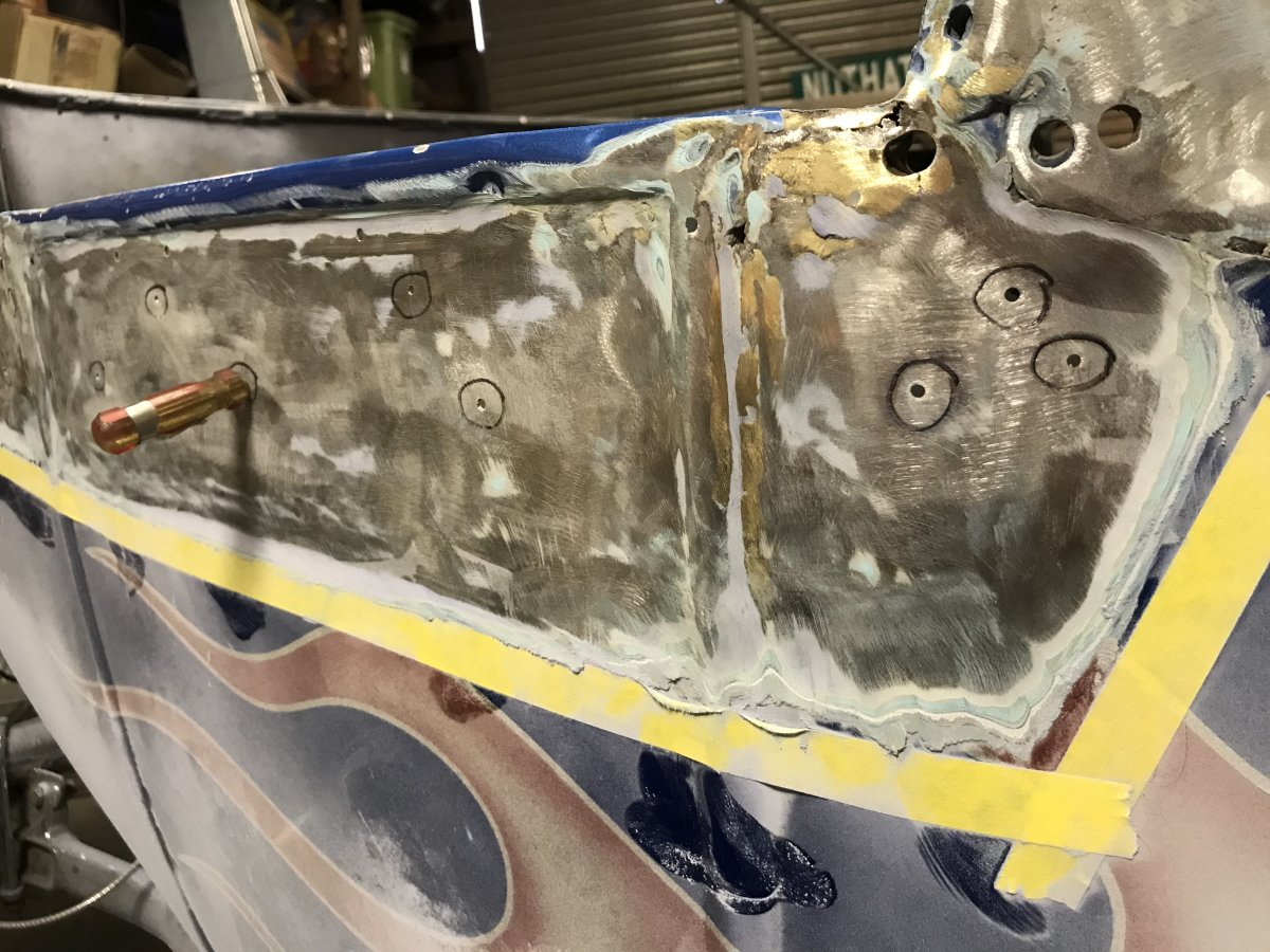

    Looks like there is two sets of holes. There’s is loads of bondo. Lots of brazing and signs of lead.

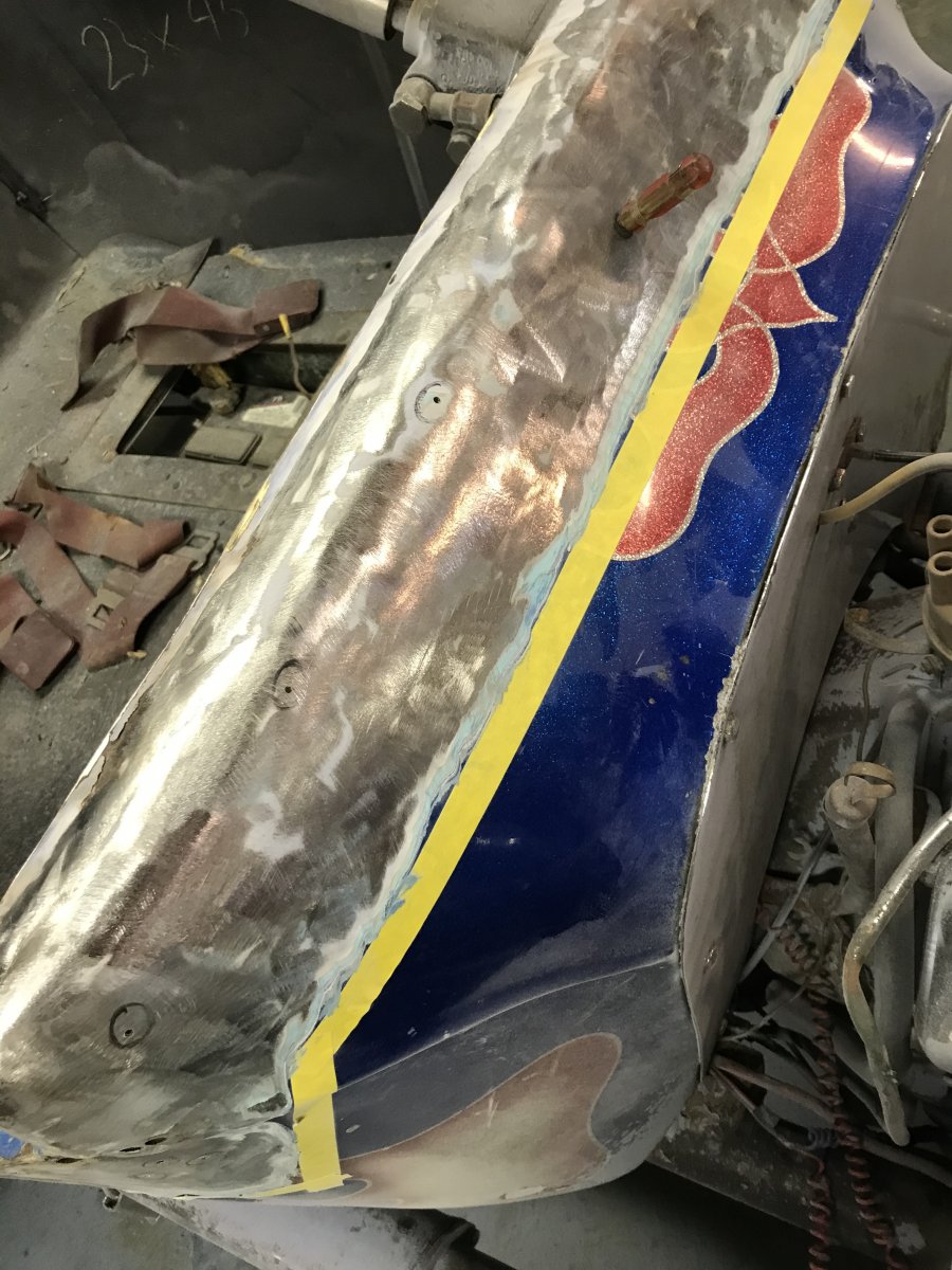

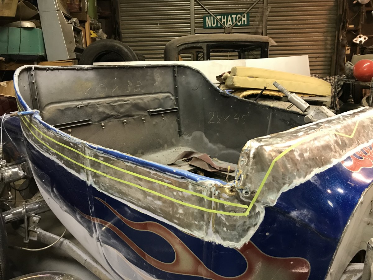

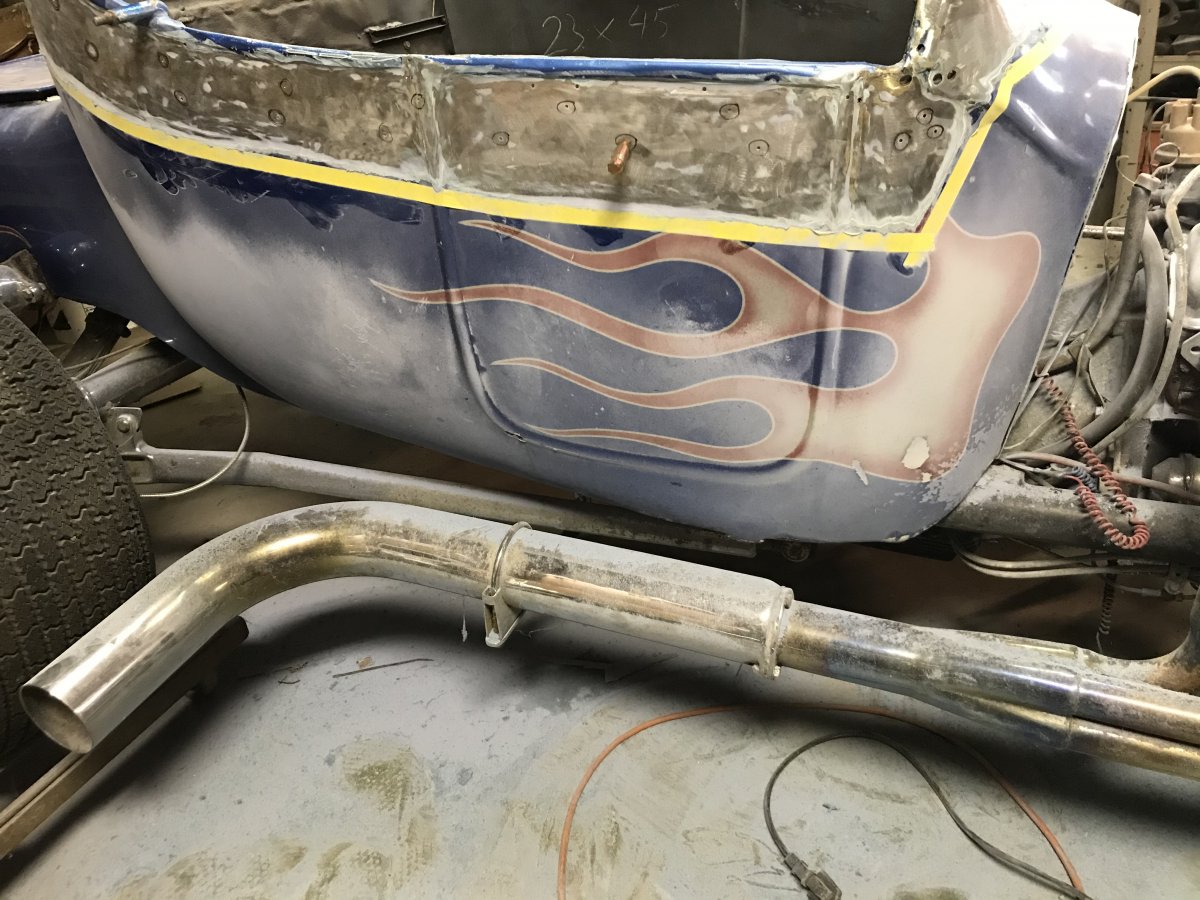

    I’m not the best taper but I went from hole to hole with some masking tape to give an idea. There is two sets of holes that line up. There is aV front and rear I don’t have any photos of the rear of the number 2 roadster yet to match up but the front sure looks like a dead on match.

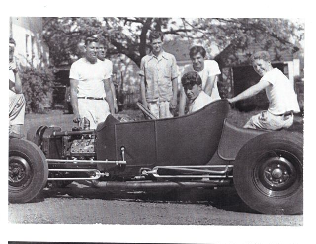

    OK. So I spent the morning going through this thread again, looking at photos of the Neves roadster, the Valdez roadster, and also the different roadsters that Pacheco ran.
    I hope I'm not a party pooper here now, but what really strikes me is that Larry shrunk the door reveals out of his body for a smooth finish on both sides:
    The Valdez Roadster, and Austin's car have these reveals:
    When we were researching the Neves roadster a couple of years ago, my buddy Richard Noble also told me that he believes the body of the Neves roadster was narrowed...
    Those two things make me think that it is not the lost Larry Neves Roadster:
    https://kustomrama.com/wiki/Larry_Neves'_1924_Ford
    If Blondie Pacheco was related to Joe Valdez's wife, there is a chance still that it might be one of his old roadsters, so you should really dig into that connection and try to confirm this. Also, for all we know, it could be the ch***is from the Neves car with another body...the hunt continues ;)

    Hey no problem my thought on the smooth doors was that they were leaded over. the door reveal on my roadster is hammered flatter then stock and signs of lead on both sides of the line kind of like a “cave and pave”. The reveals look normal with paint because it is built up with bondo and sculpted.
    I also read a caption that mentioned it was narrowed but I measured my firewall to the measurements of a flathead with stock heads and there’s only a 1/2” clearance. Looking at the pictures of the number 2 car the hood is smooth on both sides if it was narrowed a flathead wouldn’t fit inside the firewall. Also the turtle deck seems to be stock width and length with the body still having wide curves to meet up with on the side of the car.
