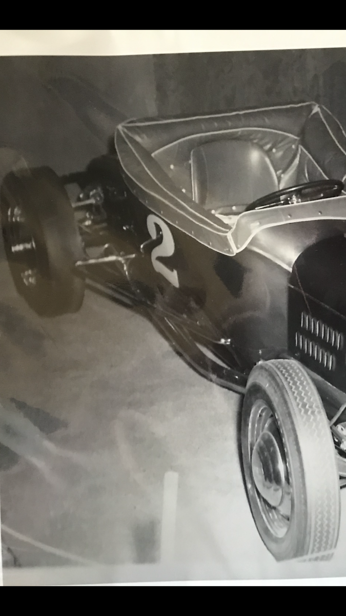

    Does anyone have an idea what that rear wheel and tire combo could be it looks deep and wide reversed 15”or 16” or rehooped What would have been ran in 1949 or prior and the tire almost looks like a slick.
    Stogy, Thor1, loudbang and 1 other person like this.
  7. Rears look like 15" reverse Mercury or Lincoln wheels. Fronts look to be normal 16 Ford wheels

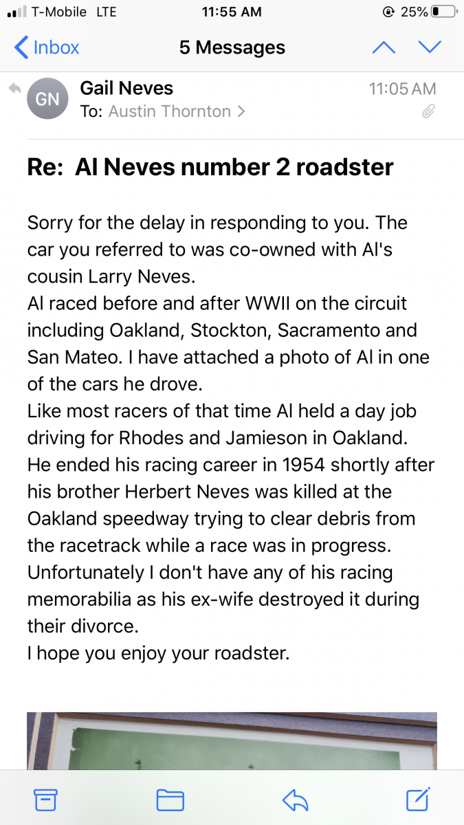

    I was able to get in touch with Al Neves last wife Gail who provided a couple new things. She believes that the number 2 car was co owned by Al and his cousin Larry who owned a repair shop
    In San Leandro and was raced by George. Unfortunately she does not recall the name of the shop or any other info on the car color wise or history. Still tracking down family members on the Neves family which is tough She said that Al and Larry Neves had a bad ending in the 50’s and never talked to each other again.

    thanks for the info in the show pictures the roadster must have been set up to run asphalt With the slicks on The rear. What do you think those front tires are?

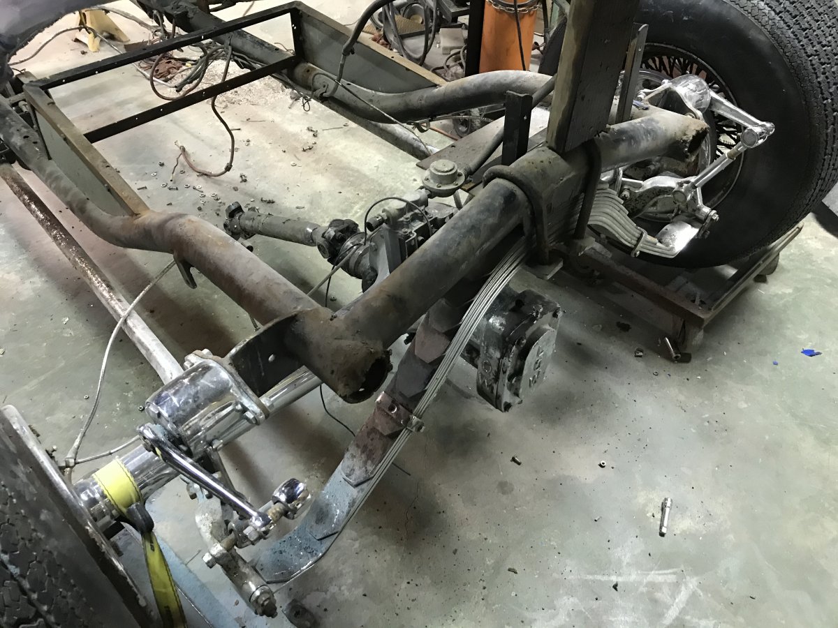

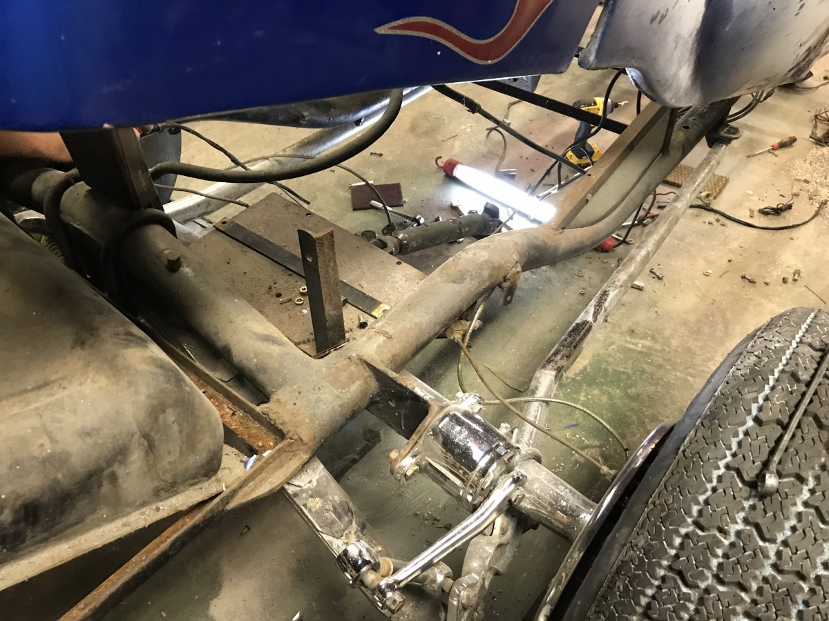

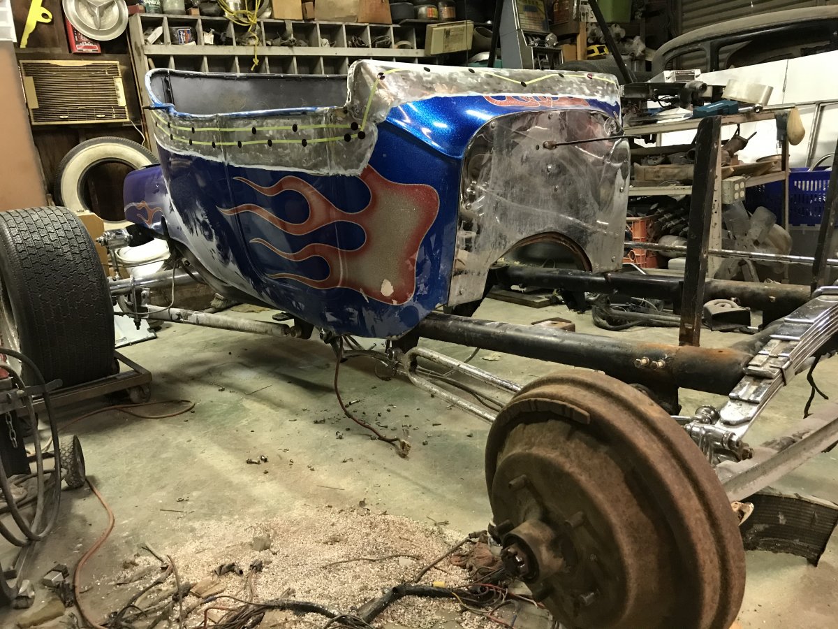

    Got the car blown apart and body moved forward where the original shock hole is on the body. Now I need to cut the original opening back open and lower the body down. Made a huge difference in the look of the car. Also bolted a pair of juice brakes on the front.

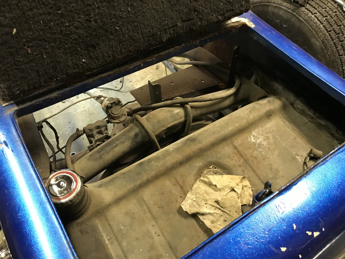

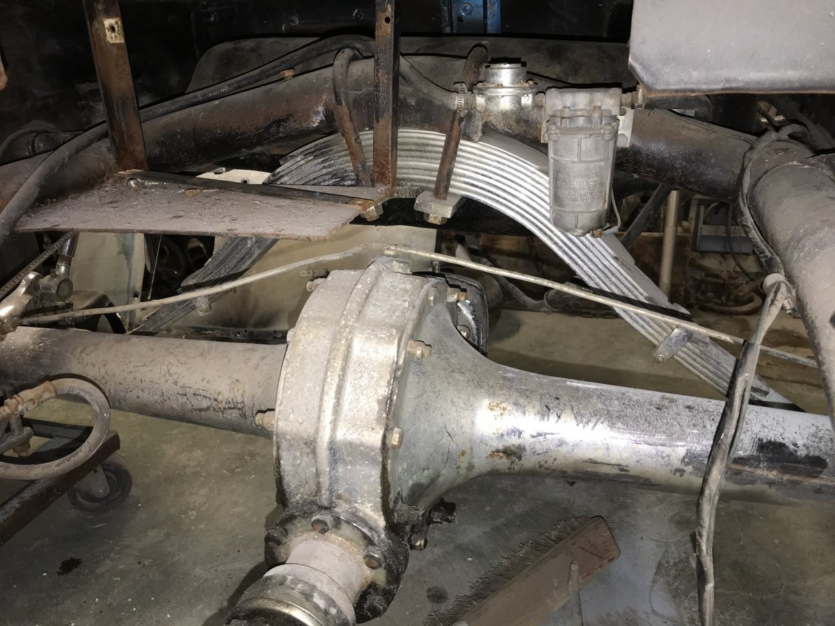

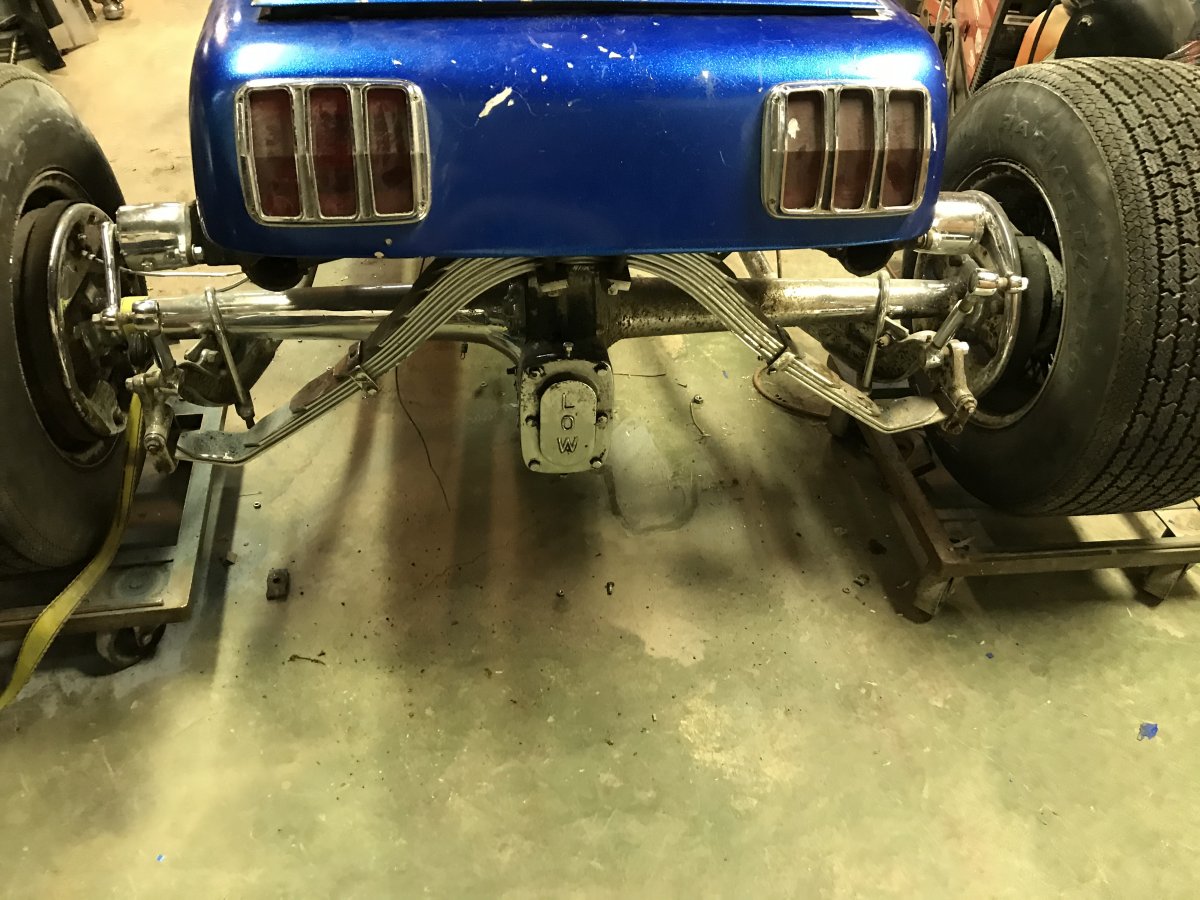

    Could that be some Of the original maroon paint of the number 2 car on the frame still under rear crossmember?? The frame is painted a dark metallic blue that almost looks black.

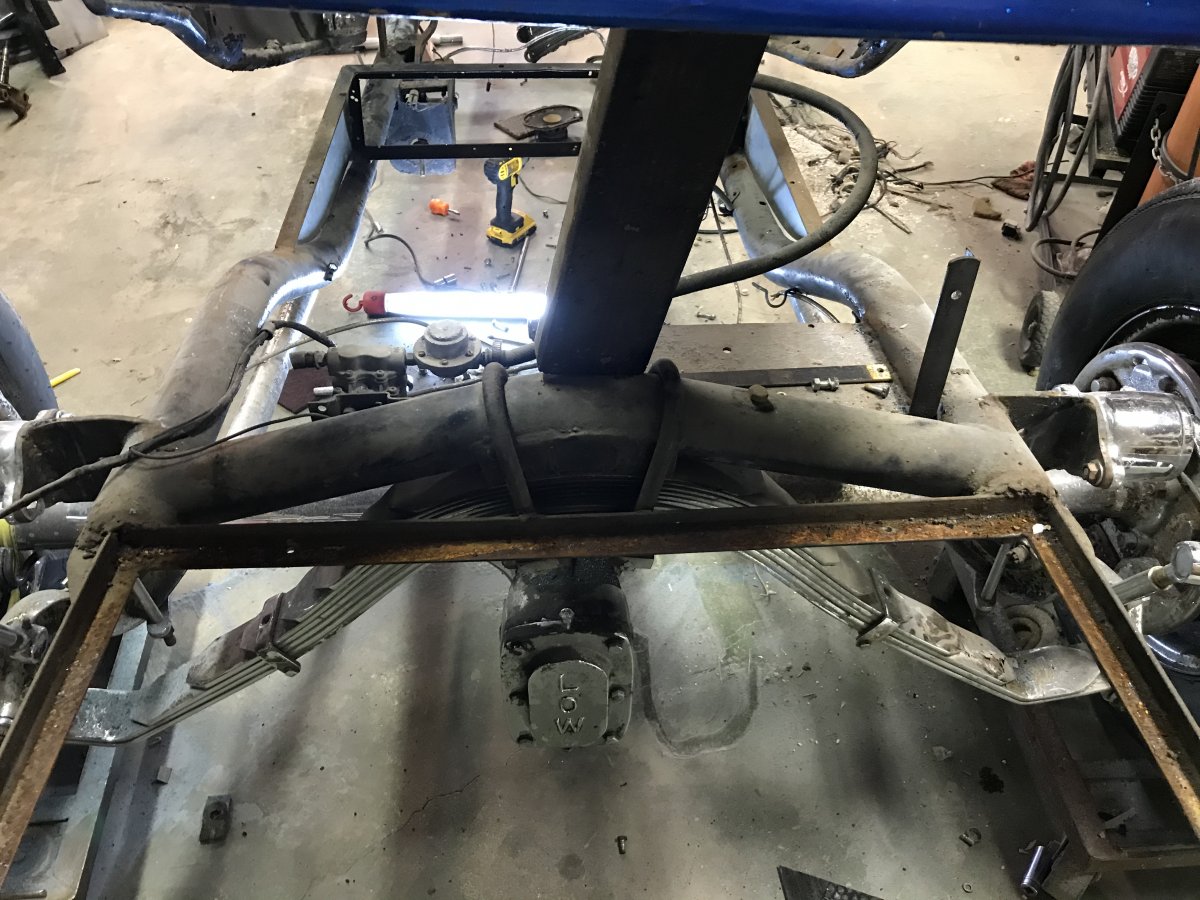

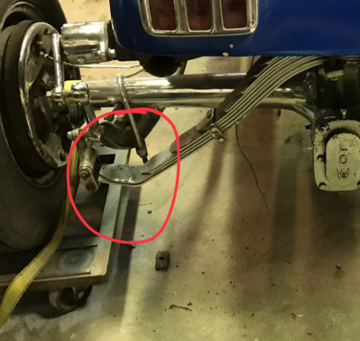

    A question for anyone following this thread. The spring mod in the photo, an early attempt or a seventies thing? can’t see the spring working too well like that so wondering if it’s an early speedway thing or ?

    i had a 36 pickup that was built in the early 50’s lowered the Same way both front and rear spring was bent I guess it was an easy and cheap way to get it down that extra couple inches.
  27. This was common in the 40s and 50s. Even back then it was discouraged, there was an article in early HRM where they recommended reversing the spring eyes and not heating the spring like this.

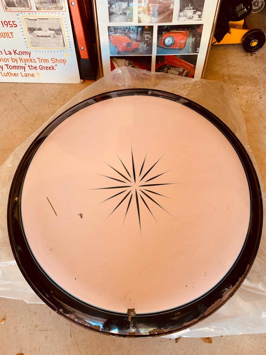

    Tommy the Greek pinstriped my survivor 34 back in 57/58
    Here’s A picture
