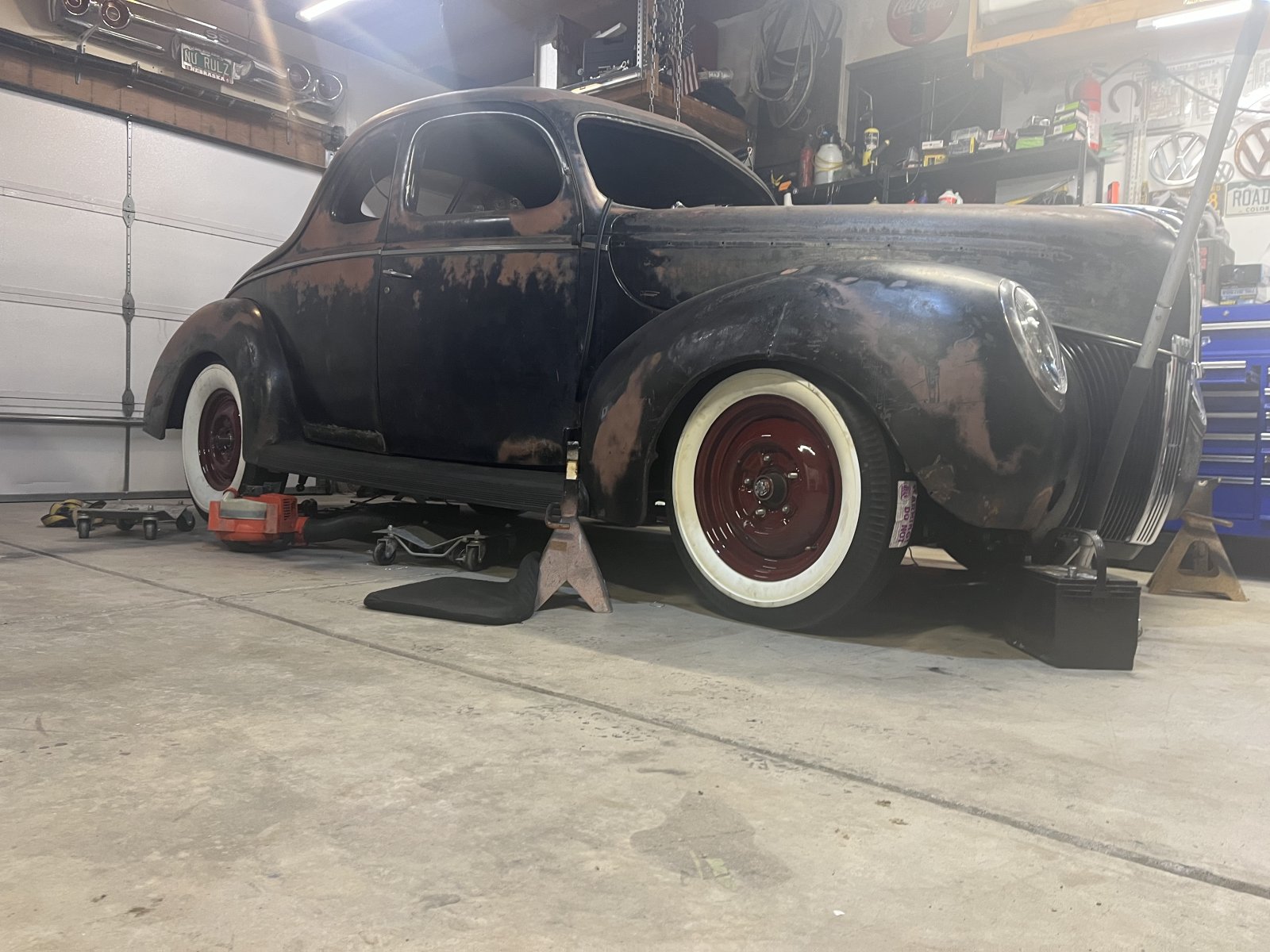

    of course they are out of the one I need! Maybe I’ll go this route. Do y’all really think if I go narrower with new brakes it will mostly fix my issue? Do they narrow 1” per side or 1” total?
    is there a way to tell if my disc brakes are in fact the wider style? Or is it safe to ***ume they all are (unless I specifically order narrowed disc brakes)?
    I’d rather not roll the fenders if I don’t have too.

    The only way to tell if your disks are moving your track width out is to measure the mounting surface to a fixed point, then install the stock drums and measure to the same point. MOST disk kits will add an inch per side, but not all.
    Your car is cool as hell, by the way.

    Maybe I’ll try to put the stock brakes on and see what happens. I was REALLY happy I didn’t have to worry about getting the front drums off (because I took the original axle/brakes out all as one unit). But I guess I can’t avoid taking it apart. I guess I know what I’m doing g today.
    question…I put new spindles on when I did the disc brakes. Is a spindle a spindle meaning can I use the new spindle on my drum experiment or will I have to swap the og spindle too?

    Mine has a narrower axle and spring with a much smaller tire and it still drags the fender a bit. As long as you still have the rolled lip, it won't hurt those $$$ bias plys to rub a little.

    Is it an optical illusion or just my weak eyes, but it looks like the front tires are bigger than the rear tires? I'd try to find out just whats different between the wide/narrow disc set-ups. Might be a small modification will make yours work.

    As long as the spindles are a stock style 28-48 spindle, they all should be the same.

    I personally would wait and see if it's a problem after you get some miles on it. My '40 appears to have about the same amount of tire clearance between the top of the front tire and wheel well, and it doesn't rub. I don't have a photo handy, but I've had a few people comment that they like the stance. I really like the way yours sits.

    Eh, there is no “trying” it out right now. The driver side is so bad if I force the wheel to turn much more than about 1/4 turn, it would damage the fender.
    Why would my driver side be 3/4” lower? The p***enger side isn’t as bad and the driver side is definitely 3/4” lower.

    Maybe try resetting the ubolts for the axle. You possibly could have the left side honked down a little more. Just a thought.

    Good point on axle u bolts. I tightened one side and it helped. Not perfect but better for sure.
    I put the original front drum backing plate and drum on (one side only for now). Then the wheel. No change. Damn!
    I’m starting to suspect wheels. I eyeball measured them (with tire on rim but off of car so not perfect) and from very outter rim to outer rim is 5.5”. I’m ***uming this means it’s the 4.5” wheel?

    Measuring king pin to king pin is easy. Use a straight edge and drop a straight line to the floor. Use chalk or tape to mark it. Do the same on the other side and measure the distance between them.

    Even if they are the 4.5” wheels, switching to the 4” would probably only get the sidewall in a 1/4”. And won’t change the edge of the tread any where the s****ing happens.

    maybe your front sheetmetal isn't square on the body...?

    That sounds like the most likely reason for one side too close.
