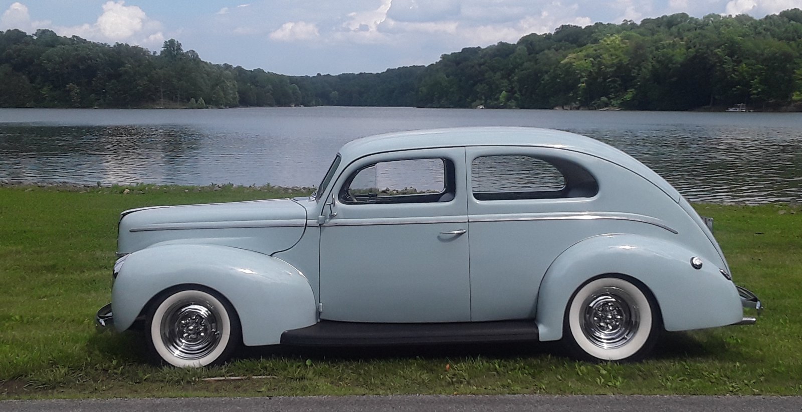

  1. Hey Dan, nice looking car, great stance sir! What year was the 47" axle/35" perch width that you used?
  2. Nice looking 40, you nailed it!!

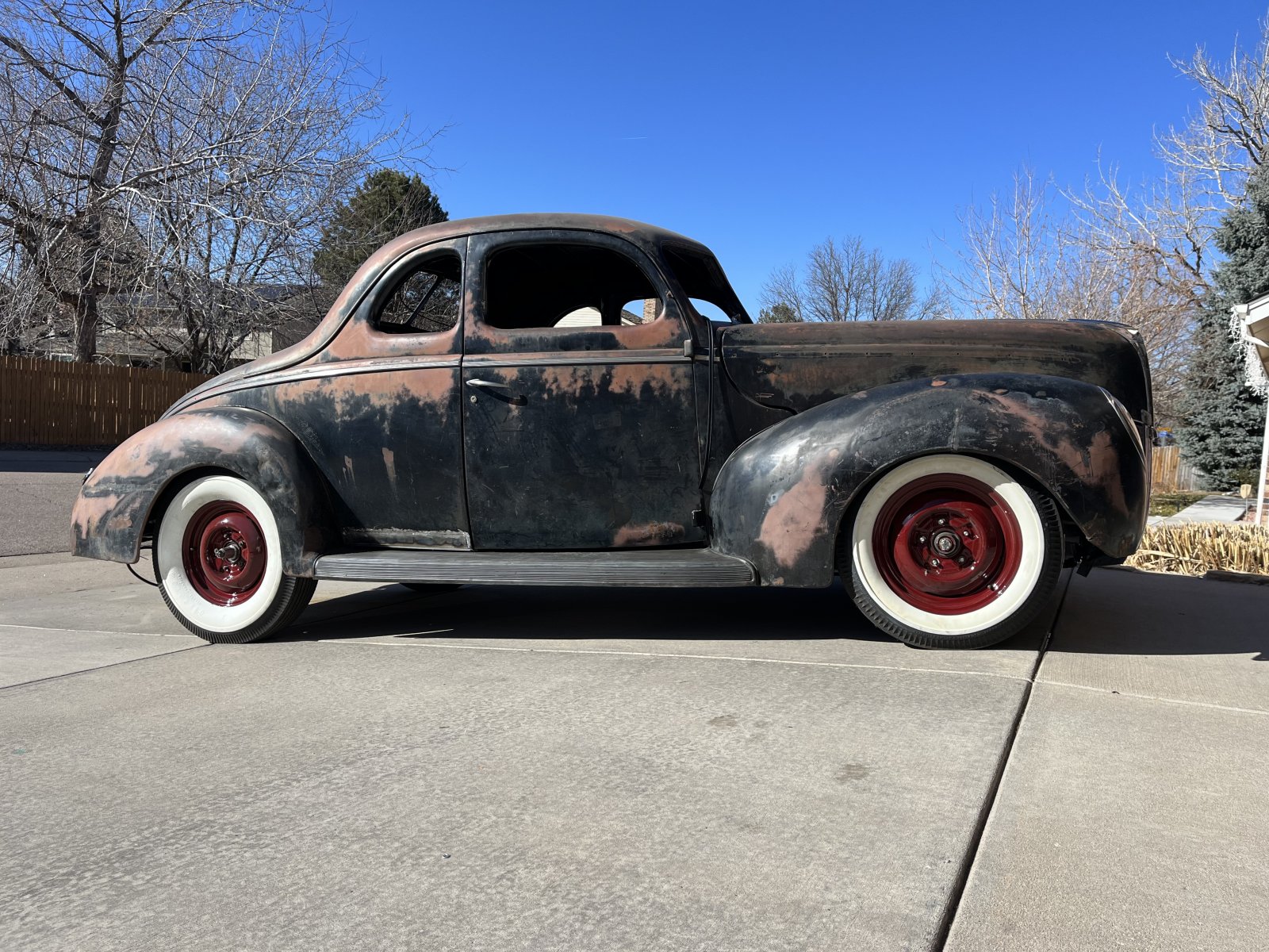

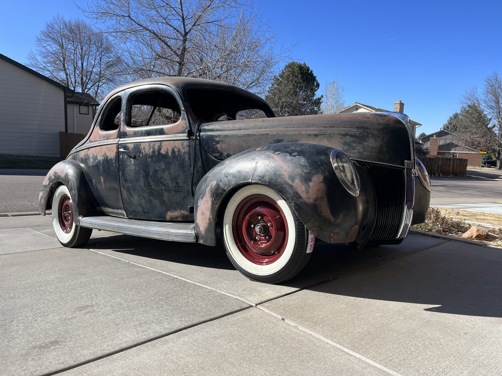

    thanks. I’d say I nailed it once it’s driveable safely and comfortably!
    I did some measuring of where it sits now and where I need it to be by jacking it up and measuring from ground to center of fender opening. I think I need to gain about 1” of clearance. 3/4” if I’m living dangerously.
    I spoke with posies today. It is a 47” Axle (though he may have said 47 3/4 which I’ll verify next time I call…we were talking about a lot of things in our short call). I am going to try and use a spacer on the spring to get 1/2” or so of lift. I also will try out a slightly smaller tire (500x16) and see where that gets me though I was hopi g to use the 550. Once I do actually nail it as some of ya have suggested, I’ll let y’all know! It’s close to actually being drivable!
    I’m looking for 4” wheels too but like alchemy said earlier, I dont think that will get me much but a lot of small tweaks and I should get there soon enough. Thanks for all the help.

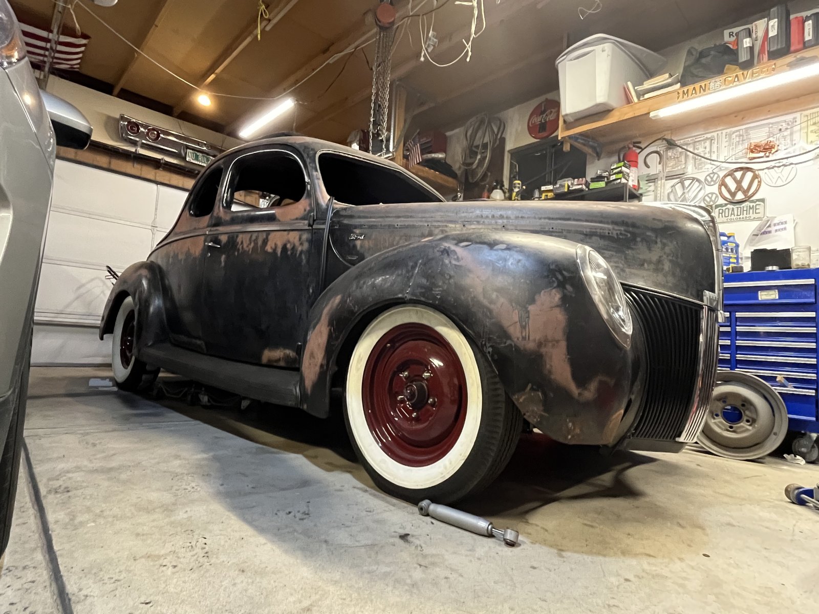

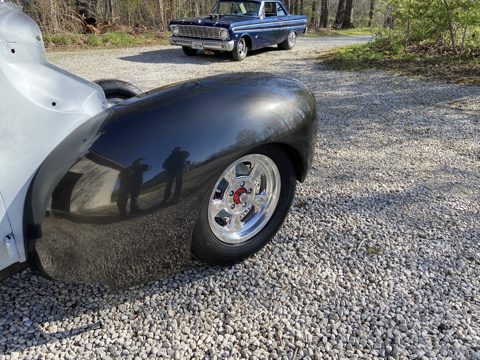

    Going with a 1/2 wider wheel with the added width to the inside will make the tread go away from the fender if you have the room inside .going with a narrower wheel will make the sidewalls fatter but wont move the tread away from the fender unless you change the offset in my opinion, I have 15 165's on my 40 I can drive in a circle with the wheels cut without rubbing on flat ground but they are so close if you touch the brakes at all they rub 20240312_205327[1].jpg

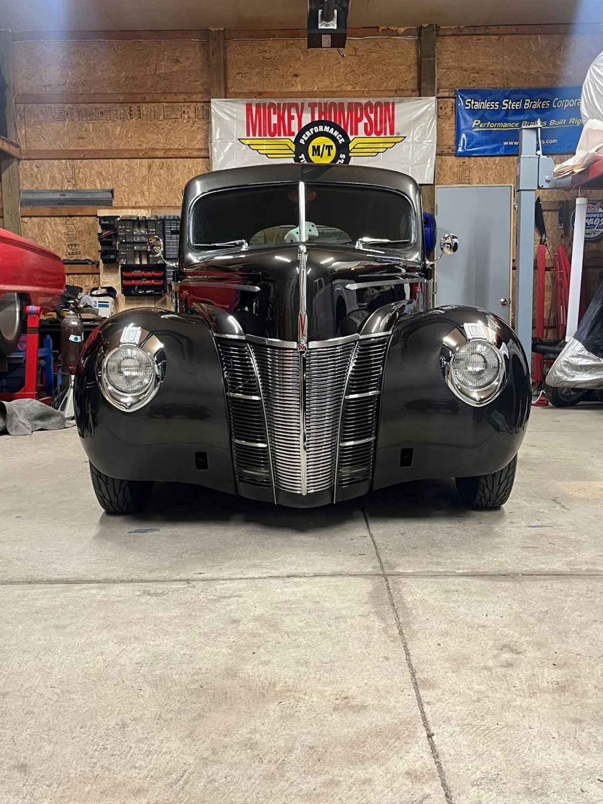

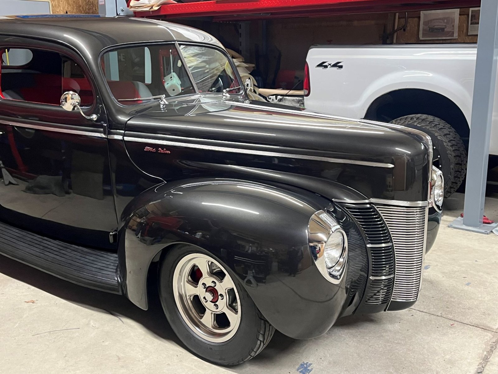

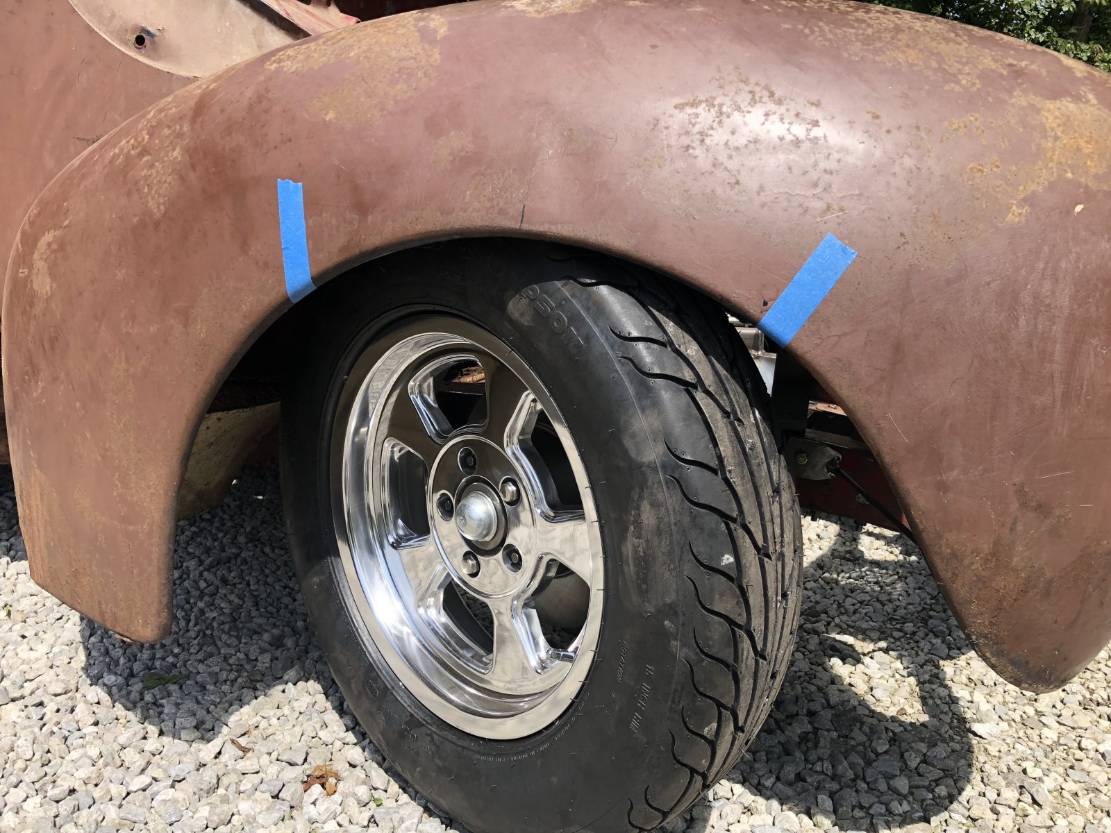

    *Warning* - some may cringe! This is not something I would do on a "finished" car, but I used a port-a-power between the frame and fender lip to m***age the area between the blue tape. Obviously make sure the fender is completely bolted in. Once it provided enough clearance, I rolled the lip with a 1/4 rod welded in to maintain the shape and provide support. The tires are 26" tall and 6.25" inches wide on a 4" rim. For reference, the bottom of the grill is 5" off the ground at ride height. It does not rub at full lock and it was not moved enough to notice. (BTW - it looks like you have the same crack in the wheel opening as I had when I started)

    Too low? Jason, you done it right. Stance is RIGHT ON! Case closed. Everyone else. Get lost.

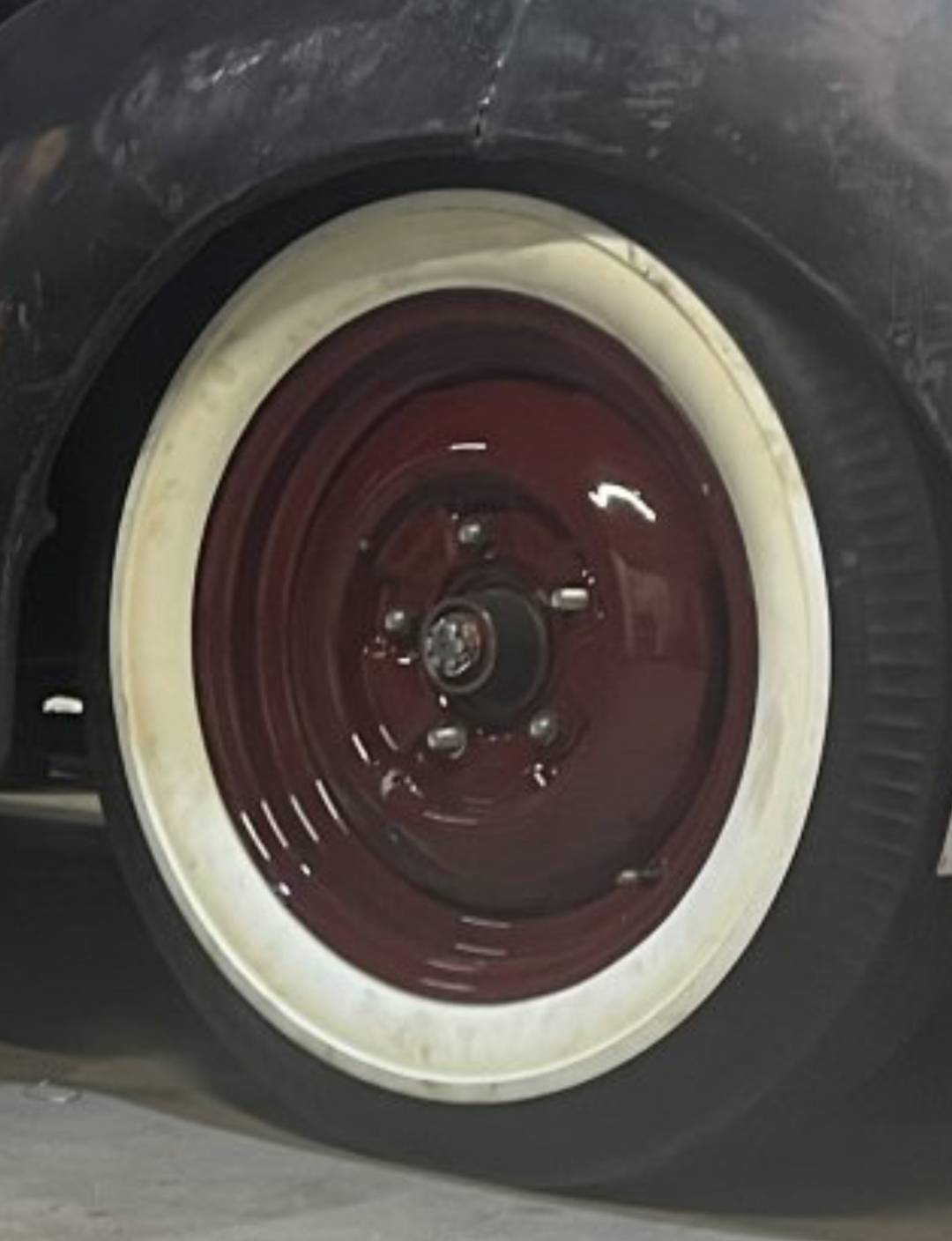

    6D831262-6E52-4D94-B517-223E8A2A6891.jpeg Yeah it looks good. 5” chin clearance is kind of crazy! I think mines about 8”.
    Anyway, I put a 3/8” spacer in the front spring last night. Driver side rubs ever so slightly but it might be workable. p***enger side doesn’t really rub now. It’s very close but no rubbing. Being a patina car, I think the driver side fender has some damage pushing it in ever so slightly making me lose 1/4-1/2” of clearance which in this case is a lot. I have smaller tires on the way and am painting two more rims so I can swap in and out and try various combinations. It’s close. May try and go for that drive around the block this weekend.
    looks the same so that’s good. No loss in cool yet though I fear smaller tires will look funny, we’ll see.

    as per BFX above,...I used a bumper jack and a block of wood to push my fenders out a bit for clearance issues, worked great.
    ...hey, whatever works....if you're only needing 1/4 - 1/2 inch, this mite do the trick.

    There is a support strut that goes between the lower front edge of the fender and the frame. If you disconnect it, then pooch the fender out where you need it then reattach and or modify the strut, the fender will stay pooched out and give you the 1/2 inch you are looking for.
    Or, you can swap in a narrower I beam and spring which would kind of **** on a "finished" car.
    Good luck, -Abone.

    I'd try to message the left front wheel opening slightly.
    Turn the steering wheel. Roll a piece of pipe or tubing between tire and wheel opening at the tight spot?

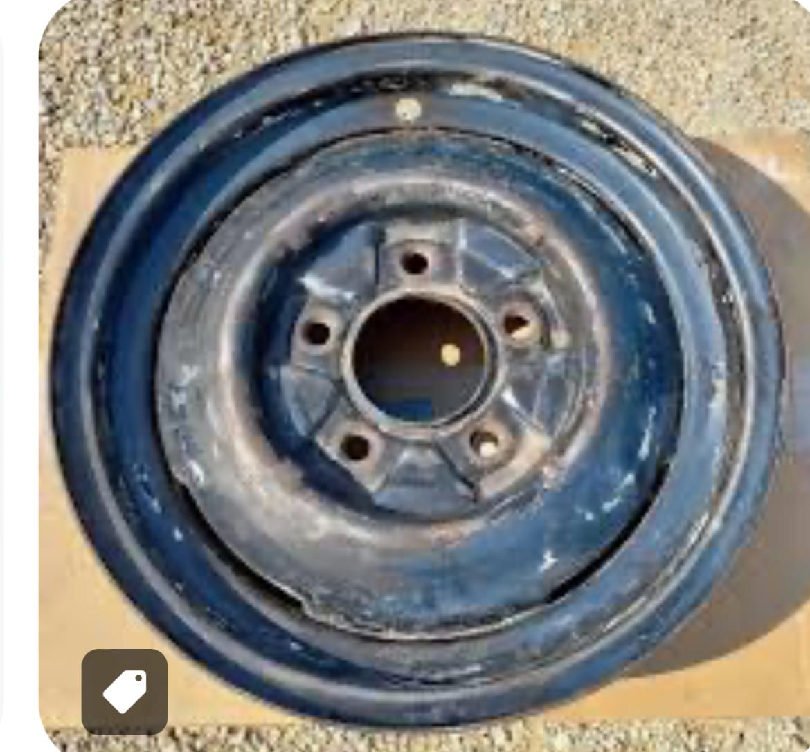

    Looks like a reversed wheel?
  27. I kinda thought that at first.
  28. Busmania
    Joined: Oct 16, 2022
    Posts: 188
    Busmania
    from Denver
    What’s a reverse wheel (newb here)? I now own 6 ford wheels, all are exactly the same. Bought in 3 batches so I think they are probably normal stock wheels.
