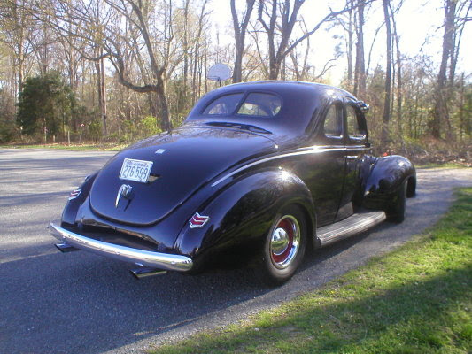

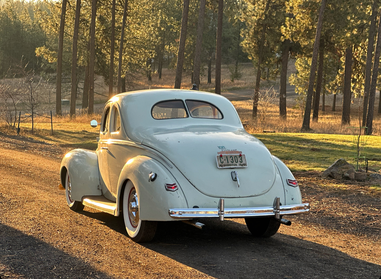

  3. Lots of great examples of '39 and 40's sitting low and right...here's another with the perfect stance and tire/wheel size offset etc... @Chris has it nailed. Perhaps Chris might weigh in on your issue.

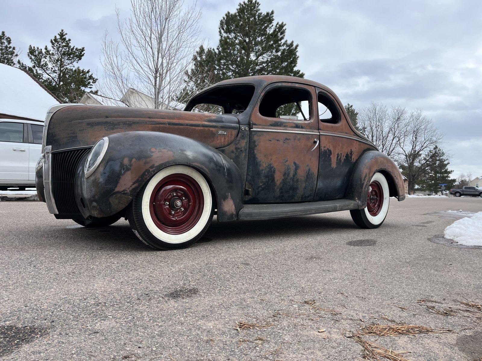

    Got it around the block. First drive in 60ish years. Only heard very minor rubbing when at full wheel turn pulling into the driveway. The 3/8” spacer seems to have done the trick. We’ll see how it does at speed (I’m a ways off from that).

    Don't be surprised if the springs ,both front and rear, settle a minimum of 1/2 in. in the next 500 to 1000 miles. Just sitting doesn't seem to have the effect that spring flexing from driving has. That has been my experience.

    I need the rear to settle at least an inch or I’ll be re working it. If/when the front settles, I’ll compensate and adjust things. I’d prefer limited to no rubbing/s****ing within reason and safeness and not looking like the proportions are off. It’s a balance obviously. I’ll continue to adjust the setup as it gets driven…hopefully within a few months.

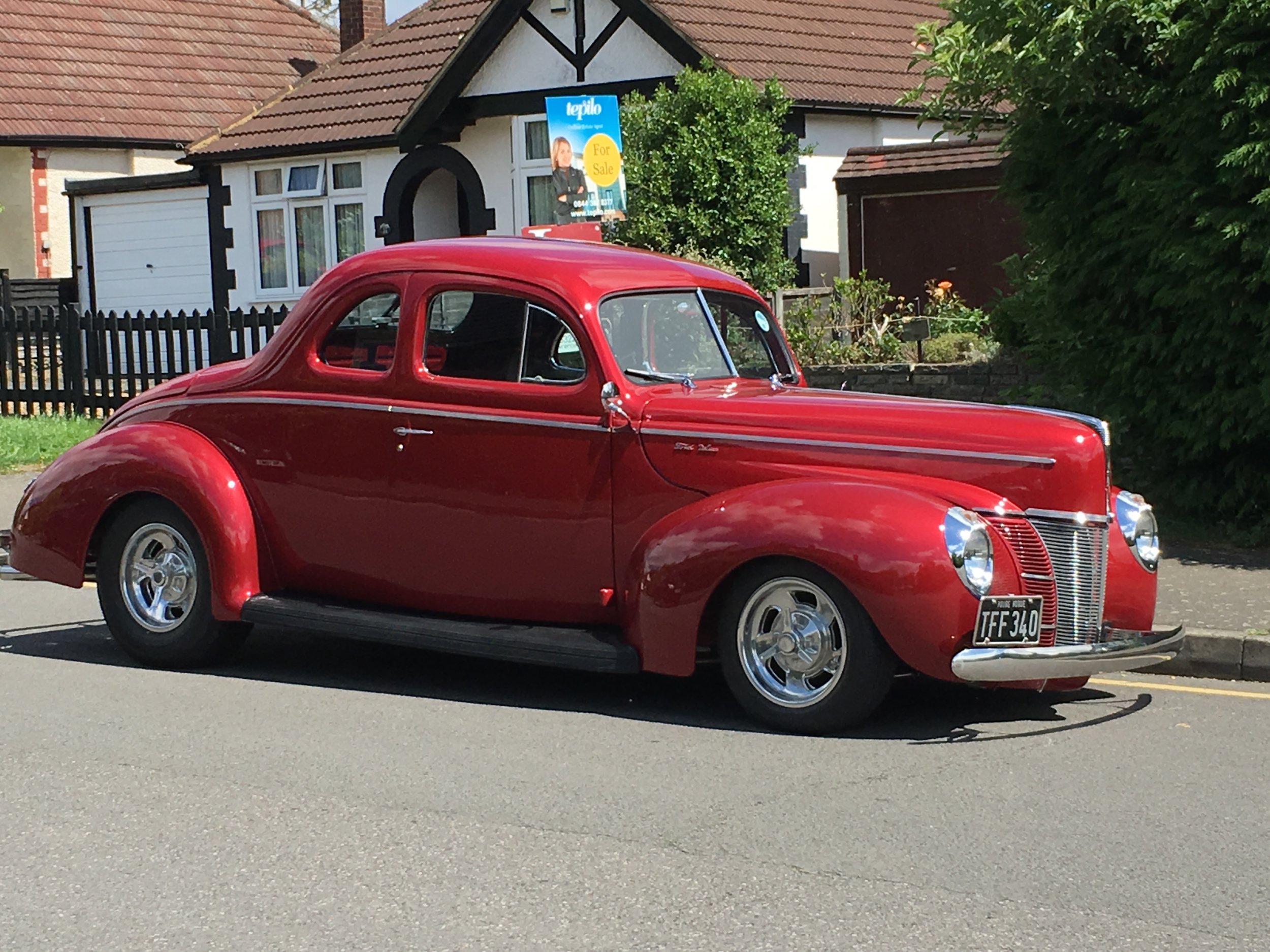

    I love the stance of yours and I understand you wanting to keep it. My old 40 coupe I used a 14” tire 185/75-r14 if memory serves me, dropped 40 axle and a Speedway 4-bar setup, posie’s front rev-eye spring. It was low - out back the tried and true 235/75-r15 w/parallel leaf rear suspension an 2” lowering blocks, Maverick 8, sway bar, hd gas shocks and again low. The front rims had a nice negative offset - the rears 6” with no offset and I played with spacers until I had it right even with a full load - the Mav rear was narrow Man I miss that car …

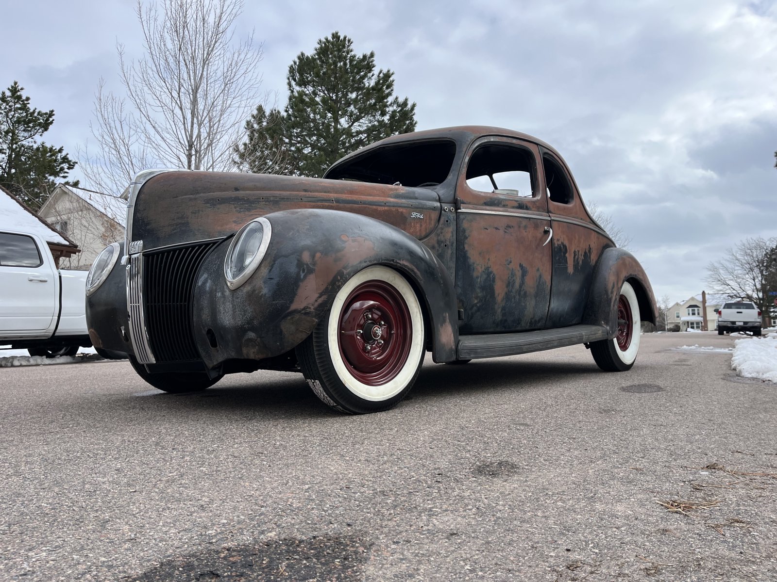

    once I get the rear down where I want it it will be close to this one.

    You've mentioned a few times that the driver's side is lower. This was common on cross leaf (Ford) stuff because of use. Driver gets in and out on just one side, causing it to take a set.
    I'd suggest taking measurements every few inches along both sides and do***ent where the car is sitting. It might help to loosen up the suspension, set it down and bounce it a few times, then tighten. You will probably have to build some of those 2x4 wheel blocks so you can get under with it sitting on the tires.
