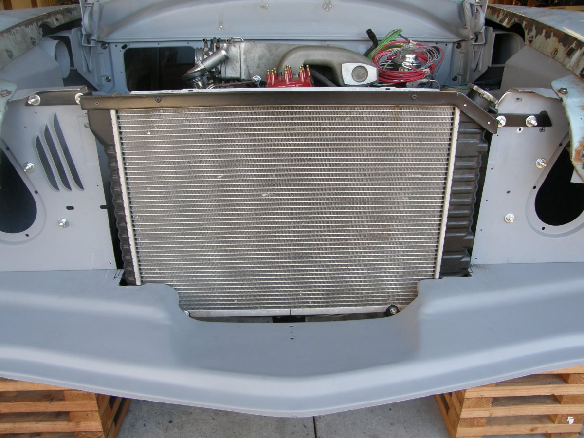

    I really do not like the looks of aluminum radiators but unless I want to spend a ton of money do not have much of a choice. 20210206_085244.jpg

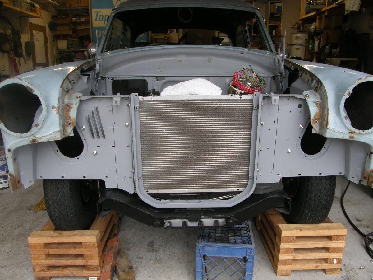

  22. evintho
    Joined: May 28, 2007
    Posts: 2,533
    evintho

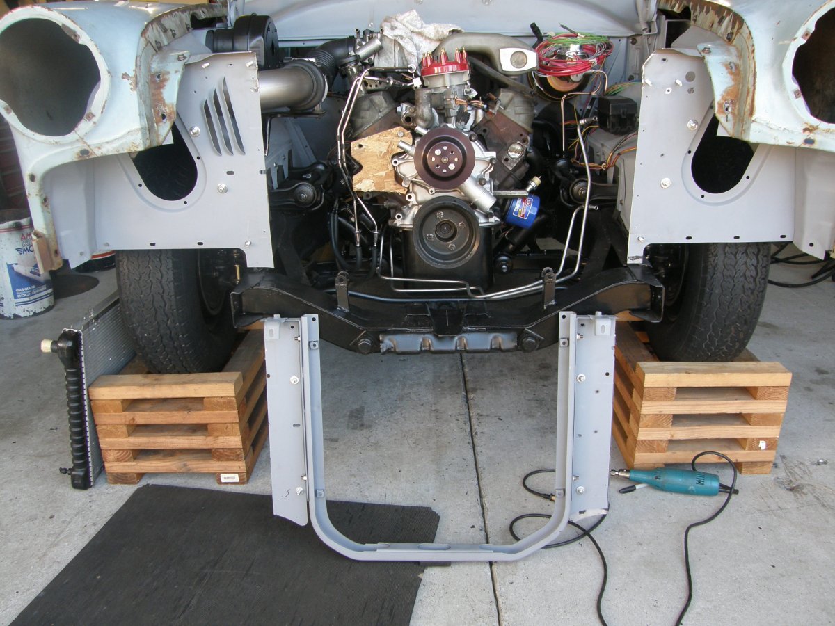

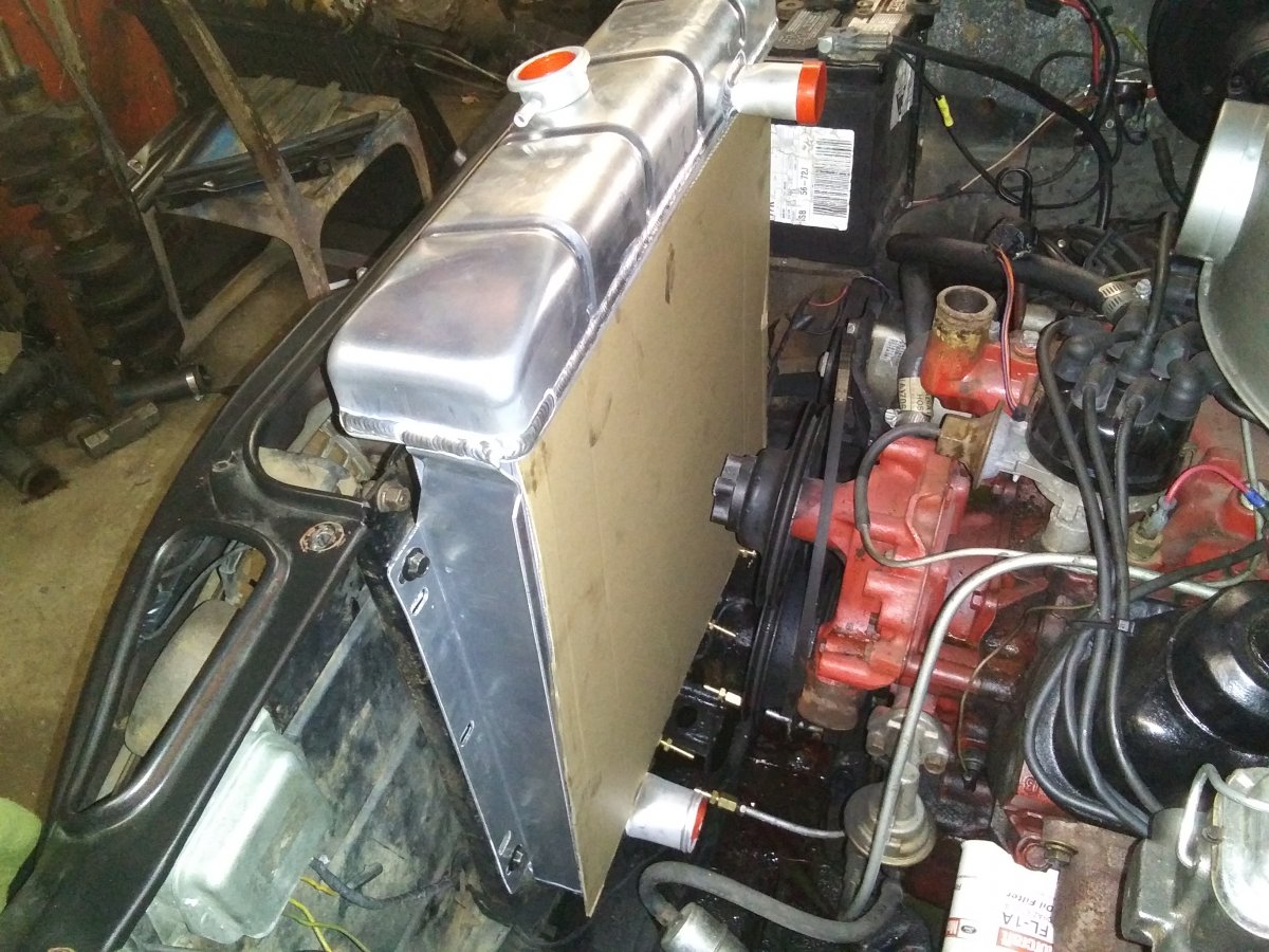

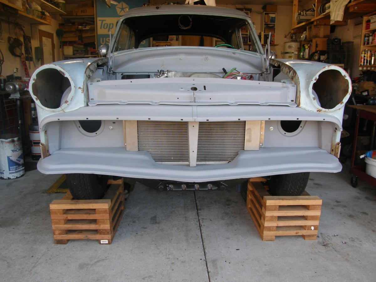

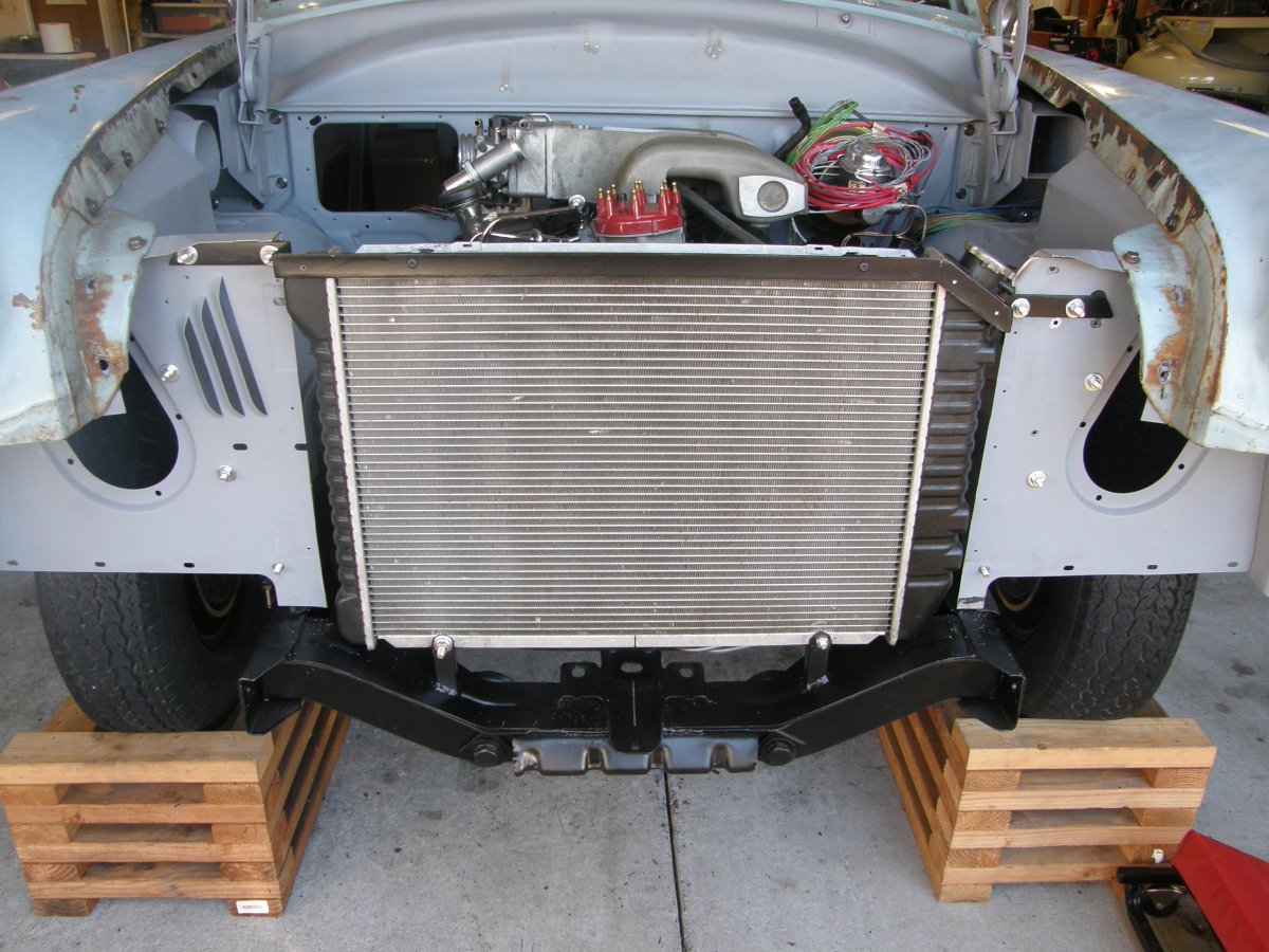

    Here's another option. I have a 5.0/AOD combo in my '54 and I needed fan clearance. I pirated the radiator out of my '93 Mustang donor car. It was a little wide so I bumped it out.
    I cut out the core support plus a couple of inches on each side.....
    Then I fabbed lower brackets and welded them to the crossmember and made an upper bracket out of 1" flat bar that spanned the width and tied both sides together.....
    Had to notch the pan just a bit.....
    Made some sheetmetal covers to hide the tanks......
    The good things are, the factory tranny lines bolt right up as does the upper rad hose. Removed 2" out of the lower hose and it fit. Now, I'm running an electric fan but theoretically, you could bump out the rad another inch or two and you could fit any mechanical fan you wanted in there.
  23. junkman8888
    Joined: Jan 28, 2009
    Posts: 1,067
    junkman8888
    evintho, that is some damned-nice work, thanks for sharing.

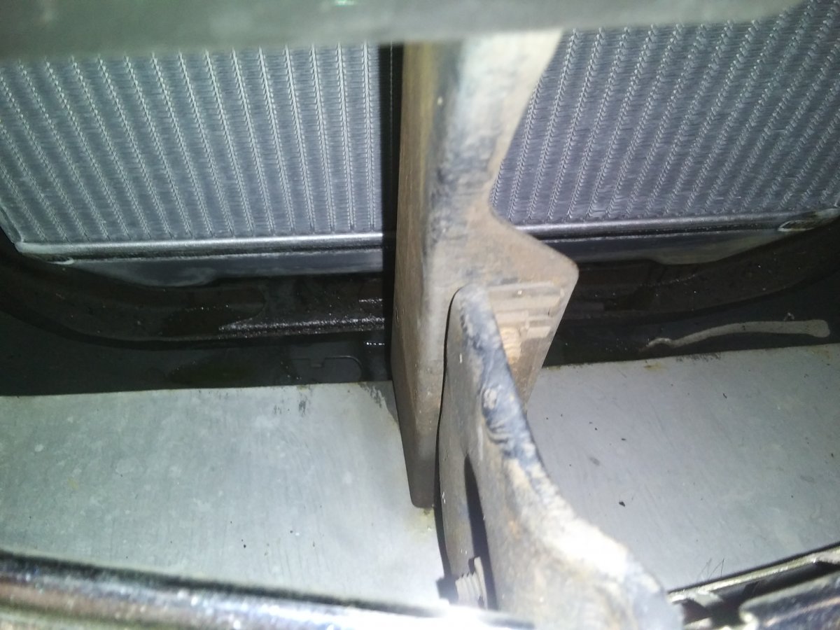

  25. junkyardjeff
    Joined: Jul 23, 2005
    Posts: 8,679
    junkyardjeff

    I feel like this doesn't make sense. The Windsor is a shorter engine than the Y block. I'm pretty sure the Y block is 29" long and the Windsor is a bit shorter. There should be no reason as to why you'd be having this issue. I feel like there is a problem elsewhere manifesting itself with the problem you're having now.
    It looks as though the engine is up too high and at too steep of an angle, which is why the fan destroyed the bottom of your radiator but you have a load of clearance at the top.

  30. You can hide the aluminum radiator by painting it satin black like most cars of that era.
    Getting rid of the silver shine will make it disappear.
