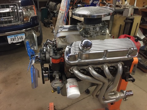

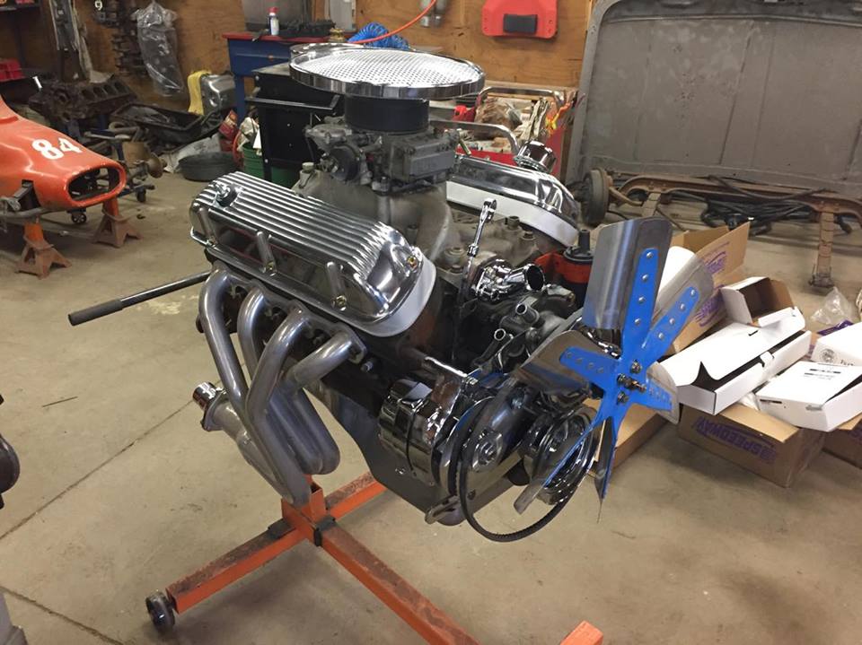

    With this combination, what is your front of pulley to back of block distance?
    I am using a right hand '68 pump on a '71 cover and single groove '66 pulleys on an '88 GT engine and got that distance down to 29". I'm 30-1/4" out to the face of the fan. Would be curious what your combo gives for length.
    I used a Professional Products balancer to get the 3 or 4 bolt pattern on the bottom pulley.

    Pictures to follow but from front of block to front of pulley is about 6 and 3/4 inches. Might be 7" to tip of pump.

    I just checked, mine is 7.5" from face of block to face of pulley or 8" to the extreme tip of the water pump. Yours is a bit tighter. Good job!
