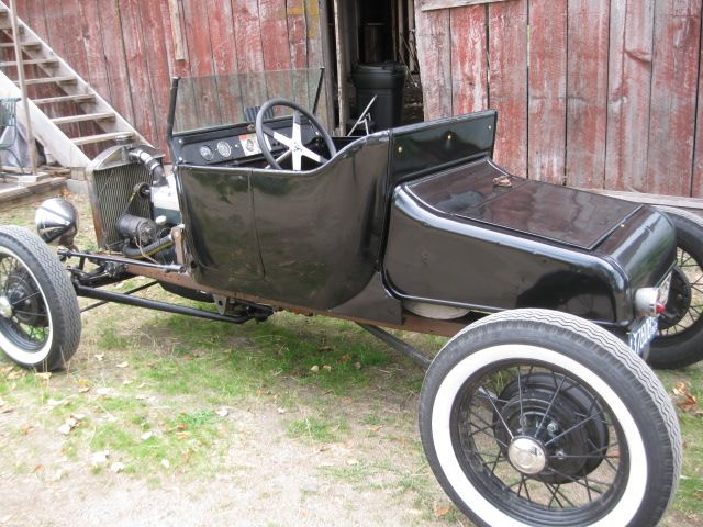

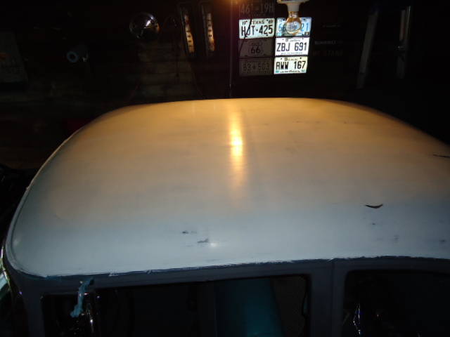

    Here's a couple shots. I tried to show pics that show the worst. There's still dents and scratches in the body. The last coat needed a little more thinner. Rustoleum baby.:D

  9. Wow dude, that looks great! I'm glad that ol car I had went to someone who did something with it :D
  10. -Brent-
    Joined: Nov 20, 2006
    Posts: 7,714
    -Brent-
    Corn Boy! The car looks terrific painted black. Did you use a roller too? How much paint did you go through?

  12. GARY?
    Joined: Aug 15, 2005
    Posts: 1,631
    GARY?
    Hey Fellas, thanks for the compliments!!! I really appreciate them.
    I used one and a half quarts of Rustoleum Gloss black. Nice 15 dollar brushes too.
    For prep I sanded down whatever was on it already with 150 grit and 220. Three coats total. Sanded out the runs and bugs for the first two coats. Third coat is what it is now. I figure it's easy to touch up and it looks kind of old without being "fake".

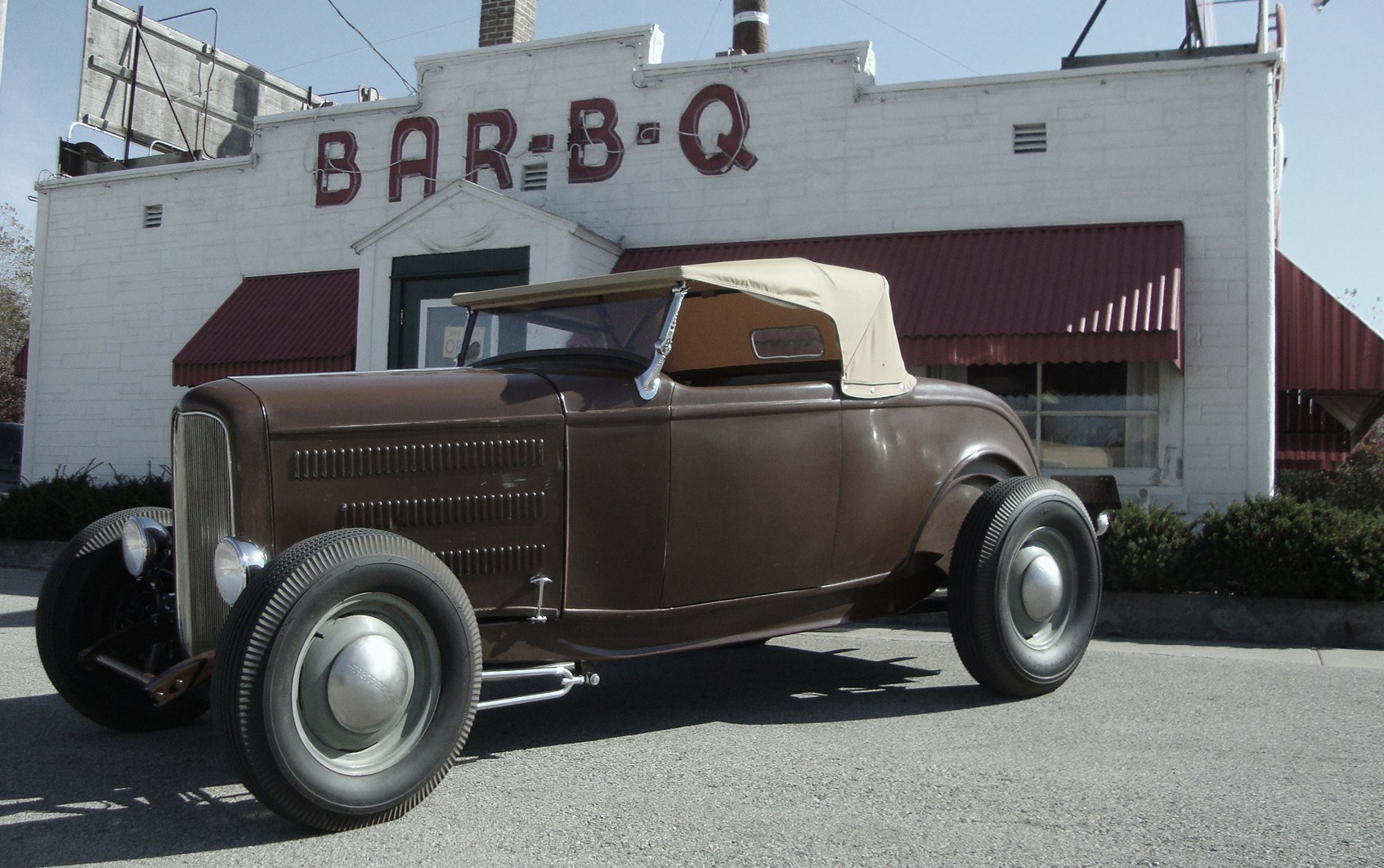

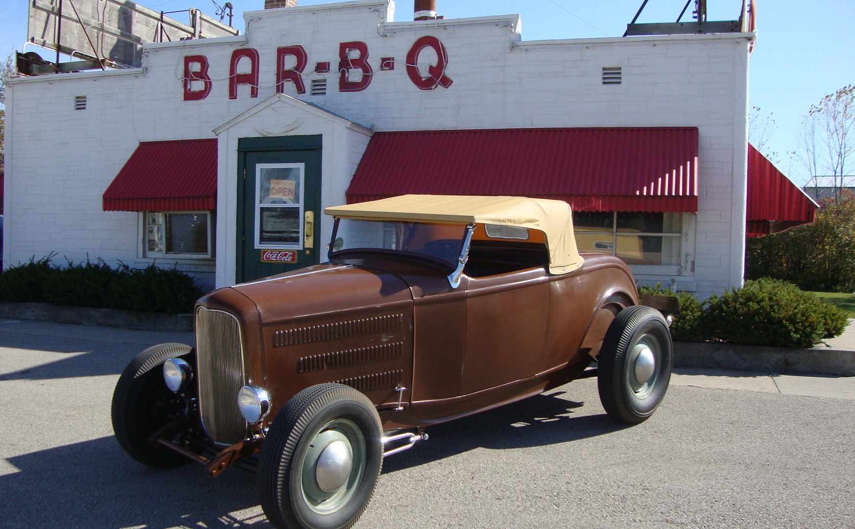

    Heres my 1966 truck
  21. brush painted and sanded
    pecker head likes this.
  22. Jeff Norwell
    Joined: Aug 20, 2003
    Posts: 15,172
    Jeff Norwell
    MODERATOR
    That is a very good looking roadster Kelly... very fine......

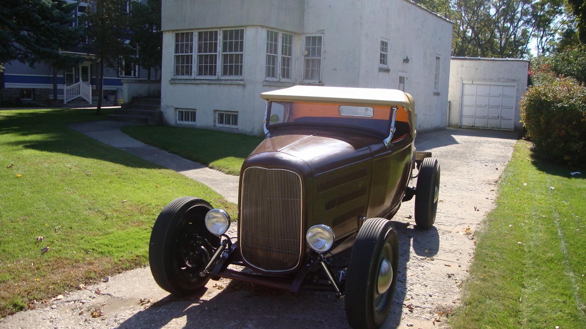

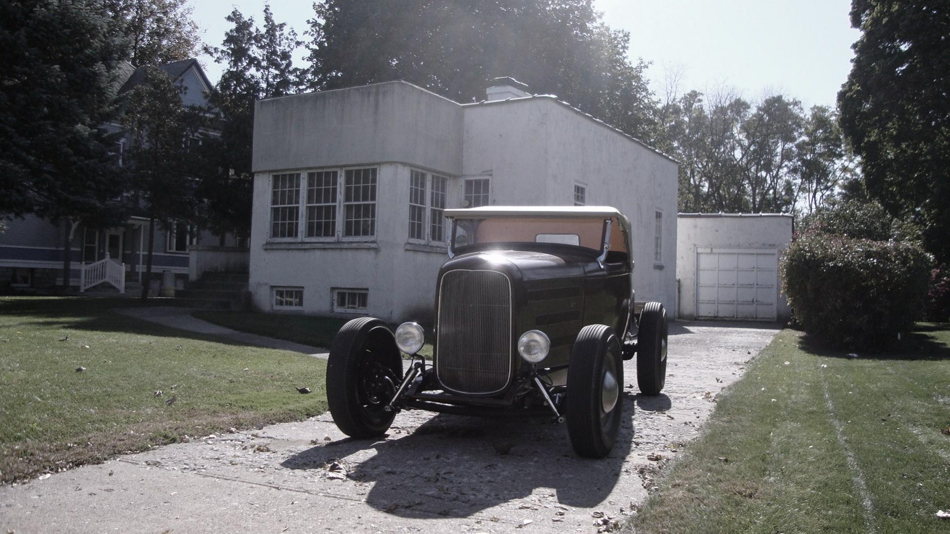

  25. Thanks Jeff, the car photographs very nicely its really hard to take a bad picture of a traditional roadster, brush strokes and all.......

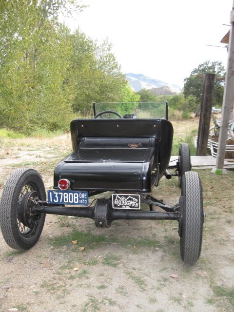

    Probably not what you had in mind but here is mine.

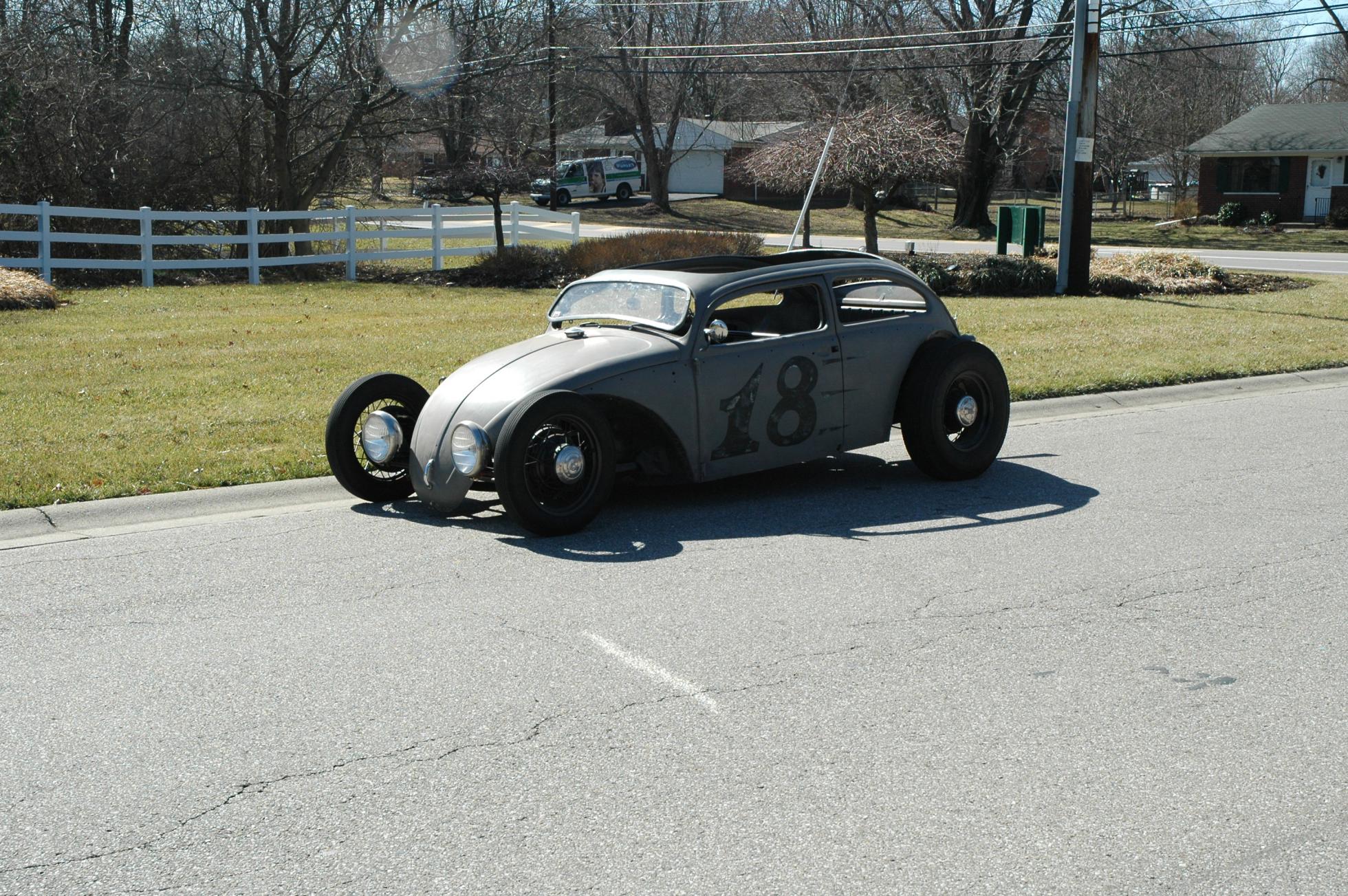

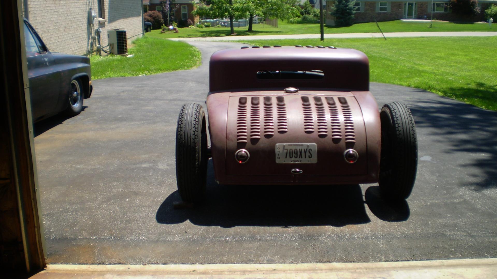

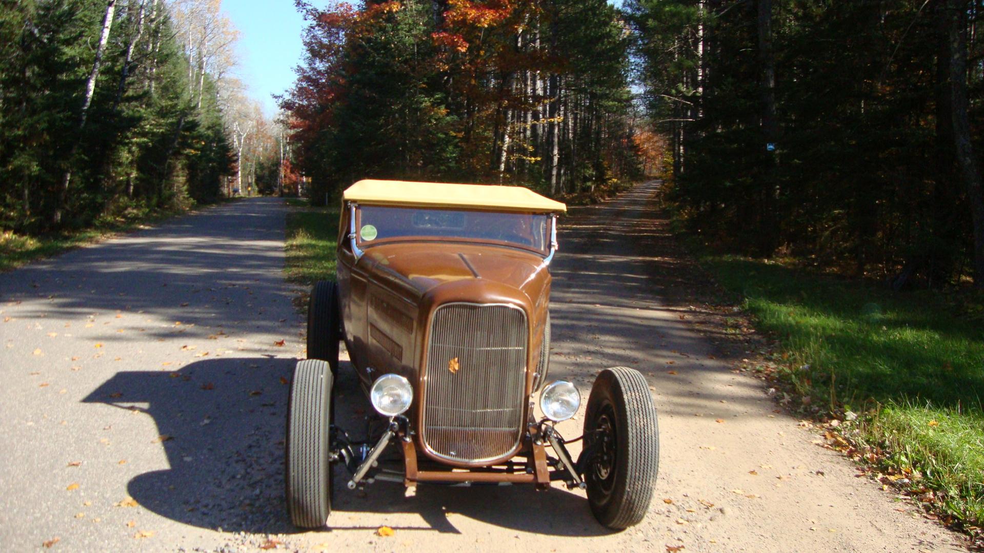

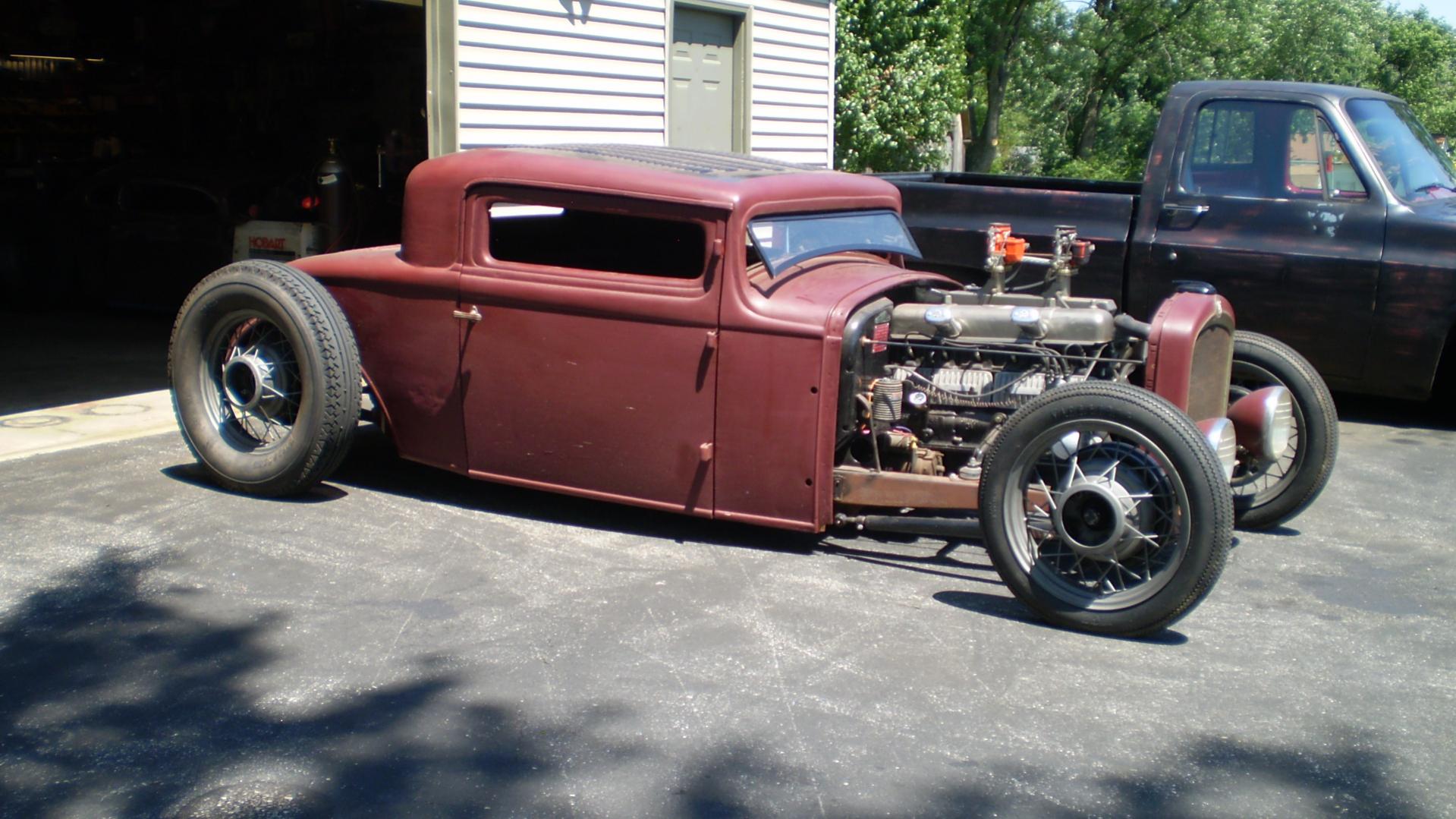

    here are two cars i built that i brushed
