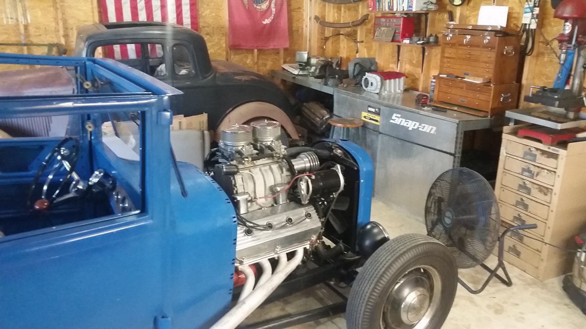

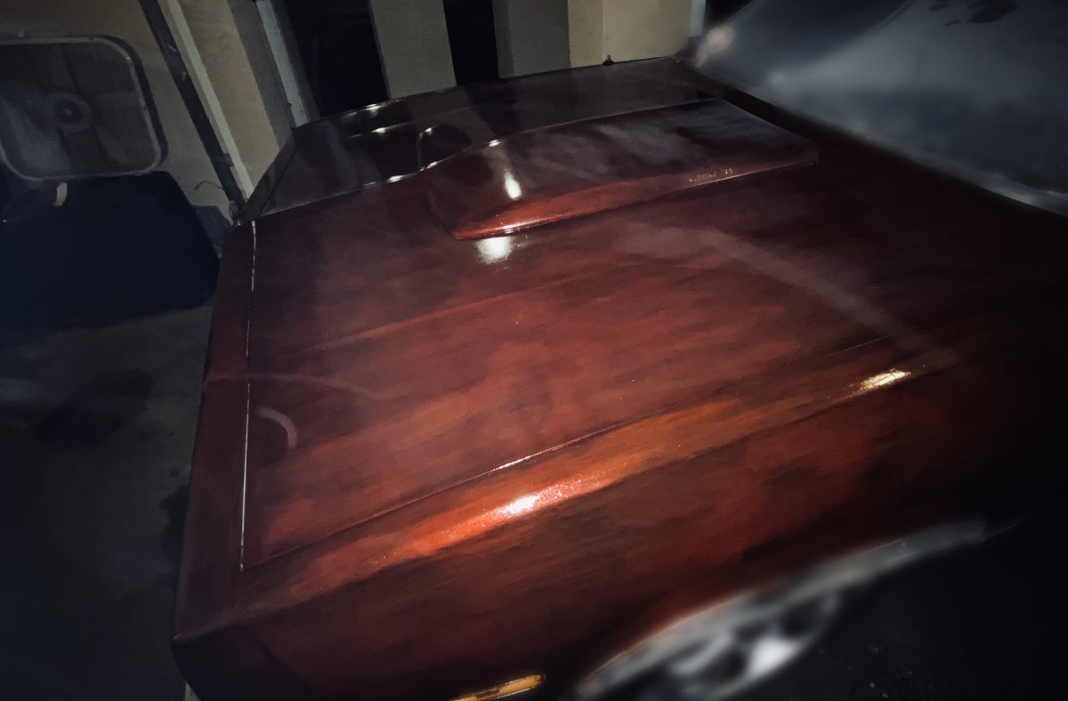

    Mine brush painted with won shot 20191106_070510.jpg 20191106_070510.jpg IMG955930.jpg

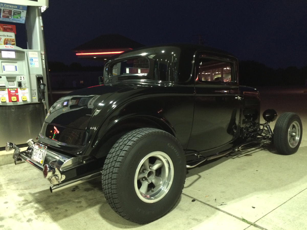

    Hate to discourage anyone, but it’s way easier and probably cheaper to buy a Harbor Freight $9.99 (on sale) purple spray gun instead of buying brushes and lots of foam rollers. If it’s easier for you, do a panel at a time, mask off where needed. You will save hours and hours (blocking) sanding out (between coats) some minor orange peel from spraying verses sanding out the roller or brush lumps and use less sandpaper to boot. The only advantage a brush/roller job has is zero overspray, if you do it inside! I started out rolling my 3W in my shop, and ended up spraying the rest outside. Blocking and cutting and polishing......the results end up exactly the same! Paint pros probably puke when looking at my paint job....average Joe hot rod guys are amazed, or at least say so! Doing it outside involves waiting for good painting days....proper temperature range, low wind and humidity and minimum bugs. It’s fun to point out on the trunk lid the spot where a yellow jacket was swimming in the wet paint....I plucked him out with a pair of tweezers I had in my watch pocket, and quickly dabbed some extra paint there with a artist brush. The extra dabbed paint there helped when I blocked out the lid.....still shows, but not too bad!
    The bottom line is “$200.00 PAINT JOBS RULE”! E17376ED-CB07-4508-937A-ECFD293C2653.png

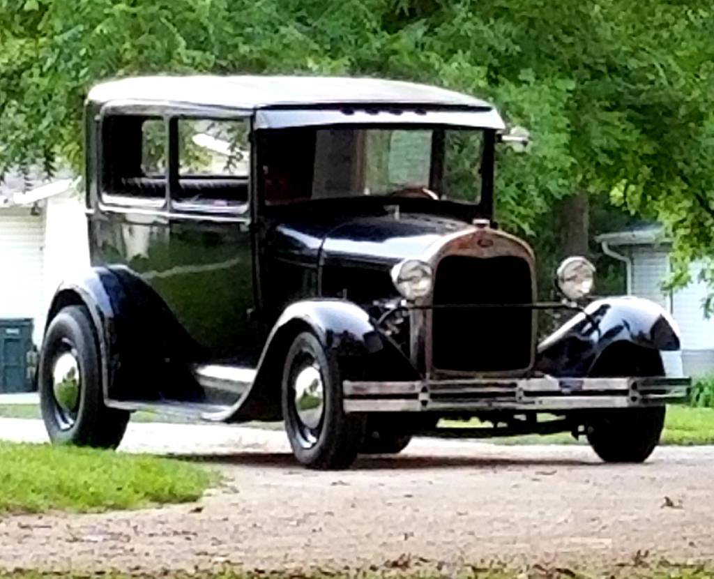

    Brush painted sometime in the past. After a good cleaning and a 10 hour stint of buffing, it really shines up. All my friends thought I repainted it when seeing me cruising around.
    I brushed the roof to match.
    Funny thing is I love the look, and I'm a body man. I could paint it anytime I want, but it's too cool as is. Shiny.jpeg

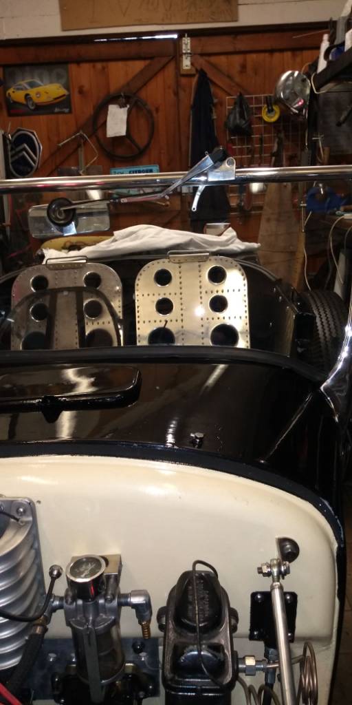

    Your suggestion and results are commendable...but in Hotrod we do shit not neccesarily to save money but just to do as it was done as Henry's team did in 1920 something and many Hoodlum years later...Brush...I agree foam rollers aren't brushes but many of these Hambers achieved credible results and are rightfully proud.
    I could have bought a replica cardboard glovebox for the Ole Jalopy but I made it out of Aluminum by hand but saving grief, money and visual quality weren't the reasons I did it.

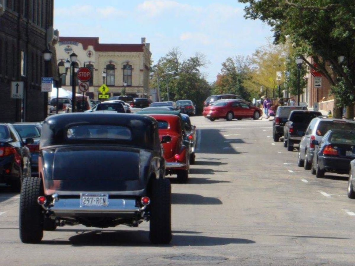

    E1226456-86C3-40A5-92E2-F581E4FD3370.png Pretty sure a lot of hot rods were spray painted back in the day.
    My contention was that it is way easier and faster to spray than to brush or roll. The rougher surface you get from brushing or rolling can be smoothed out, but it takes a bunch of time and effort to do it. The end results of a do it yourself paint job, no matter what method is used are very satisfying. Like I said, the only upside to a brush or roll job is there is no overspray. The downside to a brush or roll job would be the extra sanding effort, the extra paint needed (sanded off) and the extra sandpaper needed.
    Another good thing about a do it yourself paint job beside the $ savings, is your Hot Rod does not have to spend any time in “PAINT JOB JAIL”!
    I drove my coupe all summer while I worked on a panel at a time! Before I assembled the coupe, I painted the bottom of the body, the firewall and the grill shell.....the rest was painted as I drove it.

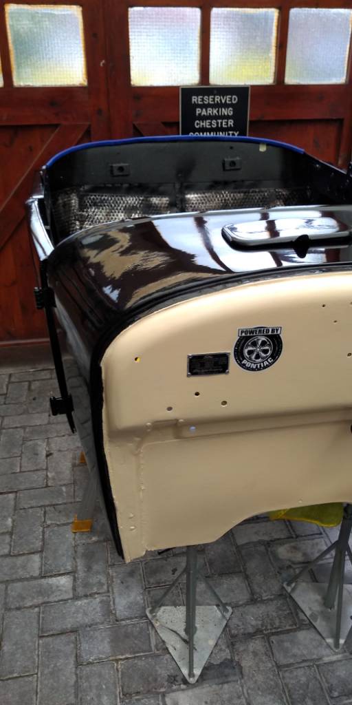

    Brush painted with enamel farm implement paint and hardener added. I might have $100 in the paint job!

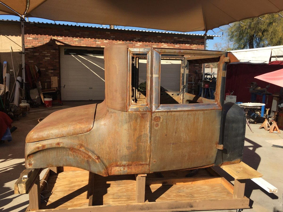

    needs something.... dge cpe.jpg shortened 7 inches
