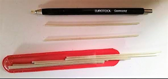

    Hello,
    This product has many names and uses. KTI (KTI-70550) Sanding Pen,
    Scratch Brush, Fibergl*** (Colors may vary)EuroTool
    This is the last unit that I have. It works the best with minimal shredding, but I still use it with a face mask and goggles, when I have to use it. Now, on stainless/fibergl***, there is a liquid that works just as well. (Spotless Stainless)
    I have used it in taking off rust spots on chrome/stainless steel with minimal scratching. But, I have noticed that if used outside on a windy day or inside with a fan blowing, you have to be careful as tiny microscopic shreds fly all over the place. This is fibergl*** and as you use the product to take off rust on chrome or stainless steel, it gets all over. It is especially dangerous to the eyes.
    If anyone has sanded "set up" fibergl*** cloth/resin on any product, flying shreds go all over the place, including on you. It is one itchy situation. Also, if you don't use a face mask respirator, you are inhaling this fine dust with bad things happening as a result. In the early days of surfboard manufacturing and repair, dust was flying all over the place and no one used dust masks. One of our best friends, a surfboard shaper/gl***er/manufacturer died as a result of years of shaping, fibergl*** cloth work, sanding and glossing on a ton of surfboards. That was not good.
    Jnaki
    If the area is in need of fine sanding or pin point sanding, this product would probably work, but the "other" result is not the best for your health. In sanding small 1/64 cars and trucks to prep them for the multiple coats of paint, a better sanding solution would be the fine wet dry paper glued onto a small flat curved metal s****.
    The small s**** has a point to get into the smallest places and along those built in side chrome strips and ridges on hoods and trunk lids. The glued on, fine sand paper on the slight curved surfaces of the s**** gets you to that spot(s) where your finger pressure sands too much of the surrounding area. I used some old baby metal s****s that were the perfect size and shape to get to those places next to the raised ridges without damaging the raised portions.
    The small rod fibergl*** product works, but much care needs to be taken to keep you safe. If the flying fibergl*** gets on your bare skin, it obviously itches. If it gets in your eyes, you need help from a doctor.
