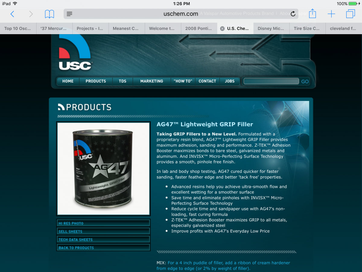

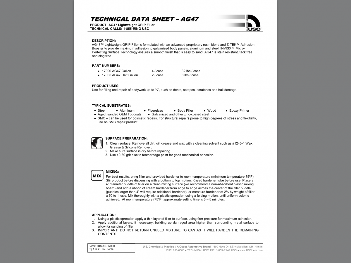

    Sounds like a bunch of you need to try Evercoat's Rage Ultra. Doesn't get harder over time so every coat sands the same whether you put it on today or last week, flows out and glosses over like a putty, sands super easy and comes in two different speeds so if it's super hot out or you are trying to do a larger area you can slow it down with out under catalyzing it.
  6. So how does the speed change- different hardeners or different product?
    USC is sorta local to me. A good friend of mine does some inside contract maintenance work at the plant. His contact person at the plant told him about this stuff and gave him a gallon to try. He In turn told me and so forth. Even though it's local and manufactured, mixed and canned just a few miles from me, no one caries it and I have to special order it in. I pay 26.50 a gallon if I buy a case.
    I did a side by side comparison to the Rage Ultra ($60.00) and I like this AG47 ($26.50) and I like the USC product better.
    http://uschem.com/products/docs/TDS_AG47_4-24-141.pdf
