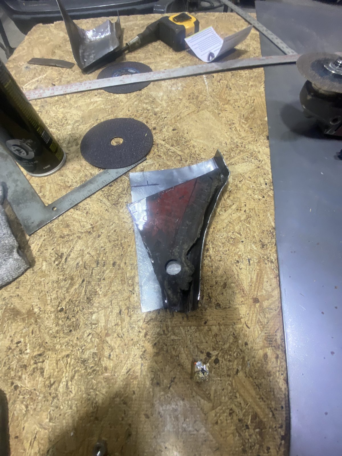

  26. I don’t know if you’ve ever “flow formed” a piece with an air hammer but it’s very easy, very fast, very smooth, and very nice. Did I mention fast?
    On my coupe project I went over doing it for the quarter windows and other pieces. You get quite a bit of time wrapped up in making the forms and just minutes into making metal pieces. Some where in there is a point where it’s a wash on time spent or maybe there’s a point of diminishing returns and it actually takes longer, but on piece number 2 you win if the form can take the beating or it’s just a great win win situation on first piece.
